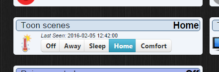

I have Toon 'scenes' working using the 4 dummy switches and was looking how to get this working using a 'selector' switch. Has anyone got this working yet? Perhaps using this latest script with uservariable it is even easier?
kurniawan77
Posts: 46
Joined: Wednesday 21 January 2015 20:23
Re: Toon Energy Readings on Domoticz
Post by kurniawan77 »
wssmith wrote:I have Toon 'scenes' working using the 4 dummy switches and was looking how to get this working using a 'selector' switch. Has anyone got this working yet? Perhaps using this latest script with uservariable it is even easier?
Yep
Toon selector
Toon selector
wssmith
Joined: Wednesday 30 December 2015 19:24
Post by wssmith »
kurniawan77 wrote:Yep
Cool! Care to explain how you did it? Does it just read the 'scene' when set on Toon itself or can it also be used to set the 'scene'?
Still struggling with my first selector switch to run ventilation 10 or 30 min. Not perfect yet, so not really attempted Toon selector yet.
kurniawan77
Posts: 46
The selectors gets updated by the Toon's setpoint (this also can be done by Toon2Domoticz) through lua script.
if (ThermostatSetPoint == TemperatureHome) then
        --print("SetPoint equals Home temperature");
		if (otherdevices['Toon scenes'] ~= 'Home') then
		print("Updating Toon scenes selector to Home")
		commandArray['UpdateDevice']='idx|nValue|sValue'
return commandArray
--  nValue = 1 = on; sValue = Level (0,10,20,30...)
This way it doesn't execute the on action behind the switch. It does when you click on the switch!

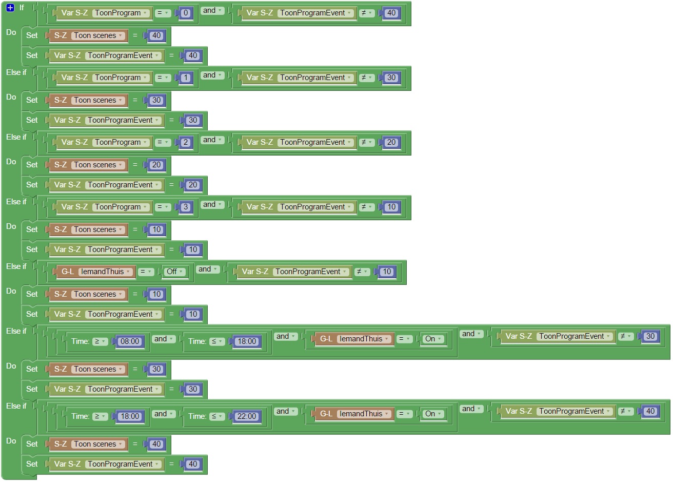

I have used the script of MatthijsPH and it's working perfectly. I also made a selector switch with the json url's to control the Toon scenes. Now i want to control the Toon by using the below event. For the event i made an extra variable "ToonProgramEvent" to make sure the event isn't running continuously.
The problem is, the event script isn't updating the selector switch. Does anaybody know how to control the selector switch from the event? Do i need to use the level number of the selector switch or the name?

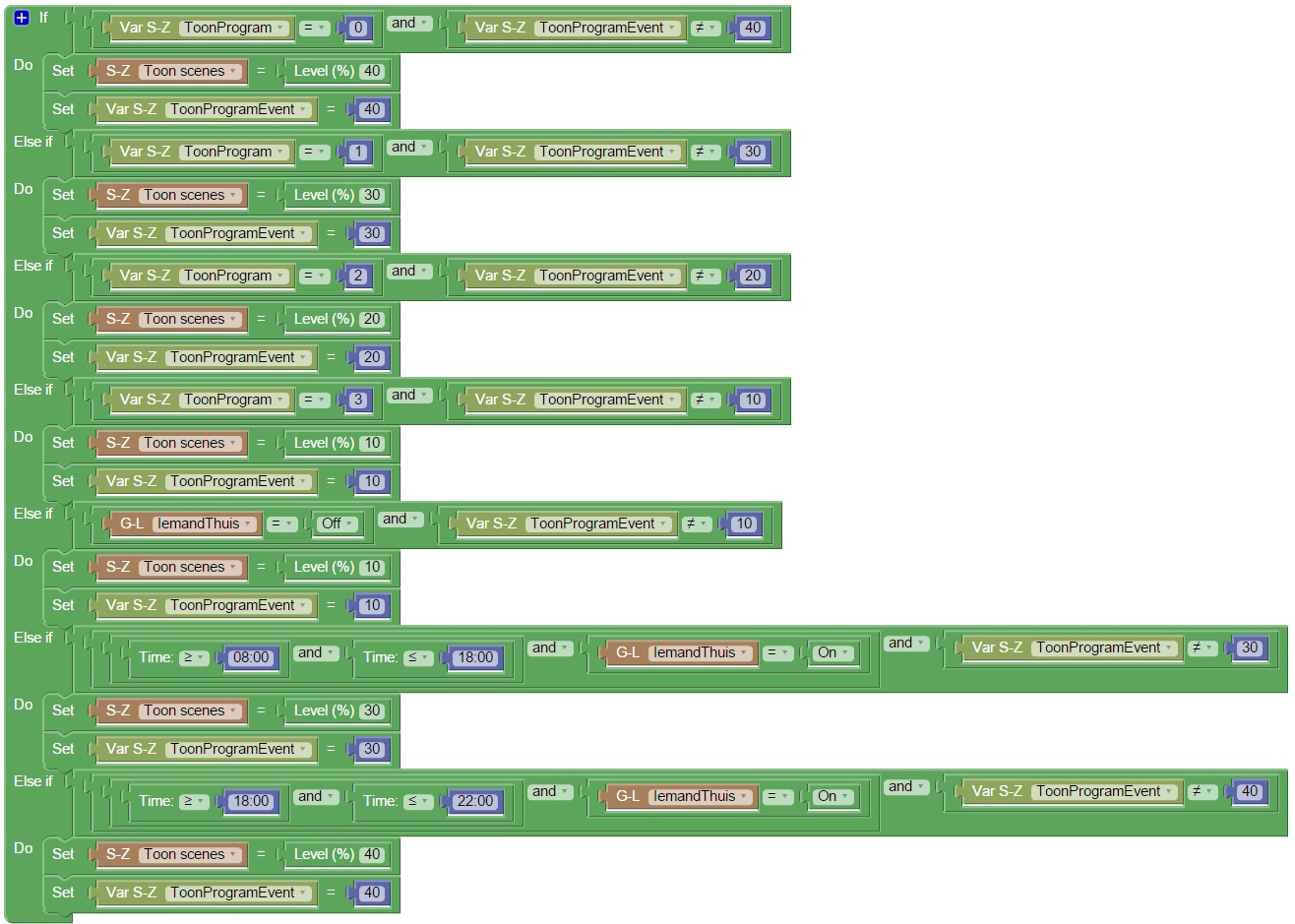

Already got it working :D to set the level of a selector switch you need to use "Level % ..".

MatthijsPH wrote:
gielie wrote:
kurniawan77 wrote:
Go to settings --> hardware
In the drop-down menu choose "Dummy (Does nothing, use for virtual switches only)" and name it any way you like (if you haven't already created dummy hardware).
You should now see your dummy hardware in de list above.
Click "create virtual sensor" and then pick "selector switch" at the bottom. Name it anyway you like, for instance ToonScenes.
You can find the new selector switch on the switches tab. Here you can edit the switch to meet your demands.
Ok, i got the selector, i put the 4 setpoints in there with their corresponding scripts to put them on.
I have the Toon setpoint named "Room Setpoint", so i renamed this in your script, i named the room temp "Huiskamer", so i changed this also in the script. So my script looks like this now.
if (Room Setpoint == Huiskamer) then
return commandArray
Its not working, what is wrong?
