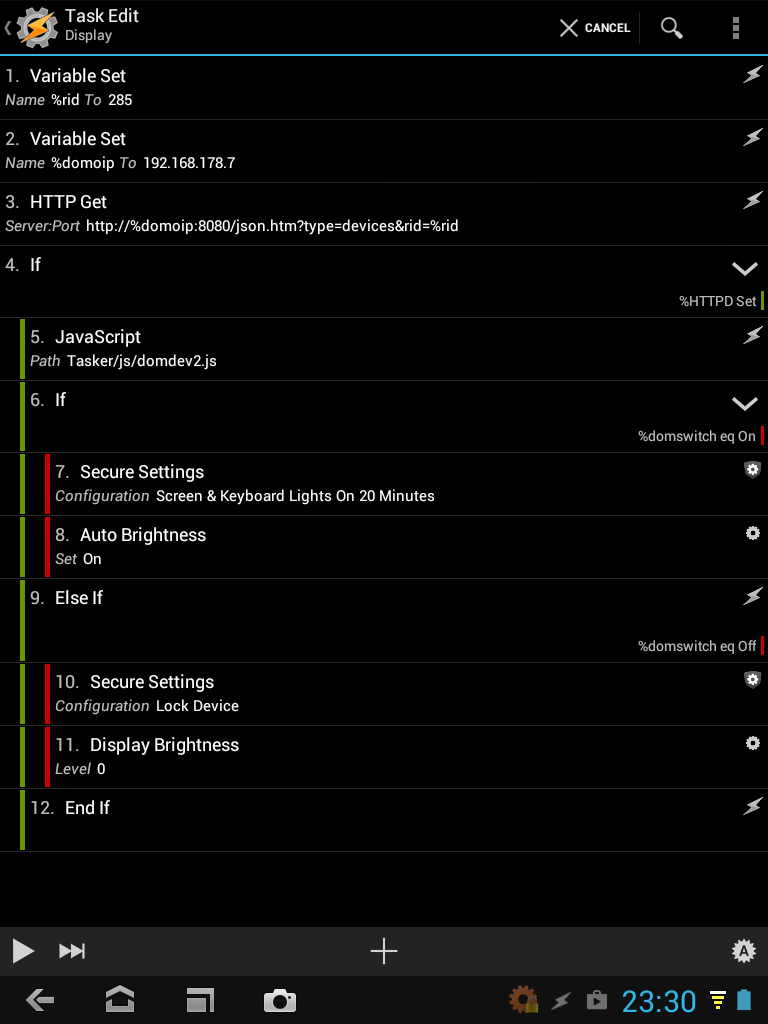

One question, where does the "%domswitch" points to? It looks like a variable or parameter but where is it set?
Re: Turn screen Android tablet off when sleep/not home
Posted: Monday 22 June 2015 23:42
by G3rard
You have to add the following to domdev2.js.
var domswitch=arr.result[0].Data;

G3rard wrote:You have to add the following to domdev2.js.
This line isn't in the instruction described before....
Is it correct that the domdev2.js file is in "/mnt/sdcard/Tasker/js/" folder?
Posted: Wednesday 24 June 2015 23:57
by G3rard
It is not in the instruction indeed, but without it domswitch is not defined.
I got it running with this addition.
I placed the js file in a folder on the Nexus and then used the browser (magnifying glass) of Tasker to point to that file.

G3rard wrote:It is not in the instruction indeed, but without it domswitch is not defined.
I did that already and double checked it but still the screen goes off.

So i think the domswitch needs to use the "status" and not the "data" field, otherwise the %domswitch does not equals On because it is "On, Level: 100 %", or am I incorrect here? . But when I change in domdev2.js the
To
var domswitch=arr.result[0].Status;
it still doesnt work..

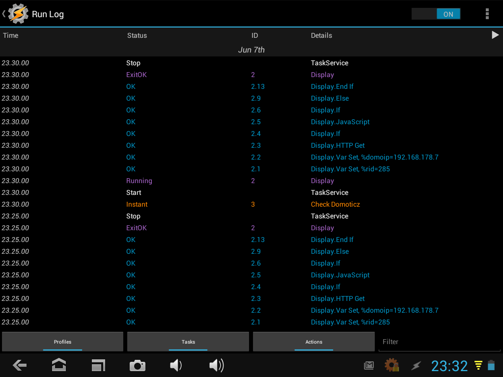

The log of the tasker shows also no errors (see my screenshot above).

What happens if you run the task in Tasker with the play button?
