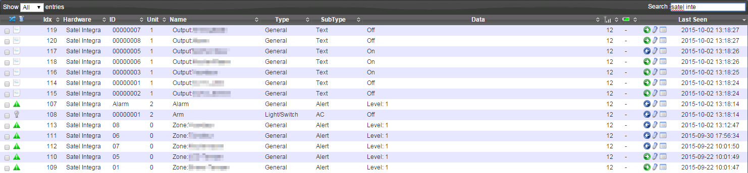

Hmmm, I think that understand what you say, but this functionality exists in module Satel for domoticz now.
For this moment module can :
1) add to domoticz zones with name from Integra - alert type
2) add to domoticz outputs with name from Integra - switch type (and text type for not switchable outputs)
3) add to domoticz device "Arm" - switch type
4) add to domoticz device "alarm" - alert type
3) read zones states
4) read output states
5) read alarm state
6) read arm state
7) switch arm/disarm
8) switch outputs to on/off
9) read temperatures from ATD100 (only beta now)
In plans : reading events from Integra
Fantom
5) read alarm state
6) read arm state
