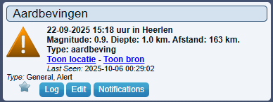

		if (triggeredItem.isTimer) then
			dz.openURL({
			    url = knmiURL,
				method = 'GET',
				callback = 'knmi-rss'
		if (triggeredItem.isHTTPResponse) then
            -- Process the obtained data.
			if (triggeredItem.ok and triggeredItem.isXML) then
			    -- We have something, which looks like this:

                    local alertText = tostring( atLocalTime .. ' uur in ' .. qPlace .. '\n' .. 'Magnitude: ' .. qMag .. '. Diepte: ' .. qDepth .. '. Afstand: ' .. roundedDistance ..' km.\n' .. '<a href="https://maps.google.com/?q=' .. qLat .. ',' .. qLon .. '" target="_blank"><span style="color: ' ..  htmlColor .. '">Toon locatie</span></a>' .. ' - ' .. '<a href="'  .. qUrl ..  '" target="_blank"><span style="color: ' ..  htmlColor .. '">Toon bron</span></a>' )
                    dz.log( 'LastalertText = ' .. lastalertText, dz.LOG_DEBUG )
                    dz.log( 'NewalertText = ' .. alertText, dz.LOG_DEBUG )
                    -- Only update and send mail when info has changed. and
                    if alertText ~= lastalertText then
                        -- We have new information, so update the device.
                        dz.devices(alertIdx).updateAlertSensor( alertLevel, alertText )
                        -- Only send email when it comes closer then dCloser
                        if roundedDistance <= dCloser then
                            --Set and format the new mail message
                            local message = tostring('Plaats: ' .. qPlace .. '<br>' ..
                            'Magnitude: ' .. qMag .. '<br>' ..
                            'Diepte: ' .. qDepth .. '.<br>' ..
                            'Lokale Tijd: ' .. atLocalTime .. ' uur.<br>' ..
                            'UTC Tijd: ' .. atUTCtime .. ' uur.<br>' ..
                            'Afstand: ' .. roundedDistance .. 'km.<br>' ..
                            'Coördinaten: ' .. qLat .. ','.. qLon .. '<br>' ..
                            qAuthor .. '<br>' ..
                            qType .. '<br>' ..
                            '<a href="https://maps.google.com/?q=' .. qLat .. ',' .. qLon .. '">Toon locatie</a>' .. '<br>' ..
                            '<a href="' .. qUrl .. '">Toon bron</a>' .. '<br>' )
                            -- Send the mail
                            dz.email( 'Aardbeving ' .. qPlace, message, mailto, 0 )

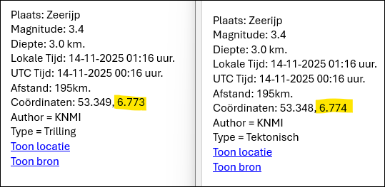

Here is a new Earthquake script with more robust error handling and a new URL.
-- 07-05-2024 script by Jan Peppink, https://ict.peppink.nl
-- Based on earlier script found on https://www.domoticz.com/forum/viewtopic.php?t=41380
-- Missed Dutch earthquakes. Modified script to get info from KNMI Aardbevingen RSS
-- Parse XML result to get info from the most recent of 30 in the list.
-- Modified on 2025-01-21 to use new KNMI API: https://rdsa.knmi.nl/fdsnws/event/1/query
--- Your settings ----------------------------------------------------------------
-- First set the used device index numbers and variables you might want to change.
local alertIdx = 936           -- Aardbevingen Set to the idx of the Virtual Alert sensor you have to create for this script
-- Aardbeving info
local mailto = '[email protected]' -- Set E-mail adres to sent notification to.
local knmiURL = 'https://rdsa.knmi.nl/fdsnws/event/1/query?format=text&minlatitude=50.5&maxlatitude=53.7&minlongitude=3.3&maxlongitude=7.2&limit=5' -- =~ the Netherlands

                    local alertText = tostring(atLocalTime .. ' uur in ' .. qPlace .. '\n' .. 'Magnitude: ' .. string.format("%.1f", tonumber(magnitude)) .. '. Diepte: ' .. qDepth .. ' km. Afstand: ' .. roundedDistance ..' km.\nType: ' .. eventTypeNL .. '\n<a href="https://maps.google.com/?q=' .. qLat .. ',' .. qLon .. '" target="_blank" style="color: blue; text-decoration: underline;">Toon locatie</a>' .. ' - ' .. '<a href="'  .. qUrl ..  '" target="_blank" style="color: blue; text-decoration: underline;">Toon bron</a>')
			            domoticz.log('Nieuwe aardbevingsinformatie, update device', domoticz.LOG_DEBUG)
			            domoticz.devices(alertIdx).updateAlertSensor(alertLevel, alertText)

HvdW wrote: Monday 06 October 2025 0:28 Here is a new Earthquake script with more robust error handling and a new URL.
That is a very short mention.
Can you say something more about it? Give some explanation? Tell what has been adjusted and where? Put that in the comment with your name on it.? What was the reason for a new URL?
I had already changed the URL to use new URL on 31-01-2025. I still use that same URL and had shown the earthquake in Heerlen in the same way.
What is changed now in the URL and why? What is the advantage?

This morning 01:16 earthquake Zeerijp and 6:39 Zeerijp
In the log I don't find the first, just the second.
The script runs once a day 'at sunrise'
Bugs bug me.
janpep
Posts: 288
Joined: Thursday 14 March 2024 10:11
Domoticz version: 2025.1
Re: Earthquake info from KNMI
Post by janpep »
HvdW wrote: Friday 14 November 2025 9:04 The script runs once a day 'at sunrise'
Makes sense if you collect it once a day and request the last one. You ask once, you get once :-)
I have more of the same place.
Note that there are a few differences in magnitude. Changes in what happened at the same time are reflected as differences.
I will have to look at the first one more closely. These seem to be equal. I will check it later.
(BTW, I received mail confirmation or your post just today!)
Dz on Ubuntu VM on DS718+ behind FRITZ!Box.
EvoHome; MELCloud; P1 meter; Z-Stick GEN5; Z-Wave-js-ui; Sonoff USB-Dongle Plus-E; Zigbee2Mqtt; MQTT; Greenwave powernodes 1+6; Fibaro switch, plugs, smoke; FRITZ!DECT 200. Scripts listed in profile interests.
willemd
Posts: 740
Domoticz version: 2024.1
Post by willemd »
janpep wrote: Friday 14 November 2025 9:33 I will have to look at the first one more closely. These seem to be equal. I will check it later.
The second one also looks (almost) double. Although the magnitude is slightly different, they are also exactly 30 minutes apart, like the first one. Maybe you have two different data sources that report 30 minutes apart?
janpep
Posts: 288
Post by janpep »
My script runs every 5 minutes at 2,7,12,17 etc. of the hour.
It only updates the device when there is a difference in the result string. So although small, 2.0 and 2.1 is different.
I did not look at the first two that look to be the same at first glance. But of course an automatic compare in the script never makes a mistake.

And just as I thought. Even a small difference is still a difference.

and also the type is different

willemd wrote: Saturday 15 November 2025 10:00 and also the type is different
That is true, but the type is not part of the string that I show in the alert device, and no part of the string to compare if something has changed.
It's a bit much for me to stipulate that it has to be at least ?? meters from the previous measurement. The same goes for Magnitude and Depth. So I simply check if the string has changed since the previous measurement.
I wanted to prevent getting a notification every 5 minutes when nothing changed. Setting it to one time per day, you may miss a few and get only the last one. Depending on how you look at it, there is something to be said for all the choices.
