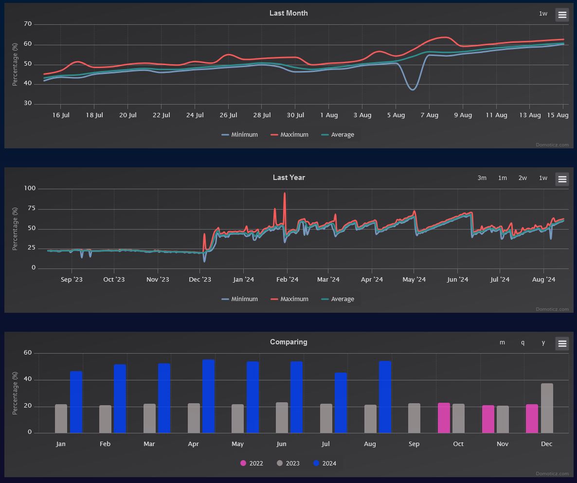

I have 2 systems running, one in my home and a test system at work with not many devices, both display a very similar graph to each other, something defintely changed in Dec 23 as can be seen here and it's never got back to where it was.
2024-08-15 09_30_00-Domoticz.jpg (104.08 KiB) Viewed 675 times

by waltervl
Can you also check the Process usage device? As you are now showing the total memory consumption of your server and some other process could influence this. I once had my file explorer process kill the memory....
