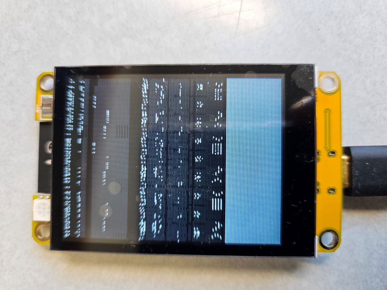

Thanks again! As you said it is compiling now but touch doesn't work. All I can see is "Calibrate screen"

@palnic The field to play are
On the json file and
in the screen_driver.cpp file, sometime we need to reverse TFT_HEIGHT and TFT_WIDTH.
If you can't success, I will try to compile the project that use your device, this action will enable/disable code, so easier to understand the good config in this "multi support" code.
@EdwinK
Take care the last code is still on the branch "test", I haven't updated the master branch yet, need to make some bench to see cpu/memory use with the new code.
"-DTFT_WIDTH=240",
"-DTFT_HEIGHT=320",
"-DTFT_ROTATION=4",Code: Select all
disp_drv.hor_res = TFT_HEIGHT;
disp_drv.ver_res = TFT_WIDTH;If you can't success, I will try to compile the project that use your device, this action will enable/disable code, so easier to understand the good config in this "multi support" code.
@EdwinK

Thanks. Here are my settings:
platformio.ini:
-DTFT_WIDTH=320
-DTFT_HEIGHT=240
-DTFT_ROTATION=2
screen_driver.cpp:
Display looks perfect, but sensing doesn't work
platformio.ini:
-DTFT_WIDTH=320
-DTFT_HEIGHT=240
-DTFT_ROTATION=2
screen_driver.cpp:
Thorgal789
- Posts: 920
- Joined: Wednesday 15 August 2018 14:38
- Target OS: -
Re: New project, a small wall display to control Domoticz using CYD (Cheap ESP32 touchscreen)
You need to reverve the display at 90° no ? Widgets are by defaut more longer than larger.
On the platoformio.ini file
Set it to "true", It's possible the previously memorised don't work with your new setting. This setting will reset the touch calibration at every restart.
(And there is a setting to reverse the touchpad too if neeeded, but harder to see, I can give you a code to see the pointer, easier to see if you need to reverse it too)
It have worked previously ? Yes else you will be blocked at calibration step.but sensing doesn't work
-DFORCECALIBRATE=false (And there is a setting to reverse the touchpad too if neeeded, but harder to see, I can give you a code to see the pointer, easier to see if you need to reverse it too)

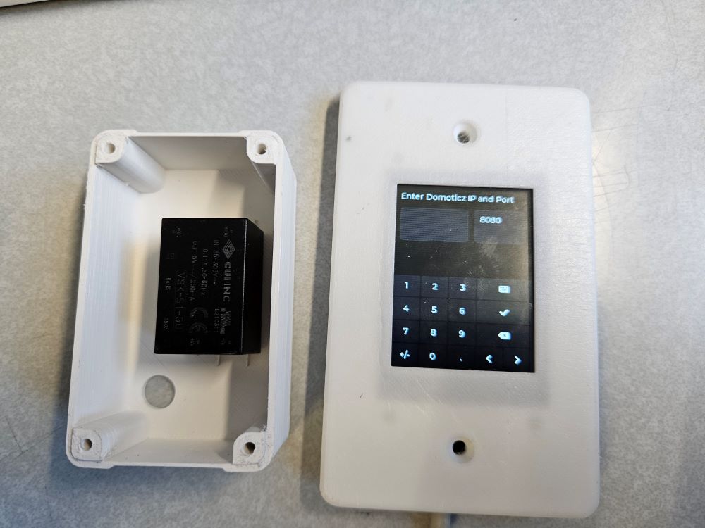

palnic
- Posts: 44
- Joined: Wednesday 13 September 2017 15:40
- Domoticz version: V3.8153
- Location: Chicago
Actually I am going to keep it vertically, since I want to replace some wall switch and display extra info on the screen. My settings stay the same:
platformio.ini:
-DTFT_WIDTH=320
-DTFT_HEIGHT=240
-DTFT_ROTATION=2
screen_driver.cpp:
So far I can't connect to Domoticz, says "Failed to connect"?
platformio.ini:
-DTFT_WIDTH=320
-DTFT_HEIGHT=240
-DTFT_ROTATION=2
screen_driver.cpp:
palnic
- Posts: 44
- Location: Chicago
No matter what I do, the is no connection to Domoticz. Connected to WiFi, Domoticz is ON, but can't connect display, it says "Failed to connect"
Thorgal789
- Posts: 920
- Target OS: -
No problem, I will update the code for the vertical support, waiting if one day I found someone that need the horizontal. But you will probably need to change the display 2*4 instead of 3*3 ?
Value to enter for connexion need to be for exemple:
- host : 192.168.1.1
- port : 8080
If it don't work
- port : 8080
If it don't work
Be sure the device have its IP autorised in the Trusted Networks setting in Domoticz.

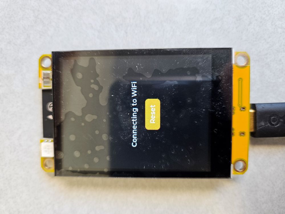

palnic
- Posts: 44
- Location: Chicago
My Domoticz address is 192.168.0.86:8080. This is what I entered. Looks like it doesn't reset connection after if failed once.
- 20240229_104914.jpg (80.45 KiB) Viewed 3367 times
Thorgal789
- Posts: 920
- Target OS: -
If I m right it's memorised, but you have a button to reset it.Looks like it doesn't reset connection after if failed once
You can set them direclty in code in main.cpp
#if FORCE_CONFIG
strcpy(global_config.wifiPassword, "xxxxxxxxxxxxxxxxxxx");
strcpy(global_config.wifiSSID, "xxxxxxxxxxxxxxx");
strcpy(global_config.ServerHost, "192.168.1.1");
global_config.ServerPort = 8080;
global_config.wifiConfigured = true;
global_config.ipConfigured = true;
const static int t[] = {37, 75, 16, 36, 28, 35, 57, 89, 45};
for (int i=0; i<TOTAL_ICONX*TOTAL_ICONY; i++)
global_config.ListDevices[i] = t[i];
WriteGlobalConfig();
#endif
You see nothing in domoticz log, or on device log (with serial monitor) ?
Yo have added the device IP to domoticz setting (trusted network) ?
