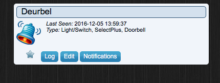

I am running Domoticz 3.5999, on RPI-2 with RF-link R44 and trying to get the Action Doorbell Select Plus 200689103 to work.
1. pull out the battery from the doorbell
2. remove the Chime from the 230v socket
3. have a cup of coffee
4. put the battery back in
5. put Domoticz in learn Light/switch mode
6. press the button
7. domoticz recognised the doorbell (see screenshots below)
8. reboot RPI
But when I press the doorbell, no action in domoticz, no log
When put the Chime back in the socket and press the button, it "rings"
When I press the domoticz icon, no action in domoticz, no rings in the Chime
Any suggestions?
