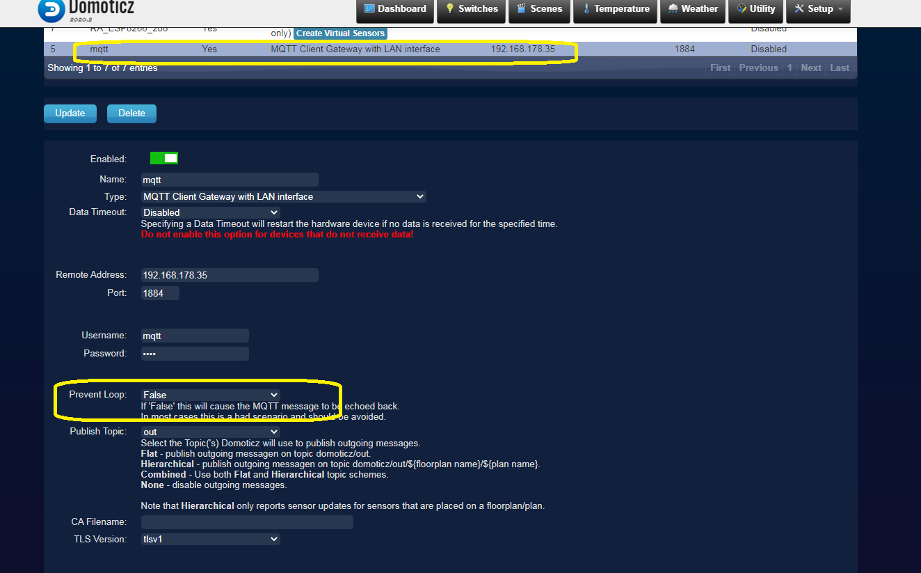

rick8245
- Posts: 74
- Joined: Wednesday 22 April 2020 15:59
Re: Easiest way to get google home connected to domoticz?
Hi Tjabas ,
In the Tab HARDWARE of Domotics.
Open up mqtt and scroll down to option: Prevent Loop:
Set this to FALSE and click UPDATE

rick8245
- Posts: 74
That is the right place...
- mqtt.png (79.5 KiB) Viewed 6677 times
tjabas
- Posts: 562
- Joined: Sunday 11 December 2016 13:51
strange , i dont have that option.
could it be that i run an older fversion of domoticz?
tjabas
- Posts: 562
this
- 123.PNG (41.64 KiB) Viewed 6671 times

ronaldbro
- Posts: 327
- Joined: Thursday 15 November 2018 21:38
- Domoticz version: 2020.2
I think this is introduced in version 2020.2.
I never experienced any problems in the older versions without this setting.
