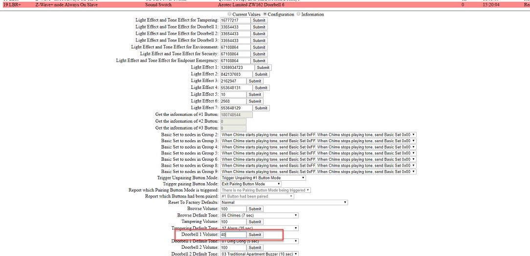

Hencor wrote: Saturday 07 September 2019 9:36 Hi raymond,
I just try to get all information / steps into a screenshot:
The send button is hidden by the Select Command window.
You can see that the SoundSwitch creates 8 different devices. Each device configure one trigger action.
The volume can be changed from 0 to 100 dec and the sound from 0 to 30 dec.

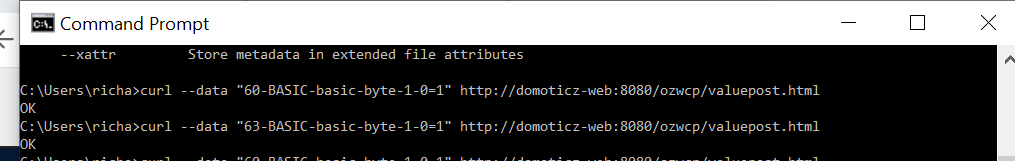

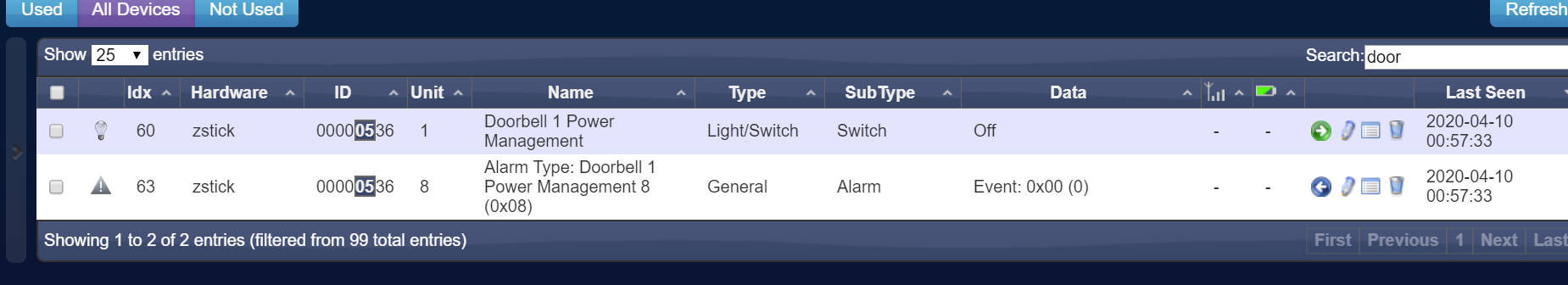

Thanks for the tip, I tried the curl commands on my Doorbell 6, but there was no sounds ( it works if I press the physical doorbell button or move the device, tampering
One of these devices ( IDX:s ), these are the only Doorbell 6 devices I have.
I have tried these commands in Windows 10
What am I doing wrong?
Thanks in advance
My setup is Domoticz 2020.1 on a Raspberry PI 2 b.
Thanks in advance

I got this to trigger the my Doorbell 6 ( first I tried to use IDX:s instead of NodeIDpdg007 wrote: Sunday 12 April 2020 12:23
The long story short ...Code: Select all
curl --data "$NODE-BASIC-basic-byte-1-0=$NUMBER" http://127.0.0.1:8080/ozwcp/valuepost.html
2020-04-15 22:19:28.018 Error: OpenZWave: Value_Changed: Tried adding value, not succeeded!. Node: 5 (0x05), CommandClass: NO OPERATION, Label: Browse Tones, Instance: 1, Index: 1
Should I be worried about this?

Going to try to set the volume settings as described on a windows laptop.
When checking the config in the zwave controller I am not able to save / update my settings:
I see this in my logging of domitcz:
2020-04-16 15:29:28.885 Error: OpenZWave: Value_Changed: Tried adding value, not succeeded!. Node: 19 (0x13), CommandClass: NO OPERATION, Label: Doorbell 1 Tones, Instance: 3, Index: 1/
- Volume.jpg (138.17 KiB) Viewed 2760 times

Got mine in today, have the same as you, changed volume (man, is that thing loud!) and the tone with the PC, I have 2 buttons, and set each one on a different sound.

I've received my doorbell 6 today and already tested it a little bit. The curl command from pdg007 works very good. Thank you for the tip.
But the volume is way too high. I've tried to set up the maximum volume with Z-Wave PC Controller on my computer like Hencor told us to do. I've followed the 6 steps like on the screenshot. At the step 6 I've entered Volume 40 dec and Default Tone identifier 1.Then I've clicked on the send button. The command has been sent evidently to the doorbell successfully. But once running in domoticz, the volume is at its max again.
What am I missing ?
