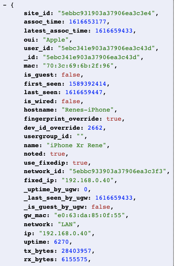

Regarding checking on a device name instead of MAC address, I'm trying this but it doesn't work.
Some code snippets and debug information:
local devices = { -- all lower case!
['iphone-van-isis'] = 111
I've added: string.lower to make sure it is due to a mismatch in upper or lower case characters.
local isPresent = string.find(string.lower(item.data), mac)
Debug info:
2021-03-24 11:57:01.695 Status: dzVents: Debug: CheckiPhoneAtHome: ** Mac:iphone-van-isis- Item data:{"meta":{"rc":"ok"},"data":[{"site_id":"5ebbc931903a37906ea3c3e4","assoc_time":1616580489,"latest_assoc_time":1616583383,"oui":"","user_id":"6048cea011850100157b58c3","_id":"6048cea011850100157b58c3","mac":"xxxxxxx","is_guest":false,"first_seen":1615384224,"last_seen":1616583412,"is_wired":false,"hostname":"iPhone-van-Isis","_uptime_by_ugw":18,"_last_seen_by_ugw":1616583401,"_is_guest_by_ugw":false,"gw_mac":"e0:xxxxxxf:55","network":"LAN","network_id":"5ebbc933903a37906ea3c3f3","ip":"192.168.0.232","uptime":2923,"tx_bytes":6986509,"rx_bytes":6847601,"tx_packets":12056,"tx_retries":3475,"wifi_tx_attempts":15481,"rx_packets":12237,"bytes-r":5,"tx_bytes-r":3,"rx_bytes-r":2,"authorized":true,"qos_policy_applied":true,"_uptime_by_uap":2923,"_last_seen_by_uap":1616583412,"_is_guest_by_uap":false,"ap_mac":"74:83:c2:da:24:3d","channel":40,"radio":"na","radio_name":"rai0","essid":"HoekHuis","bssid":"7xxxxxx3f","powersave_enabled":true,"is_11r":true,"ccq":0,"rssi":37,"noise":-96,"signal":-59,"tx_rate":270000,"rx_rate":360000,"tx_power":0,"idletime":2,"dhcpend_time":460,"satisfaction":97,"anomalies":0,"vlan":0,"radio_proto":"ac","_uptime_by_usw":150,"_last_seen_by_usw":1616583371,"_is_guest_by_usw":false,"sw_mac":"e0:xxxxxx:8c","sw_depth":-1,"sw_port":1}
<<< removed some lines >>
2021-03-24 11:57:01.697 Status: dzVents: Debug: CheckiPhoneAtHome: Processing device-adapter for iPhoneIsisAtHome: Switch device adapter
2021-03-24 11:57:01.697 Status: dzVents: Debug: CheckiPhoneAtHome: Constructed timed-command: Off
Any suggestion why this is not working?

rgroothuis wrote: Wednesday 24 March 2021 14:46 This is the full script:
OK.
can you execute this one (after entering your details and share the log that it produce? (and obscure any sensitive data)
That should give enough information to help understanding what does not work when using names iso mac addresses.

This is the log created:
2021-03-25 08:54:01.523 Status: dzVents: > tx_bytes: 52557040

Problem that I see is that the data is truncated. Seems that not all data is available.
My iPhone has the name Rene in it and I cannot find it in the log.
I had to test with a different iPhone name as the other iPhone is not at home at the moment.
When I run the api/s/default/stat/sta URL I get the response data and in that data I can find the "Rene" text.
Screenshot 2021-03-25 at 09.05.07.png (161 KiB) Viewed 2005 times
Re: Presence detection using UniFi Controller and DzVents
rgroothuis wrote: Thursday 25 March 2021 9:06 This is the log created:
Yes, some important part seems missing. Can you try to log to an OS file?
The domoticz logfile location and other settings are defined in /etc/init.d/domoticz.sh
the relevant settings are in set to the DAEMON_ARGS var.
with an editor of choice
DAEMON_ARGS="$DAEMON_ARGS -log /var/log/domoticz.log" # or any other OS file
#DAEMON_ARGS="$DAEMON_ARGS -loglevel  normal,status,error, debug" # debug disabled for now
DAEMON_ARGS="$DAEMON_ARGS -loglevel  normal,status,error" # these loglevels will make it to the logfile
#DAEMON_ARGS="$DAEMON_ARGS -debuglevel normal,hardware,received,webserver,eventsystem,python,thread_id"

In this last debug info/log I can find: ""hostname":"iPhone-van-Isis"" in the data field. So the iPhone name in the URL response is there, but it is not detected somehow. I guess the
is not working correctly.
rgroothuis wrote: Thursday 25 March 2021 9:47 Now the correct Isis iphone was at home, another piece of the log:
Will look into the other log files later. Thanks for the support
What I try to find out with the log is the structure of the JSON. That will help me to check if the values you are looking for are in the return in a more structured way then using a string.find
For that I need the complete log.
