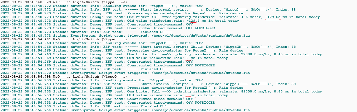

Just looking at your log, a quick remark.
rainrate 81000.0 mm/hr....? and 0.45mm/m2 total today?
should that not be the other way round.... rainrate 0.45mm/hr and total 81000.mm/m2 in total today
But a daycount of 81000 is impossible unless you put your rainmeter under a waterfall :-)
Good luck with your quest on solving this.
Regards,
Jack

hey
no it should be right, as rainrate is not 81000mm/hr its 810mm/hr wich means, that i used the switch manualy every second second. Or its 1620mm/hr using switch every second.
But yes, it would also be nice to have something like a blockage for like 5 seconds. I know you can set it up in Tasmota but i do now want it to work too much since its ment to work on battery.
So if you have an advice to change skrit so its working at maximum every 5 seconds i would like to know it :)
im still clueless with rainTotal not growing.

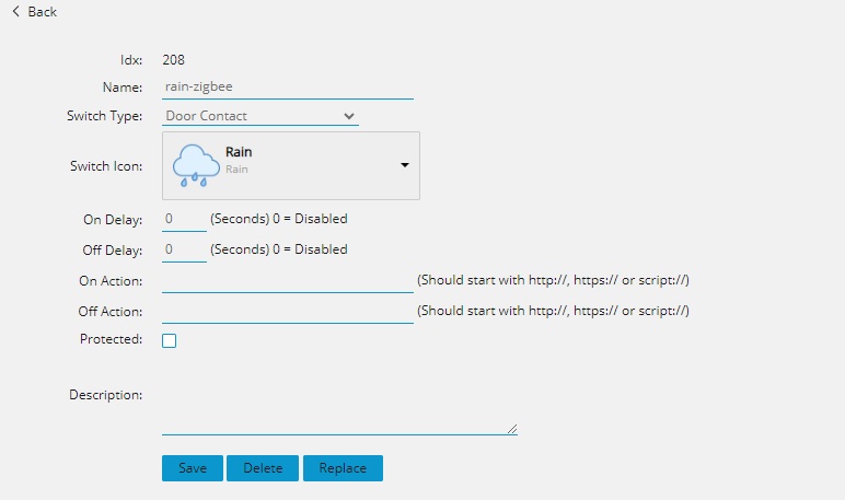

hello,
need some help,
so I created an open/closed switch. he confirms to me that the sensor in the rain gauge works and changes its state. dummy name is "rain-zigbee"
i created a custom counter type sensor, called "RegenSensorSwitch" that expresses the quantity in liters/square meter

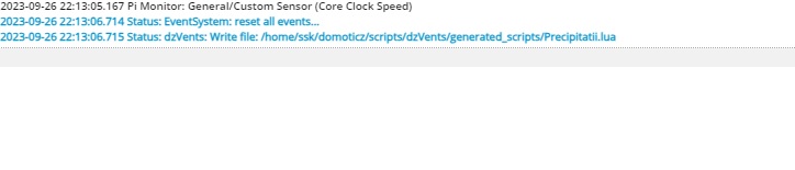

at the end in setup/events I created a new dzvents script and pasted the above script . however, in the log it appears that the script is being created, but then nothing about couter named RegenSensorSwitch
Version: 2023.2
Build Hash: 19efd039c
Compile Date: 2023-07-21 18:23:44
dzVents Version: 3.1.8
Python Version: 3.7.3 (default, Oct 31 2022, 14:04:00) [GCC 8.3.0]
any help ?
thx

It is all in the details. For the script above the devices needed are:
Rain sensor name should be RainZigbee and not rain-zigbee
The dummy switch name should be RegenSensorSwitch

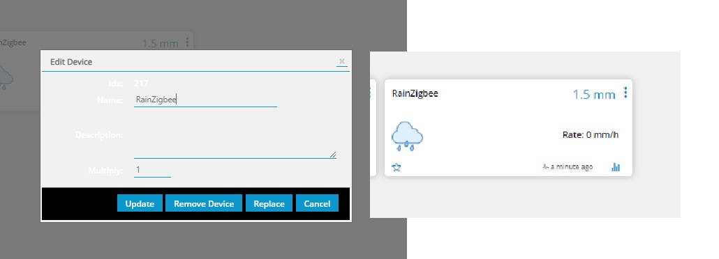

now the problem is this :
2023-09-27 18:27:20.934 Error: dzVents: Error: (3.1.8) rain-zigbee: An error occurred when calling event handler Precipitatii
2023-09-27 18:27:20.934 Error: dzVents: Error: (3.1.8) rain-zigbee: ...oticz/scripts/dzVents/generated_scripts/Precipitatii.lua:21: attempt to perform arithmetic on a nil value (local 'actual_rain')
Posts: 5859
Domoticz version: 2024.7
Re: Rain counter
What happens if you uncomment the log statements (remove the -- before domoticz.log )?
Do you have the security settings right?

so, i made another sensor, like in the foto.
i have data now, but they are not to good.
