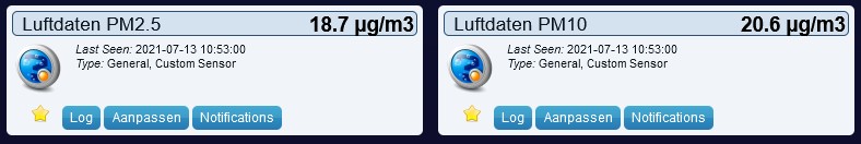

I think you created the wrong type of dummy device (deviceType = Air Quality, deviceSubType = Voltcraft CO-20). The instructions state a customer sensor:
Name: "Luftdaten PM10", Type: custom sensor, X-axis: µg/m3
Name: "Luftdaten PM2.5", Type: custom sensor, X-axis: µg/m3

Thanks a lot, that brought the solution... Reading.... :roll:

Dummies are all there in Domoticz, as recommended (temp-hum-baro and customs for the 2.5 and 10, names exactly copied)
Data shows up on the luftdaten map so that side is fine
Anyone any clues on what goes wrong ? I have no idea....
EDIT : Used IP of sensor device... working now :oops:

Is it possible with dzVents to combine these two Custom Sensors to one Sensor Window so that from both the data, PM2.5 and PM10 are visible in one graph. Just like Temperature/Huminity.

I'm not familiar enough with "custom sensor", is it possible to have it take multiple values? I don't see anything about that here: https://www.domoticz.com/wiki/Dummy_for ... tom_Sensor.

The same here, read a lot but didn't find a solution. I hope maybe "waaren" has a suggestion.

There is unfortunately no sensor that can store, show and graph multiple custom values.

Push your data into an influx database using 'Settings' -> 'More options' -> 'Data push' -> 'InfluxDB', then you can make any graphs, combining all data from as many sources you want in for example Grafana. You can install both influxdb and grafana in your local raspberry. Both influxdb and grafana are great products and they're free! Google is your friend for finding instructions how to install and use. There are however a lot of outdated topics on how to get data from Domoticz into Influxdb. Best follow the menu I indicated above and do not use old alternatives like http calls.

Or, if you have some SQL knowledge, use the grafana SQLite plugin so you can skip the influxdb export step.

Yes, that is an option too. However, the amount of data kept in the domoticz.db is quite limited and it's compacted and cleaned from time to time by Domoticz. For more serious data collection it's better to use a separate database like influxdb, as you can store much more data in there, plus you can keep the data in there for as long as you want. Plus you won't lose all your collected data if your domoticz crashes and needs to be re-installed.

Agreed on the 5 min interval data (max 7 days in domoticz). For air quality data the Domoticz daily summary would be good enough I suppose.
Not agreed on losing data on a Domoticz crash as automatic database backup is part of Domoticz setup.
If your sd/ssd crashes you would also loose the influxdb data if you did not backup externally (influxdb and Domoticz).
