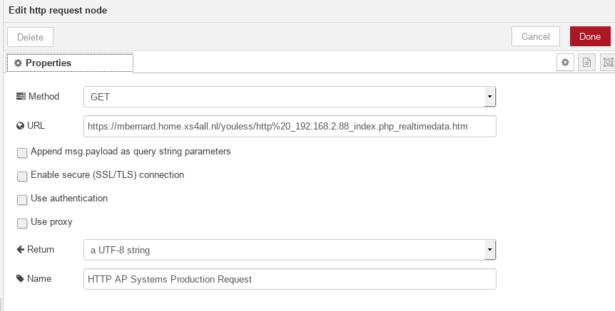

The second node is a "HTTP request" node, which should poll the IP address of your ECU.
As I don't have access to your ECU, I have used the URL, that you published in this thread:
https://mbernard.home.xs4all.nl/youless ... medata.htm.
Question 1: Please check that the output (screenshot published later) is exactly the same if you test the flow. Should be.
Question 2: Change the URL to your ECU URL. Probably: http://192.168.2.88/index.php/realtimedata.
and check that you have the same output as before (except the values).
If their are differences, please report these.

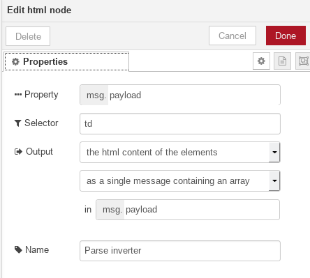

The third node is a "html" node to parse the inverter data.
The data of this "html" node is fed into a function node, in order to be able to loop over the inverters.
Code of the function node, see below.

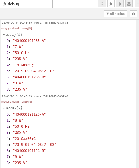

If everything is OK, you will see the following in the debug screen:
You will see an array of 9 elements. One array for each inverter.
So if you have more inverters, you will have more arrays, and vice versa.
Please check that the output is identical, when connected to your ECU.

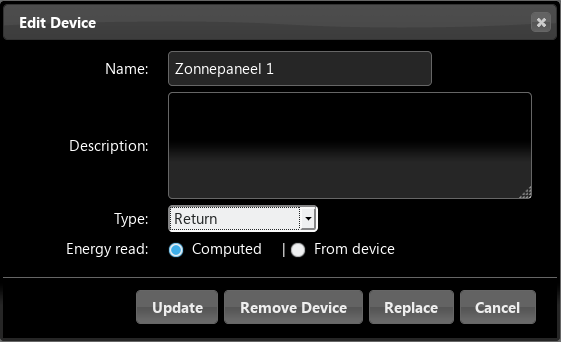

The next step is that you go to the Utility tab and look up the sensors just created.
Click on Edit and change the Type from Usage to Return.
Leave Energy read as Computed.
Press Update.
Do this for every created sensor.
You will see that the icon changes to a solar.

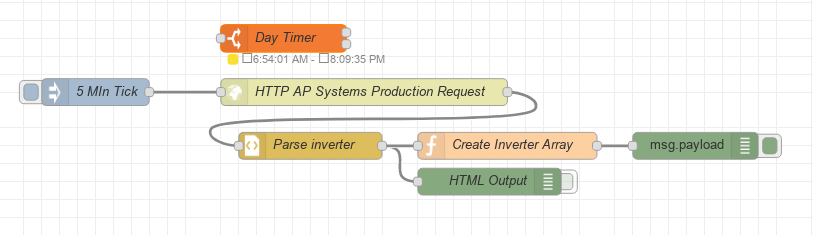

As earlier mentioned I suggested the following:
I suggest the following flow:
- inject node with 5 minute tick (can be faster, up to you), followed by timer node.

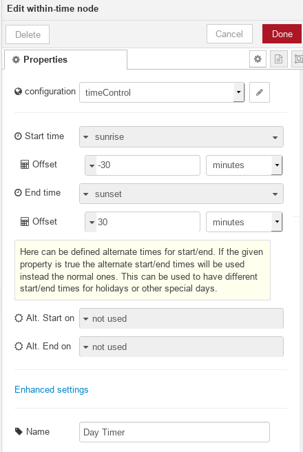

- timer node (moment), which will pass the flow (5 min. tick) between 30 minutes before sunrise until 30 minutes after sunset). It is useless to poll the inverters at night.
- next node will be the http request node, to poll the (local) url.
- html node to sort the received data.
- function node to prepare the data for domoticz.
- the last node will be mqtt-out to domoticz/in.
After studying the details I have decided not to use 1 function node, but 2. So we will have 7 nodes in the flow (beside optionally "debug" nodes).
The first function node is only used for handling the data, received from the web page and put it in an array.
The advantage is that:
- If the manufacturer (AP Systems) decides to change/update the web page, it only is necessary to do the changes in the first "function" node.
- This node can be untouched, regardless of the number of inverters and/or solar panels.
The second function node contains the conversion from the array to the suitable Domoticz commands.
The results you see below:

You made a table, where the relation between Name of the Domoticz Sensor and serial number has been put, didn't you?
3. If you have more than 6 inverters, copy the block between case and break;.

The final flow will look like:
If the output corresponds with the screenshot, above, and your own, correct number, of indexes, you can connect the output of the second "function" node to the input of the MQTT output node.
The description, how to configure the MQTT output node, you will find in this post, dated Saturday 21 September 2019 21:54.
https://www.domoticz.com/forum/viewtopi ... 14&t=29331.

Hi FireWizard,
Finally a few moments time to get to work on this.
First of all a great thank you for all your effort.
I started to work on the Node Red part.
I have this created and noticed that the "day timer" gives an error.
To overcome I deleted it and deployed.
I have now the output in my debug window.
When selecting all an event I see that I have all 6 converters and 12 panels
["404000191265-A","34 W","50.0 Hz","235 V","20 &#xB0;C","2019-09-24 15:15:25","404000191265-B","44 W","235 V",
"404000191123-A","46 W","50.0 Hz","235 V","22 &#xB0;C","2019-09-24 15:15:25","404000191123-B","47 W","235 V",
"404000193004-A","47 W","50.0 Hz","234 V","22 &#xB0;C","2019-09-24 15:15:25","404000193004-B","46 W","234 V",
"404000191257-A","48 W","50.0 Hz","234 V","20 &#xB0;C","2019-09-24 15:15:25","404000191257-B","48 W","234 V",
"404000192992-A","48 W","50.0 Hz","235 V","21 &#xB0;C","2019-09-24 15:15:25","404000192992-B","48 W","235 V",
"404000191779-A","48 W","50.0 Hz","234 V","22 &#xB0;C","2019-09-24 15:15:25","404000191779-B","47 W","234 V"]
So the scraping looks to me like it is working :)
Now I will go and do the next steps. Will need to check later when all is working why the Day Timer is not working. Could it be a Node-Red version thing or maybe I have a library not installed that provides this functionality.
Keep you posted on my progress.
Bernard

Now the timer.
That easy, because your simply missing a node, because it is not one of the core nodes.
To install:
1. Open your node red editor.
2. In the right upper corner you see the menu bar, just right of "Deploy". Open it by clicking on it.
3. Go down to "Manage palette"; click on it.
4. You will see two tabs, "Nodes" and "Install".
Under the first you will find your installed nodes, under the second you can search for nodes to install.
A huge number of nodes exists.
5. The node you need is : node-red-contrib-sun-position.
6. Goto to the "Install" tab and type: node-red-contrib-sun-position.
7. You will find it and install this node (it will take some time).
8. More info you will find: https://flows.nodered.org/node/node-red ... n-position.
9. I use the "within time" node.
Remember: This node is optional and only stops the polling of the ECU during night, when there is no production.
So you can leave it away, if you desire.

I installed the node-red-contrib-sun-position node, this went fine.
Then I configured it to use sunrise -45 min and sunset +45 min as in between time.
I configured longitude and latitude as per my location.
connected the in between timer and deployed it.
When I deploy I get an error message in the debug window:
"Error: Latitude and Longitude is wrong!"
This tells me that it would not be able to determine my location and set sunrise/sunset
Strange thing is that sunrise -45 and sunset +45 is shown correct.
So I do not understand where this is coming from? Googled it but on the node-red-contrib-sun-position page I could not find any reference to this error.
As I see the time correct next to the day-timer I thought lets insert a tick and see what happens.
When I do this node is in error state, error message:
"internal error within-time-switch:Cannot read property 'length' of undefined"
Could it be related to the format of the timestamp submitted by 5 min ticker? Checked settings but could not see anything to adjust.
After setting your lon/lat coordinates, did you click the red "Update" button?
See the screenshots below:
Screenshot_Day Timer Config2.png (35.28 KiB) Viewed 2817 times
And:
Screenshot_Day Timer Config.png (44.14 KiB) Viewed 2817 times
It looks like the lat/lon is empty.
Try it once more.

Can you connect the flow below to the output of the "5 min tick timer"?
Check the debug, and publish the results.
[{"id":"a1776ce7.3be728","type":"http request","z":"d243b84a.4ac438","name":"HTTP AP Systems Overview Request","method":"GET","ret":"txt","paytoqs":false,"url":"http://192.168.2.88/index.php/home","tls":"","proxy":"","x":320,"y":80,"wires":[["f9cd660b.5528c"]]},{"id":"f9cd660b.5528c","type":"html","z":"d243b84a.4ac438","name":"Parse inverter","property":"payload","outproperty":"payload","tag":"td","ret":"html","as":"single","x":620,"y":80,"wires":[["4f709cae.43ea9c"]]},{"id":"4f709cae.43ea9c","type":"debug","z":"d243b84a.4ac438","name":"HTML Output","active":true,"tosidebar":true,"console":false,"tostatus":false,"complete":"payload","targetType":"msg","x":840,"y":80,"wires":[]}]

The values for longitude and latitude were not empty, checked again and did do update again.
Same issue, when deploying, still gives same error on values and an internal error as soon as the first Tick is received.
Need to check what I have overlooked.

Attached the flows to the 5 min ticker, seems to work below output of the debug node:
0: "ECU ID removed"
1: "5709.28 kWh"
2: "0 W"
3: "3.8 kWh"
4: "2019-09-25 23:10:55"
5: "6"
6: "2"
7: "V4.1"
8: "Europe/Amsterdam"
9: "Mac Removed"
10: "Mac Removed"
11: "5"
Kind regards,

Yes ofcourse, done that, but when I copy keep this in mind:
Starting from Version 2.0 the coordinates are not saved as credentials due to privacy reasons. So they no longer part of the regular flow and will not part of the export! To update from a previous version save and re-deploy is necessary.
So I did an export, and saw indeed longitude and latitude on "0" I updated this to my coordinates and imported, still same issue.
when I check I see the coordinates filled in, update and done, re-deploy gives same error.
