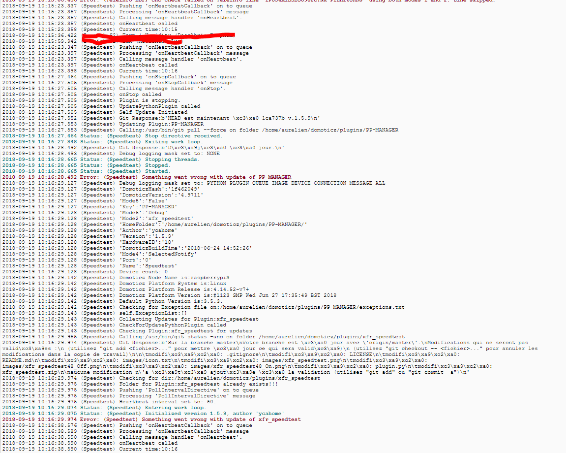

I have sudenly this error in my log.
internet speed.JPG (58.74 KiB) Viewed 3500 times
Should this be a domoticz, python or plugin issue ?
I run domoticz on a synology with beta version 3.9208
edit: Now (may) version 3.9317
andersbz
Posts: 15
Joined: Sunday 03 April 2016 20:51
Location: Sweden
Re: Python Plugin: Speedtest
Post by andersbz »
Same for me
Running on beta 3.9227 and python 3.4.2
2018-04-15 20:25:40.883 Error: (Speedtest) 'onHeartbeat' failed 'FileNotFoundError'.
2018-04-15 20:25:40.883 Error: (Speedtest) ----> Line 156 in /home/pi/domoticz/plugins/xfr_speedtest/plugin.py, function onHeartbeat
2018-04-15 20:25:40.883 Error: (Speedtest) ----> Line 105 in /home/pi/domoticz/plugins/xfr_speedtest/plugin.py, function onHeartbeat
2018-04-15 20:25:40.883 Error: (Speedtest) ----> Line 884 in /usr/lib/python3.4/subprocess.py, function __init__
2018-04-15 20:25:40.883 Error: (Speedtest) ----> Line 1457 in /usr/lib/python3.4/subprocess.py, function _execute_child
EdwinK
Posts: 1820
Location: Rhoon
Post by EdwinK »
Me too. Although the linenumbers are a bit different
2018-05-04 21:54:06.785 Error: (SpeedTest) 'onHeartbeat' failed 'FileNotFoundError'.
2018-05-04 21:54:06.785 Error: (SpeedTest) ----> Line 156 in /home/pi/domoticz/plugins/SpeedTest/plugin.py, function onHeartbeat
2018-05-04 21:54:06.785 Error: (SpeedTest) ----> Line 105 in /home/pi/domoticz/plugins/SpeedTest/plugin.py, function onHeartbeat
2018-05-04 21:54:06.786 Error: (SpeedTest) ----> Line 701 in /usr/lib/python3.5/subprocess.py, function __init__
2018-05-04 21:54:06.786 Error: (SpeedTest) ----> Line 1282 in /usr/lib/python3.5/subprocess.py, function _execute_child

Somehow there was something wrong with my speedtest-cli, but there's another speedtest in my container (speedtest without -cli)
Changed _COMMAND = "speedtest-cli" in _COMMAND = "speedtest" in the Plugin.py and it's working.
kr.,
1kke

i have a problem with the plugin. Since 1 week the plugin doesn't work. Python with lib is ok. Script lua was enable.
speedtest-cli --single work perfectly:
Retrieving speedtest.net server list...
Selecting best server based on ping...
Hosted by KEYYO (Paris) [1.88 km]: 89.427 ms
Testing download speed................................................................................
Download: 7.88 Mbit/s
Testing upload speed................................................................................................
Upload: 6.91 Mbit/s
But
2021-04-14 11:34:07.565 (internet) onHeartbeat called
2021-04-14 11:34:07.565 (internet) onHeartbeat called, run again in 340 heartbeats.
2021-04-14 11:34:17.529 (internet) Pushing 'onHeartbeatCallback' on to queue
2021-04-14 11:34:17.534 (internet) Processing 'onHeartbeatCallback' message
2021-04-14 11:34:17.534 (internet) Calling message handler 'onHeartbeat'.
2021-04-14 11:34:17.534 (internet) onHeartbeat called
2021-04-14 11:34:17.534 (internet) onHeartbeat called, run again in 339 heartbeats.
2021-04-14 11:34:27.530 (internet) Pushing 'onHeartbeatCallback' on to queue
2021-04-14 11:34:27.563 (internet) Processing 'onHeartbeatCallback' message
2021-04-14 11:34:27.563 (internet) Calling message handler 'onHeartbeat'.
2021-04-14 11:34:27.563 (internet) onHeartbeat called
2021-04-14 11:34:27.564 (internet) onHeartbeat called, run again in 338 heartbeats.
2021-04-14 11:34:37.532 (internet) Pushing 'onHeartbeatCallback' on to queue
2021-04-14 11:34:37.582 (internet) Processing 'onHeartbeatCallback' message
2021-04-14 11:34:37.582 (internet) Calling message handler 'onHeartbeat'.
2021-04-14 11:34:37.582 (internet) onHeartbeat called
2021-04-14 11:34:37.582 (internet) onHeartbeat called, run again in 337 heartbeats.
2021-04-14 11:34:47.534 (internet) Pushing 'onHeartbeatCallback' on to queue
2021-04-14 11:34:47.550 (internet) Processing 'onHeartbeatCallback' message
2021-04-14 11:34:47.550 (internet) Calling message handler 'onHeartbeat'.
2021-04-14 11:34:47.550 (internet) onHeartbeat called
2021-04-14 11:34:47.550 (internet) onHeartbeat called, run again in 336 heartbeats.
2021-04-14 11:34:57.536 (internet) Pushing 'onHeartbeatCallback' on to queue
2021-04-14 11:34:57.568 (internet) Processing 'onHeartbeatCallback' message
2021-04-14 11:34:57.568 (internet) Calling message handler 'onHeartbeat'.
2021-04-14 11:34:57.568 (internet) onHeartbeat called
2021-04-14 11:34:57.568 (internet) onHeartbeat called, run again in 335 heartbeats.
2021-04-14 11:35:07.538 (internet) Pushing 'onHeartbeatCallback' on to queue
2021-04-14 11:35:07.568 (internet) Processing 'onHeartbeatCallback' message
2021-04-14 11:35:07.568 (internet) Calling message handler 'onHeartbeat'.
2021-04-14 11:35:07.568 (internet) onHeartbeat called
2021-04-14 11:35:07.568 (internet) onHeartbeat called, run again in 334 heartbeats.
I have no idea...... Sorry for my basic english.

jeroen1985
Joined: Saturday 17 April 2021 13:17
Post by jeroen1985 »
i run domoticz on nuc and debian 10 and i had the same issue so i uninstall speedtest.cli en restart and again installing speedtest.cli
