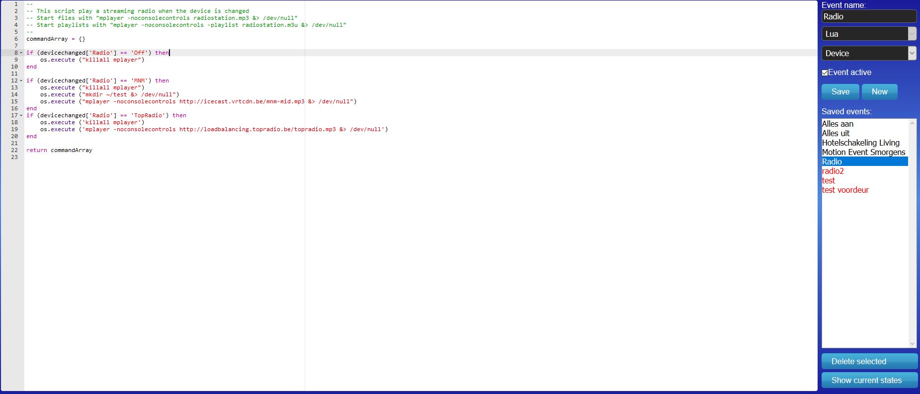

if i run the script in domoticz my terminal get not any input

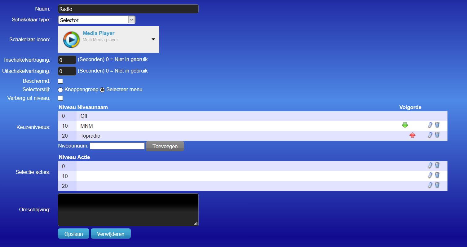

this is my selector
and this is my code
-- This script play a streaming radio when the device is changed
-- Start files with "mplayer -noconsolecontrols radiostation.mp3 &> /dev/null"
-- Start playlists with "mplayer -noconsolecontrols -playlist radiostation.m3u &> /dev/null"
if (devicechanged['Radio'] == 'Off') then
    os.execute ("killall mplayer")
if (devicechanged['Radio'] == 'MNM') then
    os.execute ("mplayer -noconsolecontrols http://icecast.vrtcdn.be/mnm-mid.mp3 &> /dev/null")
if (devicechanged['Radio'] == 'TopRadio') then
    os.execute ("mplayer -noconsolecontrols http://loadbalancing.topradio.be/topradio.mp3 &> /dev/null")
return commandArray
  --  os.execute ("mplayer -noconsolecontrols http://icecast.vrtcdn.be/mnm-mid.mp3 &> /dev/null")
if i try your solution no test Folder
    os.execute ("sudo mkdir ~/test &> /dev/null")
    os.execute ("sudo mplayer -noconsolecontrols http://icecast.vrtcdn.be/mnm-mid.mp3 &> /dev/null")

Oh one Idea. Check the main settings:
Re: Listen to your favourite radios V2
Posted: Wednesday 19 September 2018 9:26
by Gianni
exact the same ;-)
