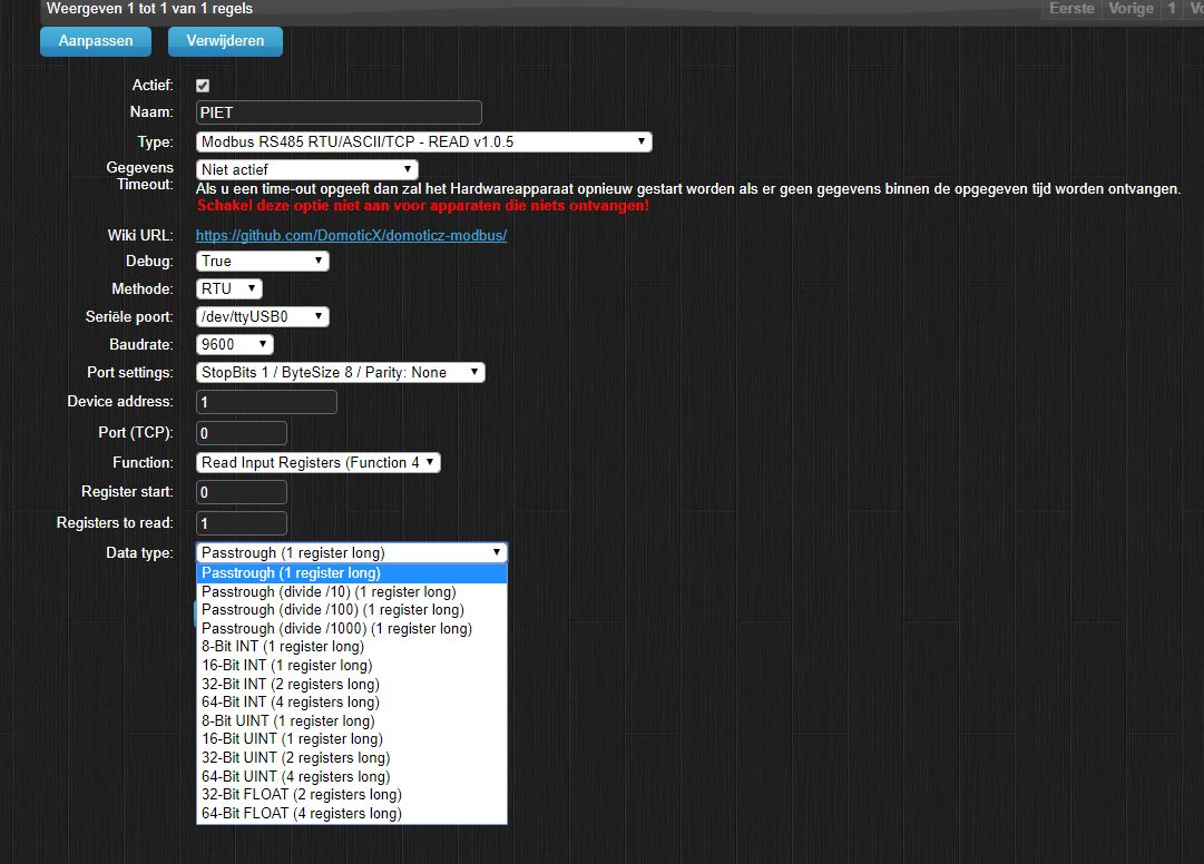

I've just released READ v1.0.5 (please restart domoticz after plugin update)
In this version i've added a passtrough option (no conversion, like a "string") with divide options (see screen @ bottom) and some decimal fixes!
Tested succesfully! :geek:
Ps. Can you try setup in domoticz:
- ip and port
- start register address: 1010
- read: 1
- Passtrough /100
Let me know if it worked! (of not....post LOG)

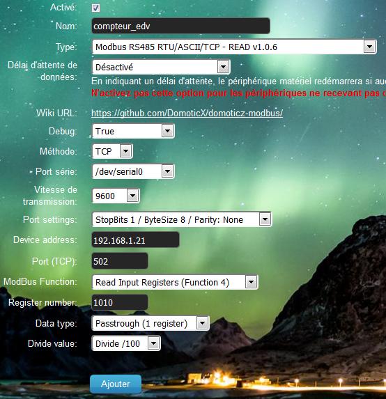

The v1.0.6 don't work's for me, domoticz crash
2018-01-24 20_15_57-Domoticz - Firefox Developer Edition.jpg (58.65 KiB) Viewed 3537 times
2018-01-24 20:12:33.523 Incoming connection from: 127.0.0.1
2018-01-24 20:15:31.687 (compteur_edv) Started.
2018-01-24 20:15:32.242 (compteur_edv) Entering work loop.
2018-01-24 20:15:32.244 (compteur_edv) Initialized version 1.0.6, author 'S. Ebeltjes / domoticx.nl'
2018-01-24 20:15:32.298 (compteur_edv) Debug log level set to: 'true'.
2018-01-24 20:15:32.298 (compteur_edv) 'Password':'1010'
2018-01-24 20:15:32.299 (compteur_edv) 'HardwareID':'13'
2018-01-24 20:15:32.299 (compteur_edv) 'HomeFolder':'/home/pi/domoticz/plugins/modbus-read/'
2018-01-24 20:15:32.299 (compteur_edv) 'Version':'1.0.6'
2018-01-24 20:15:32.299 (compteur_edv) 'DomoticzHash':'8c2cc0ba'
2018-01-24 20:15:32.299 (compteur_edv) 'Mode2':'9600'
2018-01-24 20:15:32.299 (compteur_edv) 'Mode1':'tcp'
2018-01-24 20:15:32.299 (compteur_edv) 'Mode6':'pass'
2018-01-24 20:15:32.299 (compteur_edv) 'Username':'4'
2018-01-24 20:15:32.299 (compteur_edv) 'Address':'192.168.1.21'
2018-01-24 20:15:32.299 (compteur_edv) 'Name':'compteur_edv'
2018-01-24 20:15:32.299 (compteur_edv) 'Mode4':'debug'

papoo
Posts: 126
Joined: Friday 22 January 2016 22:14
Domoticz version: 4.10
Location: France
Re: [Released] Python plugin: Modbus RS485 RTU/ASCII/TCP
Post by papoo »
client = ModbusTcpClient('192.168.1.21', port=502)
i remove all domoticz hardware, only modbus
It crash when this log appear
Modbus RS485 RTU/ASCII/TCP - Universal READ loaded.

papoo
Posts: 126
Location: France
Post by papoo »
you don't update version number ;)
y update on my version
same problem
