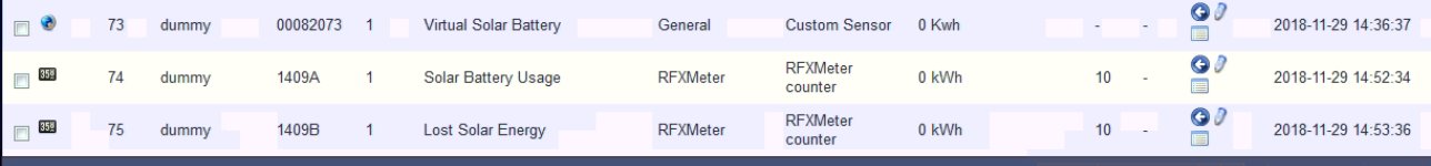

hi, i modify the code like this:
--Manually create and/or define below (newly created virtual) devices and 'User Variables' by user given names
local electricity_meter = 'Immissioni'					-- Existing P1 Electricity device name in 'Utility'
--To be created virtual devices in the hardware section of Domoticz:
local solar_battery = 'Virtual Solar Battery'				-- (1) Custom Sensor name for the 'Virtual Solar Battery'
local solar_battery_idx = 73
local battery_use = 'Solar Battery Usage'				-- (2) RFXMeter counter name for the 'Solar Battery Usage'
local battery_use_idx = 74
local lost_energy = 'Lost Solar Energy'					-- (3) RFXMeter counter name for the 'Lost Solar Energy'
local lost_energy_idx = 75
--User Variables:
local battery_capacitylevel = 'SolarBatteryCapacity'		-- User Variable name for the 'Solar Battery Capacity'. Type 'String'. Value in Wh (4kWh battery = '4000')
local total_electricity = 'TotalElectricity'
i write as local electricity_meter = 'Immissioni'
but i receive this error:

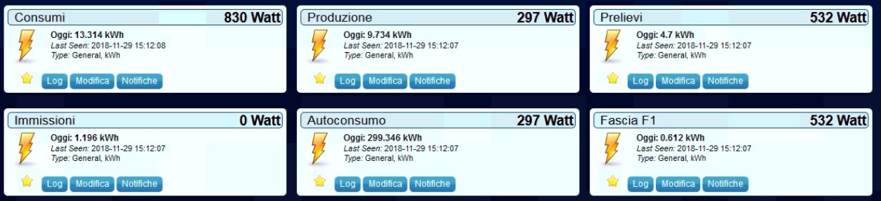

this is how are defined my electic sensors:
and i choose "immissioni" to put in the script, that are the amount of energy that i put on the grid (only positive value, if i take from the grid, i will have immissioni=0 and "prelievi" that show the value of enery take from grid.
i have also "produzione" = enery produced
"consumi" = home energy consumption (without considering the production, the "pure" consumption of the house)
