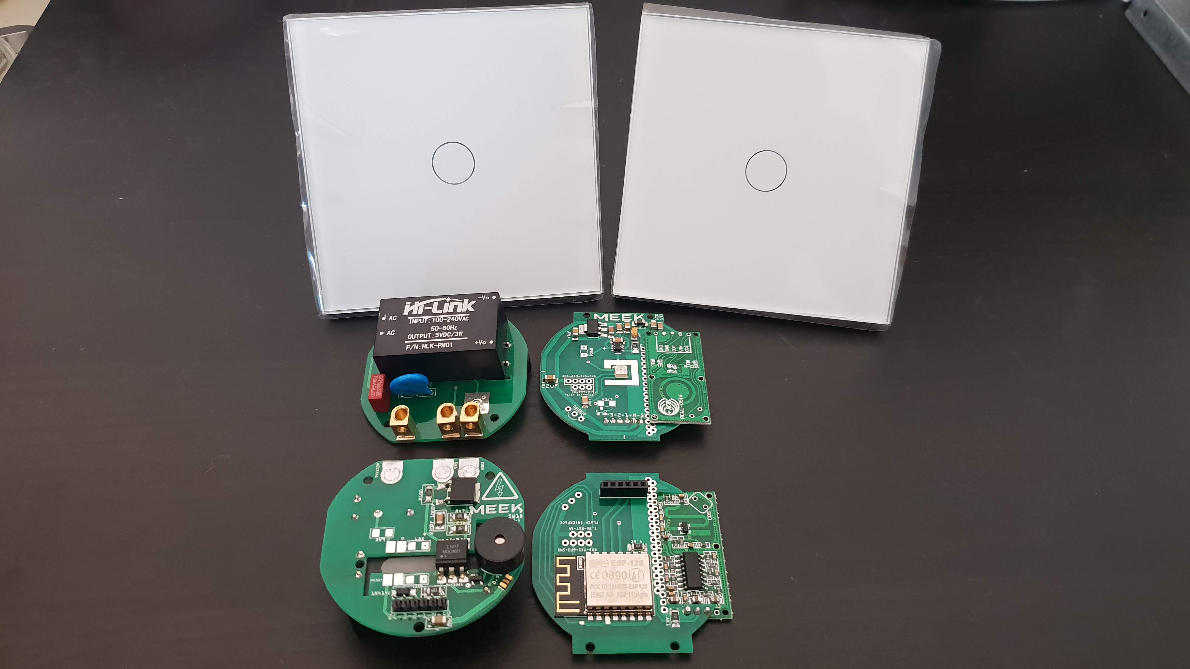

Herewith a picture of the latest revisions Meek MP1 switches.
We’re currently assembling these to distribute them to a select group of tester.
The Meek MP1 is a :
• Wi-Fi enabled light switch
• With a Doppler presence detector
• Audi visual feedback with a RGB addressable LED and a RTTTL Speaker
• Fully programmable timers a functions
This switch operates out of the box even without a Wi-Fi connection.
Once connected to Wi-Fi you can control it with any device that has a browser (Phone, TV, Smart Watch,…) or by speech recognition enabled devices (Google Home, Alexa, Siri,..).
Ongoing, we’re expanding the functions of these devices.
For instance :
• Alarm Function ; you can “arm” the device, so whenever a movement is detected, the Meek MP1 will sound and alarm and blink the light continuously until the user disarms it.
• Doorbell ; (we will develop a doorbell in the future) if you have “Smart Doorbell”, whenever the doorbell is pressed, the Switch will mimic a doorbell and blink the lights.
• Night Modus : the presence detection will only switch the lights, if it’s in the Night Modus.
As we’re developing several other Meek devices, that will seemingly interact with each other, to truly create a smart house !
The possibilities are endless as the community is able to contribute and able to add extra functionality to our devices !

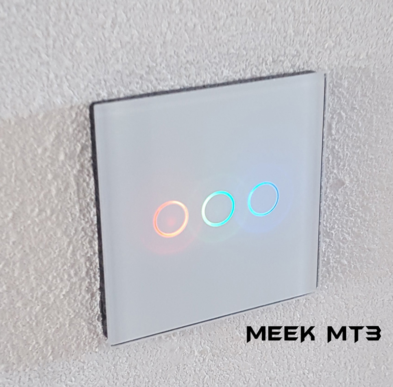

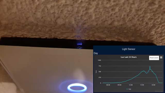

A brief update: attached you’ll finds a few pictures of the final versions that are currently been tested:
As announced earlier, we have the intension to release the switches end September in small quantities.
The first available versions will be the :
• Meek MT1 (Meek Touch with 1 Touch input/output)
• Meek MP1 (Meek Presence with 1 Touch input/output)
In October, we’ll add the :
• Meek MT2 (Meek Touch with 2 Touch input/output)
• Meek MT3 (Meek Touch with 3 Touch input/output)
In the 4’th quarter, the Meek MM1 (Meek Motor for “mechanical home ventilation systems”) will be added to the product range.
The development of the Meek Wi-Fi Dimmer “Meek MD1” still continues and in our test environment, it’s already showing pretty good results!
On the hardware side it’s nearly completed but we still need to deploy some enhancements on the software side to ensure flawless operations in various conditions. We expect them to be commercially available in 2019.
Our website ( www.meek-ha.com )is also undergoing some transformation with information about the switches itself but also how to integrate them in various automations systems.
Just to tickle the imagination and show the endless possibilities with these devices, as proof of concept, we’ve imbedded a light sensor in the switch.
In the near future we will bring you more groundbreaking and exiting new devices!
