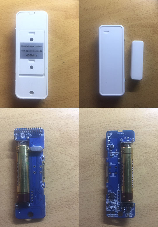

Hi all.
Someone could make this sensor work, Domoticz detects it as a sensor (X10)
RFXCOM D0F600 0 Unknown Security X10 security Motion
It does not change state.
Thank you.
Thank you.

Re: Cheap 433MHz door sensor (with open and close)
it seems that this model is not supported, if it responds to opening or closing, but only information appears when I use Lighting 4 and undec together
04/06/2019 12:49:35:358
Packettype = Lighting4
subtype = PT2262
Sequence nbr = 108
Code = D0F60A decimal:13694474
S1- S24 = 1101 0000 1111 0110 0000 1010
Pulse = 461 usec
Signal level = 6 -72dBm
04/06/2019 12:49:35:546
Packettype = UNDECODED RF Message
UNDECODED ARC:2643D8280734
04/06/2019 12:49:35:610
UNDECODED ARC:27A1EC14073E
04/06/2019 12:49:35:687
UNDECODED ARC:2643D828073E

AurelioF
- Posts: 33
- Joined: Wednesday 03 October 2018 18:01
- Location: Spain
It has an erratic behavior, only detects an x10 device, but not always.
If only Active Lighting4 nothing happens.
If only active x10 detects a device, but it seems to act strangely, not when opening or closing.
If Active Lighting4 and x10 behaves in a similar way
only if active undec and Lighting4, seems to react to the opening and closing.
I have the impression that it is not supported.
The manufacturer says that it has two actions when opening and closing
I have exactly the same the devices it seems. I switched to the RFXmngr to detect what it is exactly and tried with both Type 1 firmware and Type 2 firmware, but it is only received when 'undec on' is switched on. It does not matter if Lighting4 is switched on or off. It looks the same as in the initial post, but I guess it does not work the same. I tried all the protocols, nothing works, only 'undec on'.AurelioF wrote: Wednesday 05 June 2019 0:26 It has an erratic behavior, only detects an x10 device, but not always.
