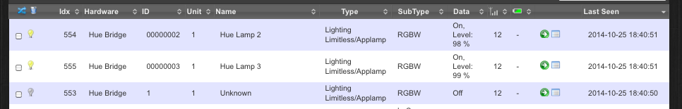

So went to Hardware - added the Philips Hue Bridge - filled in ip address and username - clicked register after having pressed the link button on the bridge and magically under devices I then had 3 Lighting Limitless / Applamp devices.
2 of my lamps are labelled Hue Lamp 2 (id 00000002, unit 1) and Hue Lamp 3(id 00000003, unit 1), the other is labelled as Unknown (id 1, unit 1). So moved devices from unused to used, renamed Unknown to Hue Lamp 1, went to switches and edited type of Hue Lamp 1.
Lamps 2 and 3 work fully with colour control, on/off etc, but lamp 1 basically works, apart from the Domoticz display does not change correctly saying lamp is Off when it is On. Something funny going on, will delete everything and try again.

Deleted Hue Lamp devices and Hue Bridge hardware, reinstalled hardware - still 2 lamps recognised correctly and 1 not.
Screen shot 2014-10-25 at 18.41.16.png (38.06 KiB) Viewed 12320 times
All 3 lamps are original with no differences showing up in any other context.
So I guess this must be a bug?

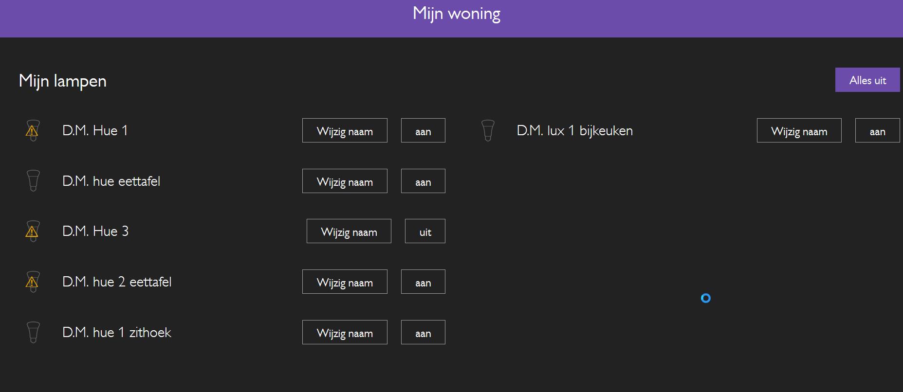

I found a little bug, the livingcolor lights within hue aren't recognized properly. It is in domoticz always in the off state, but I can control it. Also the living color shows as normal switch instead of a dimmer like the e27 hue lights.
