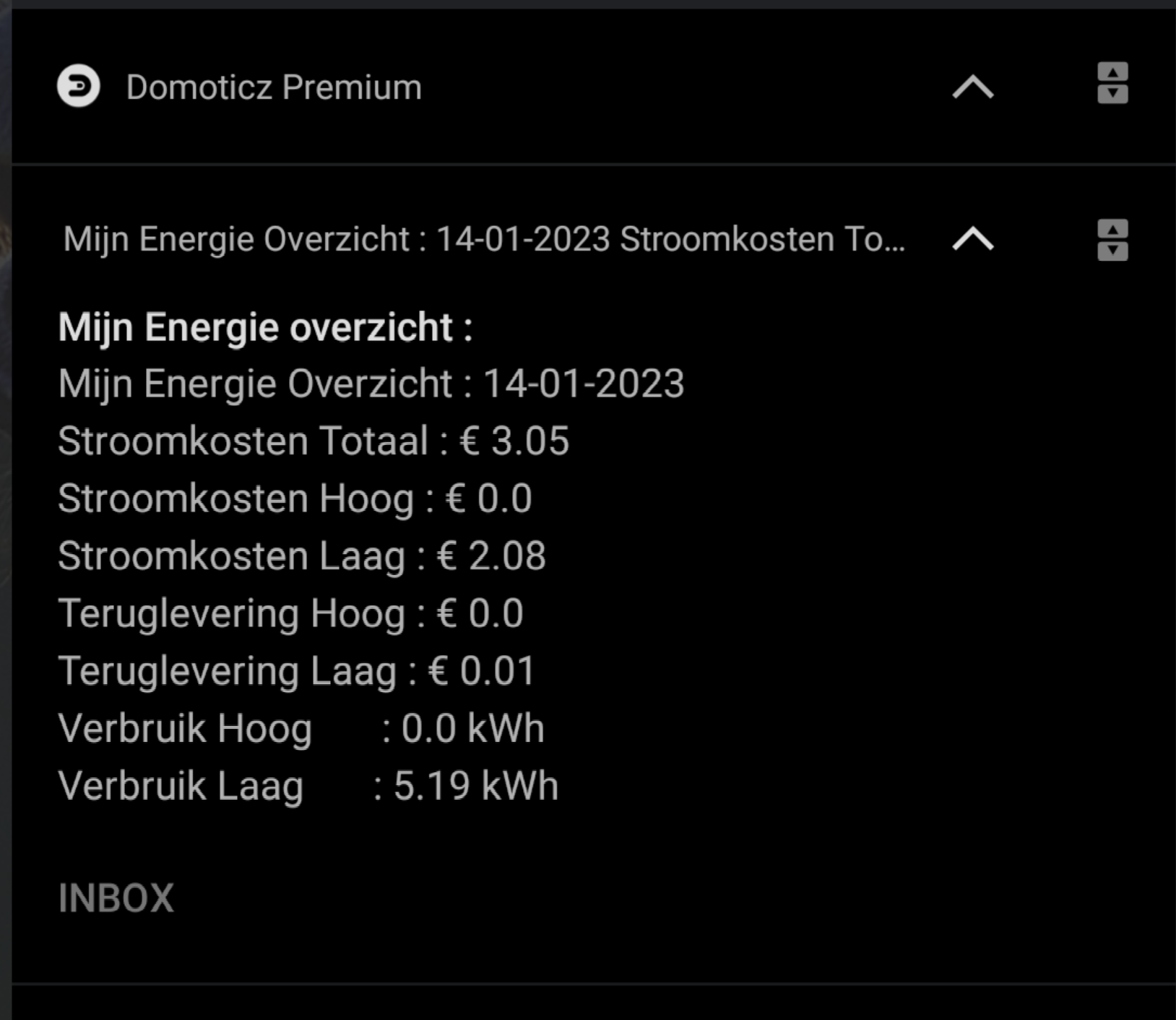

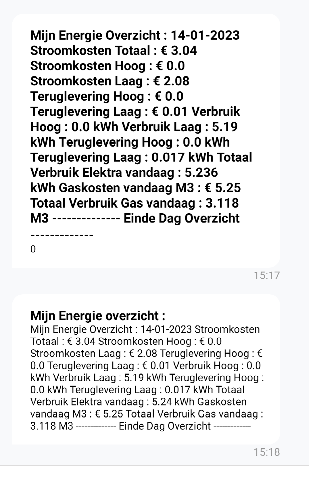

Re: Question about notifications in dzVents
Next question.
Data being pushed by Google Cloud Messaging are displayed on one line, despite the '\n' found in @Xavier82 script.
Any idea how to force a new line?
Bugs bug me.
Thanks @Xavier82 for your contribution.
I implemented it.
Last part of the code I'm using:
When I do not add 'subject' to the message everything shows bold, plus the first lines are nicely one string one line.
After 5 lines things get mixed up.
What's happening here and how can I influence it.
I'm using Google Cloud messaging This is the popup that shows on my phone.
This is the message as shown in the Domoticz app.
(differences explained above)
My question is on how to influence /n behaviour.
Why does it change after five lines in the bold text and why does it behave like it does when I add the subject to the push message.

dz.notify(subject, message, dz.PRIORITY_NORMAL)After 5 lines things get mixed up.
Bugs bug me.
