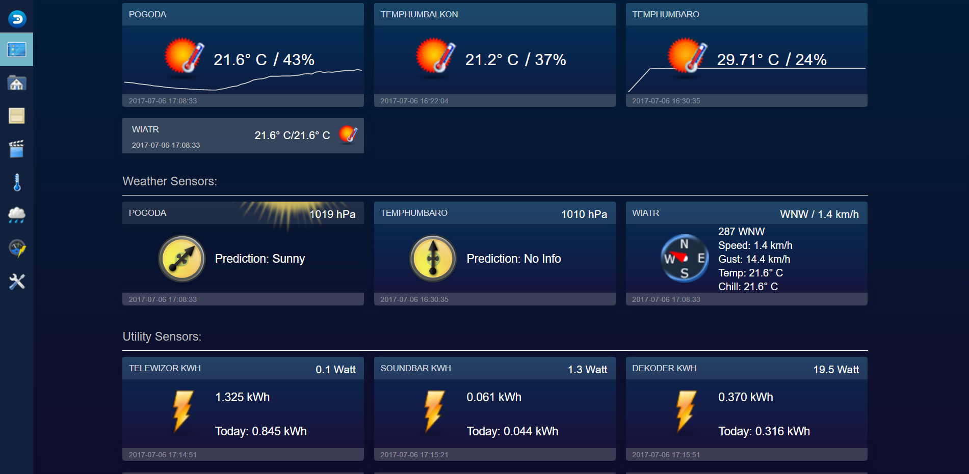

@blauwebuis ctrl+shift+del do the trick.
Now I can see the graphs... but not all. As U can see Pogoda (Weather Underground) and TempHumBaro (BME280 ESPEasy) are OK but TempHumBalkon (RFLink) aren't. Same with energy meter (z-wave) no graphs at all.
Domoticz (6).png (331.4 KiB) Viewed 4302 times
Temperature Tab is also OK after deep cleaning. Hi-resolution icons in the menu now looks perfect. So ctrl+F5 even hitted couple of times is not enough.
"Perhaps you could create a new theme based on these themes that makes them all big, it shouldn't be too hard" If U give me some hints I can play with that. I am rather end user not the programer but... we learn whole our life. :D
GREAT GREAT Job, again. TYVM. Now we in 21 century. ;)

@LouiS22: you can merge any utilities you want (as long as the only have one output). In theory you could merge 10 items maximum. But my advice: stop at 4 or 6.
@IDANIT: currently the graphs are not generated for every possible device type. But this could easily be expanded, and has already been built in such a way that this is very easy to do. Just add another type here: https://github.com/domoticz/domoticz/bl ... ller.js#L9

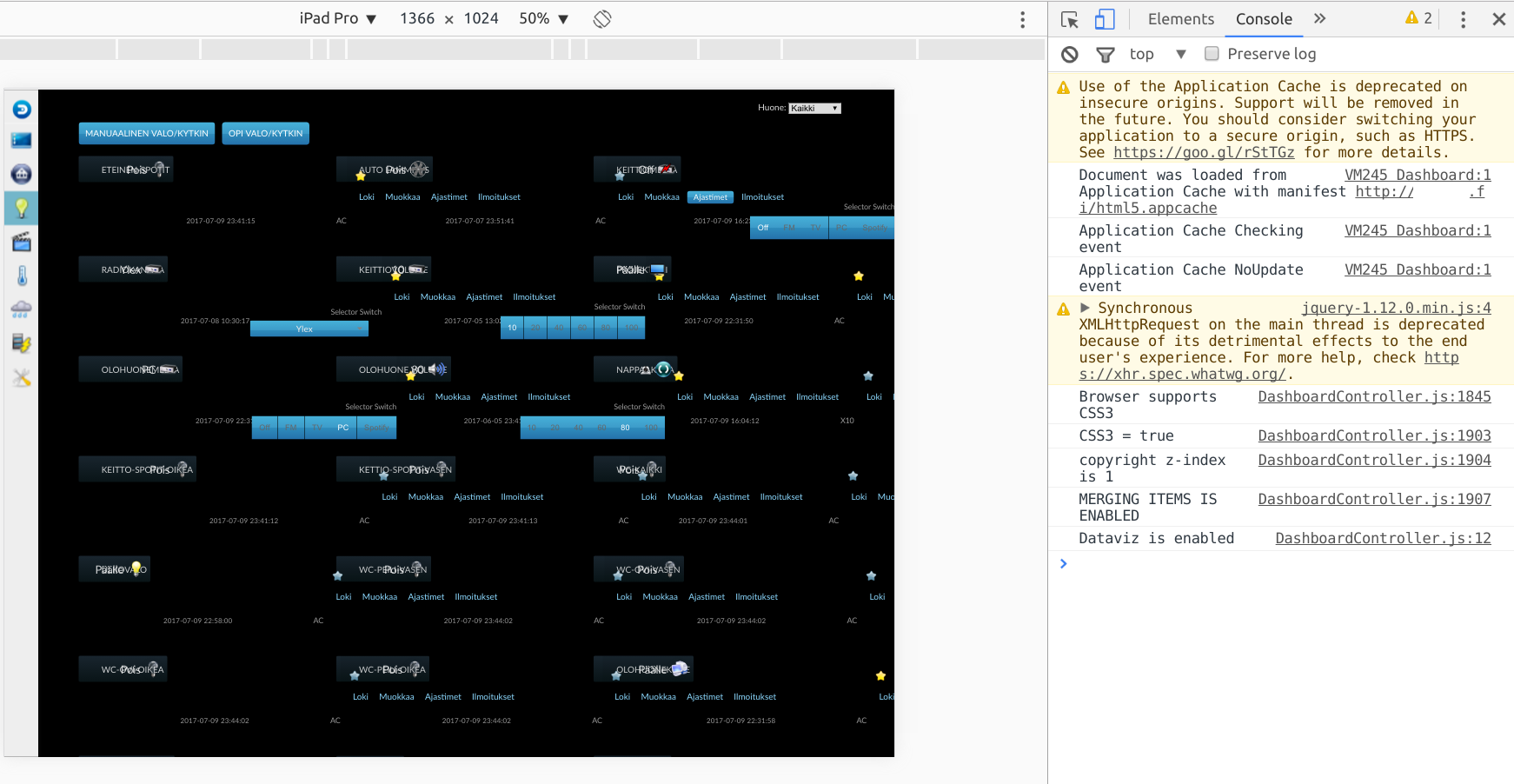

I like this theme a lot! Just some minor fixes(to mobile mode) might be needed ;)
qwerk: You are not only one with the problem. For me it happens on mobile device with resolution 1280x800. Also for me the dashboard is ok. 766 is the max width where the mobile mode work correctly in my tests.
Also for some reason I cannot force browser to use desktop version. Every time it switches back to mobile.
Steps to preproduce:
1. open page in chrome
2. switch to emulator mode
3. select iPad Pro
4. turn to landscape(if not already)
5. reload the page(F5)
6. go to switches tab.
Also if you try to change from setting mobile -> desktop and save it wont have effect and its mobile -> mobile next time you go to settings.
ps. I did some minor tweaking to css to get rid of the background 8-)

Post by pj-r »
IDANIT wrote:For those with interface issues, try ctrl+shift+del, if that does not help, try Incognito mode of your browser.
Just try, you can have the same effect if you try the steps I wrote on my post. And yes, I've done force reload and clearing cache multiple times since its the thing number one to try.
I also happen to have an account to browserstack.com and can try multiple different devices what I think cannot have the page in cache already ;)
edit:
In desktop mode everything works as expected. In mobile mode the layout breaks.
It happens with default, feynman and partly with element-light. Width: 767 ok, 768 and bigger broken.
./css/bootstrap-responsive.css:@media (max-width: 767px) {..}
./styles/default/base.css:@media all and (max-width: 767px){..}
./styles/default/classic.css:@media all and (max-width: 767px){..}
./styles/elemental/custom.css:@media (max-width: 767px) {..}
./styles/feynman/base.css:@media all and (max-width: 767px){..}
edit:
Perhaps I could fake the UserAgent to get the browser to use desktop mode.
UserAgent handling seems to live in:
./www/app/DashboardController.js
./www/app/app.js
./www/index.html
edit:
Success! As temporary fix I removed Android from javascript/angular mobile checks(UserAgent) and got the desktop version in use on my wall tablet. Now it works fine.
LXC(x64 Ubuntu Xenial), RFXtrx433E, MySensors

@qwerk: did you delete the old WWW folder first, or did you just overwrite it with the new files? Perhaps some old files are still there. There are more strange things: that little cloud is not supposed to be there. There is something wrong with the way your installation is dealing some CSS things, like absolute and relative positioning. That cloud is a little easter egg for people with rain sensors, but it should be on the sensor item itself, raining :-)
@pj-r: interesting. Are you having the issue on a tablet? So it might be a mobile mode that is influencing things. Hmm. But I can't reproduce the problem. Did you also copy the files over the old ones, instead of first removing the WWW folder?
// I CAN however reproduce the problem where the mobile settings isn't stored by the interface. That a bug, but I'm not sure if that is because of the theme. The theme shouldn't influence how that works.
