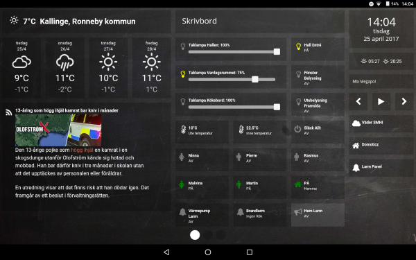

Here is my Dashticz on my Asus tf101, it´s a never ending story. Not much changes.

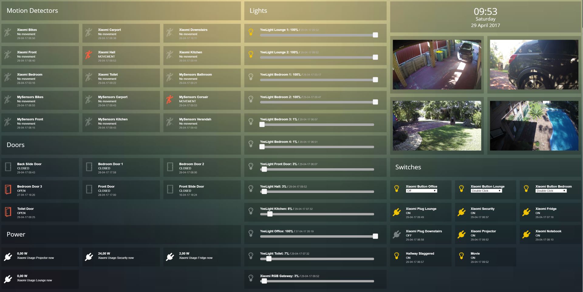

Here's my current Dashticz
config.js
var _LANGUAGE 			= 'en_US';
var _HOST_DOMOTICZ		= 'http://192.168.5.27:8080';
var _DOMOTICZ_REFRESH		= 10; //in seconds
var _HOST_ZIGGO_HORIZON	  	= ''; //e.g. http://192.168.1.3/domoticz/switch_horizon.php';
var _APIKEY_WUNDERGROUND  	= '1fd66f22fe9db6cc';
var _WEATHER_CITY 		= 'Brisbane';
var _WEATHER_CITYNAME 		= ''; //show a different city name, leave empty if same as _WEATHER_CITY
var _WEATHER_COUNTRY 		= 'AU';
var _USE_AUTO_POSITIONING 	= false; //don't want to configure positions, use auto positioning
var _USE_FAVORITES		= true; //only used when using auto positioning
var _HIDE_SECONDS_IN_CLOCK  = true; //do not show the seconds in the clock
var _NEWS_RSSFEED		= 'https://www.reddit.com/r/homeautomation/.rss';
var _USE_FAHRENHEIT		= false;
var _USE_BEAUFORT 		= true; //Bft instead of m/s
var _TRANSLATE_SPEED 		= false; //windspeed, north northwest instead of NNW
var _STANDBY_AFTER_MINUTES  = false; //enter amount of minutes like: 5 (5 minutes)
var _SCROLL_NEWS_AFTER 		= 7000; //milliseconds, so 7000 is 7 seconds
var _SHOW_LASTUPDATE 		= true;
var _LASTUPDATE_FORMAT = 'DD-MM-YY HH:mm';
//Buttons or images to open webpages in an iframe, like a news website or weather forecast
var buttons = {}
buttons.webcam1 = { width:6, isimage:true, refresh:5000, image: 'http://admin:[email protected]/Streaming/channels/1/picture', url: 'http://admin:[email protected]/Streaming/channels/1/picture' }
buttons.webcam2 = { width:6, isimage:true, refresh:5000, image: 'http://admin:[email protected]/Streaming/channels/1/picture', url: 'http://admin:[email protected]/Streaming/channels/1/picture' }
buttons.webcam3 = { width:6, isimage:true, refresh:5000, image: 'http://admin:[email protected]/Streaming/channels/1/picture', url: 'http://admin:[email protected]/Streaming/channels/1/picture' }
buttons.webcam4 = { width: 6, isimage: true, refresh: 5000, image: 'http://admin:[email protected]/Streaming/channels/1/picture', url: 'http://admin:[email protected]/Streaming/channels/1/picture' }
buttons.webcam5 = { width: 6, isimage: true, refresh: 5000, image: 'http://admin:[email protected]/Streaming/channels/1/picture', url: 'http://admin:[email protected]/Streaming/channels/1/picture' }
var blocks = {}
blocks['blocktitle_1'] = {}
blocks['blocktitle_1']['title'] = 'Motion Detectors';
blocks['blocktitle_2'] = {}
blocks['blocktitle_2']['title'] = 'Doors';
blocks['blocktitle_3'] = {}
blocks['blocktitle_3']['type'] = 'blocktitle';
blocks['blocktitle_3']['title'] = 'Power';
blocks[110] = {}
blocks[110]['title'] = 'SolarEdge Inverter'
var columns = {}
columns[1] = {}
columns[1]['blocks'] = ['blocktitle_1', 15, 26, 28, 9, 36, 34, 46, 17, 76, 96, 95, 74, 80, 75, 78, 'blocktitle_2', 19, 23, 38, 40, 42, 44, 30, 'blocktitle_3', 110, 49, 48, 50, 102, 108];
columns[1]['width'] = 5;
blocks['blocktitle_4'] = {}
blocks['blocktitle_4']['title'] = 'Lights';
columns[2] = {}
columns[2]['blocks'] = ['blocktitle_4', 88, 83, 101, 100, 84, 89, 85, 86, 90, 87, 98, 1];
columns[2]['width'] = 3;
blocks['clock'] = {}
blocks['clock']['width'] = 6
blocks[109] = {}
blocks[109]['width'] = 6
blocks[109]['title'] = 'Plex'
columns[4] = {};
columns[4]['blocks'] = [buttons.webcam1, buttons.webcam2, buttons.webcam3, buttons.webcam4, buttons.webcam5,'clock', 109];
columns[4]['width'] = 4;
blocks['blocktitle_5'] = {};
blocks['blocktitle_5']['type'] = 'blocktitle';
blocks['blocktitle_5']['title'] = 'Scenes';
blocks['blocktitle_6'] = {}
blocks['blocktitle_6']['type'] = 'blocktitle';
blocks['blocktitle_6']['title'] = 'Switches';
columns[6] = {};
columns[6]['blocks'] = ['blocktitle_6', 13, 11, 7, 22, 21, 32, 25, 33, 107];
columns[6]['width'] = 4;
custom.css
CUSTOM CSS FILE
.fa.fa-lightbulb-o.on {
    color: #F1C300;
.fa.fa-lightbulb-o.off {
    color: #fff;
.fa.fa-plug.on {
    color: #F1C300;
.fa.fa-plug.off {
    color: #fff;
/* to hide the 2nd and 3rd title for my power devices */
div [class$="_2"] {
    display: none;
div [class$="_3"] {
    display: none;

corbin wrote:Here's my current Dashticz
Looks great, mate
Looks great. Care to share your config :) ?

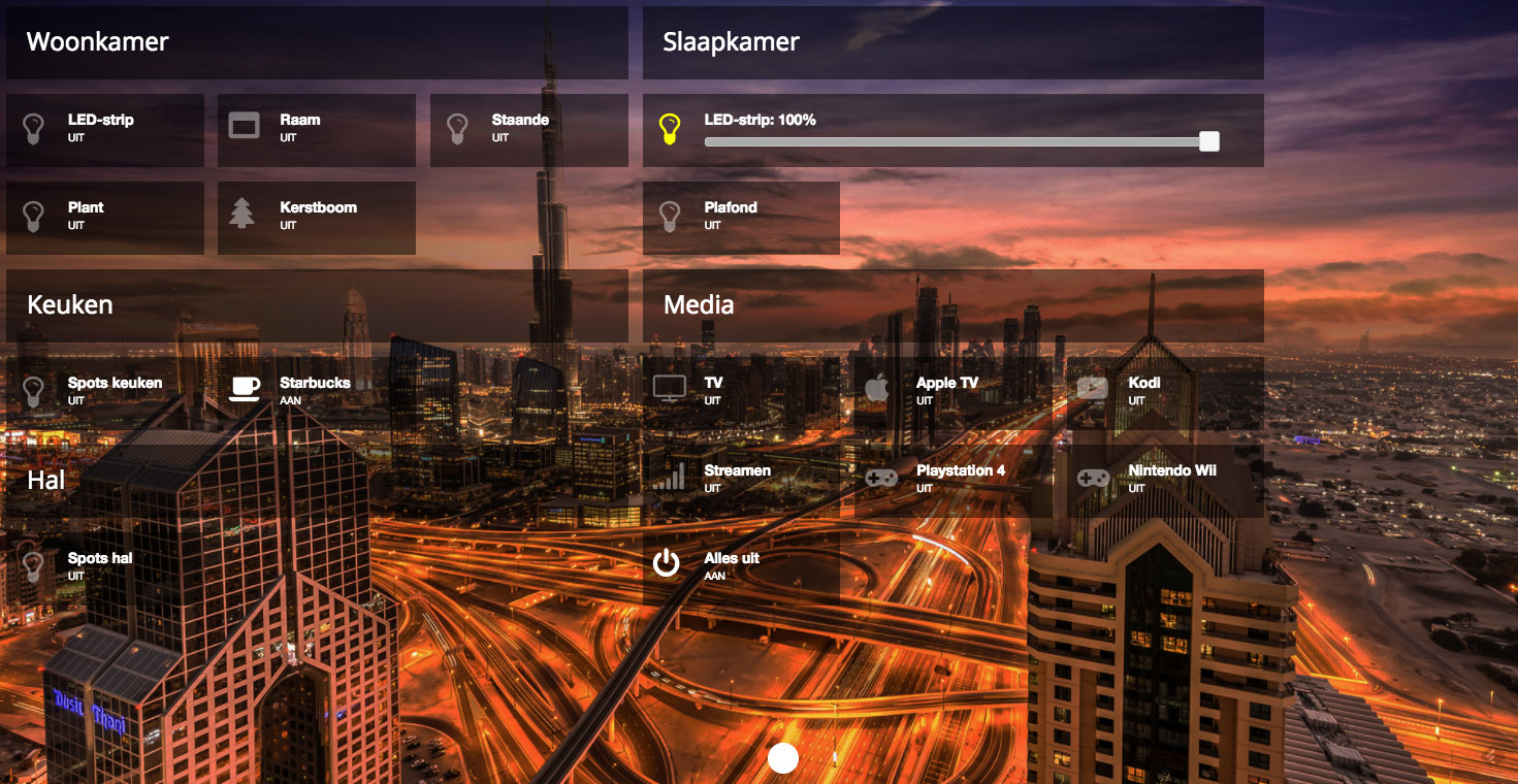

Again: loving this dashboard & development!
Here's mine, just page 1. Page 2 contains just some buttons.
Config.js
var _LANGUAGE = 'nl_NL'; //or: en_US, fr_FR, hu_HU
var _HOST_DOMOTICZ = 'http://*.*.*.*';
var _DOMOTICZ_REFRESH = 5; //in seconds
var _HOST_ZIGGO_HORIZON = 'http://192.168.1.3/domoticz/switch_horizon.php'; //e.g. http://192.168.1.3/domoticz/switch_horizon.php';
var _APIKEY_WUNDERGROUND = '2616686425819479';
var _WEATHER_CITY = 'Apeldoorn';
var _WEATHER_COUNTRY = 'NL';
var _USE_AUTO_POSITIONING = true; //don't want to configure positions, use auto positioning
var _HIDE_SECONDS_IN_CLOCK = false; //do not show the seconds in the clock
var _NEWS_RSSFEED = 'http://www.nu.nl/rss/algemeen';
var _USE_BEAUFORT = false; //Bft instead of m/s
var _SHOW_LASTUPDATE = false;
var _SCREENSLIDER_EFFECT = 'slide'; //'slide' or 'fade' or 'cube' or 'coverflow' or 'flip'
var _APIKEY_MAPS = '';
var _MAPS_LATITUDE = '';
var _MAPS_LONGITUDE = '';
var buttons = {}
buttons.buienradar = {width:12, isimage:true, refreshimage:60000, image: 'http://api.buienradar.nl/image/1.0/Rada ... =285&h=256', url: 'http://www.weeronline.nl/Europa/Nederla ... rn/4057517'}
buttons.nzbget = {width:4, icon: 'fa-download', title: 'NZBget', url: 'http://192.168.1.3:6789'}
// http://fontawesome.io/cheatsheet/
var screens = {}
screens[1] = {}
screens[1]['background'] = 'bgr_dxb.jpg';
screens[2] = {}
screens[2]['background'] = 'bgr_dxb.jpg';
screens[2]['columns'] = [4,5,6]
var blocks = {}
// SCENES
blocks['s1'] = {}
blocks['s1']['title'] = 'Woonkamer';
blocks['s2'] = {}
blocks['s2']['title'] = 'Gaan slapen';
blocks['s2']['icon'] = 'fa-bed'
blocks[31] = {}
blocks[31]['title'] = 'Verwarming';
blocks[31]['image'] = 'heating.png';
blocks[33] = {}
blocks[33]['title'] = 'Temp / luchtvochtigheid';
// WOONKAMER
blocks[12] = {}
blocks[12]['title'] = 'Kerstboom';
blocks[12]['icon'] = 'fa-tree';
blocks[13] = {}
blocks[13]['title'] = 'Plant';
blocks[42] = {}
blocks[42]['title'] = 'Tafellamp';
// blocks[42] = {}
// blocks[42]['title'] = 'Tafellamp';
blocks[50] = {}
blocks[50]['title'] = 'Tafellamp';
blocks[17] = {}
blocks[17]['title'] = 'LED-strip';
blocks[18] = {}
blocks[18]['title'] = 'Raam';
blocks[18]['icon'] = 'fa-window-maximize';
blocks[19] = {}
blocks[19]['title'] = 'Staande';
blocks[22] = {}
blocks[22]['title'] = 'Spots hal';
// KEUKEN
blocks[14] = {}
blocks[14]['title'] = 'Spots keuken';
blocks[15] = {}
blocks[15]['title'] = 'Starbucks';
blocks[15]['icon'] = 'fa-coffee';
// SLAAPKAMER
blocks[21] = {}
blocks[21]['title'] = 'Plafond';
blocks[20] = {}
blocks[20]['title'] = 'LED-strip';
// MEDIA
blocks[24] = {}
blocks[24]['icon'] = 'fa-power-off'
blocks[24]['title'] = 'Alles uit';
blocks[25] = {}
blocks[25]['title'] = 'TV';
blocks[25]['icon'] = 'fa-tv'
blocks[26] = {}
blocks[26]['title'] = 'Apple TV';
blocks[26]['icon'] = 'fa-apple'
blocks[26] = {}
blocks[27] = {}
blocks[27]['title'] = 'Playstation 4';
blocks[27]['icon'] = 'fa-gamepad'
blocks[28] = {}
blocks[28]['title'] = 'Nintendo Wii'
blocks[28]['icon'] = 'fa-gamepad'
blocks[29] = {}
blocks[29]['title'] = 'Kodi';
blocks[29]['icon'] = 'fa-youtube-play'
blocks[30] = {}
blocks[30]['title'] = 'Streamen';
blocks[30]['icon'] = 'fa-signal'
blocks['blocktitle_1a'] = {}
blocks['blocktitle_1a']['type'] = 'blocktitle';
blocks['blocktitle_1a']['title'] = 'Scenes';
blocks['blocktitle_1b'] = {}
blocks['blocktitle_1b']['type'] = 'blocktitle';
blocks['blocktitle_1b']['title'] = 'Schakelaars';
blocks['blocktitle_1c'] = {}
blocks['blocktitle_1c']['type'] = 'blocktitle';
blocks['blocktitle_1c']['title'] = 'Media';
blocks['blocktitle_1d'] = {}
blocks['blocktitle_1d']['type'] = 'blocktitle';
blocks['blocktitle_1d']['title'] = 'Verwarming';
blocks['blocktitle_2wk'] = {}
blocks['blocktitle_2wk']['type'] = 'blocktitle';
blocks['blocktitle_2wk']['title'] = 'Woonkamer';
blocks['blocktitle_2me'] = {}
blocks['blocktitle_2me']['type'] = 'blocktitle';
blocks['blocktitle_2me']['title'] = 'Media';
blocks['blocktitle_2ke'] = {}
blocks['blocktitle_2ke']['type'] = 'blocktitle';
blocks['blocktitle_2ke']['title'] = 'Keuken';
blocks['blocktitle_2ha'] = {}
blocks['blocktitle_2ha']['type'] = 'blocktitle';
blocks['blocktitle_2ha']['title'] = 'Hal';
blocks['blocktitle_2sk'] = {}
blocks['blocktitle_2sk']['type'] = 'blocktitle';
blocks['blocktitle_2sk']['title'] = 'Slaapkamer';
blocks['news_2'] = {}
blocks['news_2']['feed'] = 'https://crossorigin.me/http://www.nu.nl/rss/Algemeen';
blocks['news_3'] = {}
blocks['news_3']['feed'] = 'https://crossorigin.me/http://www.nu.nl/rss/Sport';
var columns = {}
columns[1] = {}
'clock',
'currentweather',
buttons.buienradar,
buttons.nzbget]
columns[1]['width'] = 2;
columns[2] = {}
'weather',
'traffic',
'train',
'news_2',
'news_3'
columns[2]['width'] = 5;
columns[3] = {}
columns[3]['blocks'] = [
'blocktitle_1a',
's1',
's2',
'blocktitle_1b',
50,
14,
22,
'blocktitle_1c',
25,
26,
29,
30,
24,
'blocktitle_1d',
31,
33
columns[3]['width'] = 5;
columns[4] = {}
'blocktitle_2wk',
16,
17,
18,
19,
13,
12,
'blocktitle_2ke',
14,
15,
'blocktitle_2ha',
22
columns[4]['width'] = 5;
columns[5] = {}
columns[5]['blocks'] = [
'blocktitle_2sk',
20,
21,
'blocktitle_2me',
25,
26,
29,
30,
27,
28,
24
columns[5]['width'] = 5;
columns[6] = {}
columns[6]['width'] = 2;
//CUSTOM POSITIONING:
//defining wich blocks to show, de numbers represents the IDX of the device in Domoticz
//only define if you want to use a custom width instead of the default
//var blocks = {}
//blocks[1] = {}
//blocks[1]['width'] = 4; //1 to 12, remove this line if you want to use the default (4)
//blocks[1]['title'] = 'Living room' //if you want change the name of switch different then domoticz
//blocks[1]['icon'] = 'fa-eye'; //if you want an other icon instead of the default, choose from: http://fontawesome.io/cheatsheet/
//blocks[1]['image'] = 'bulb_off.png'; //if you want to show an image instead if icon, place image in img/ folder
//blocks[204] = {} //dimmer
//blocks[204]['width'] = 12;
//blocks[204]['title'] = 'Living room' //if you want change the name of switch different then domoticz
//blocks['blocktitle_1'] = {}
//blocks['blocktitle_1']['type'] = 'blocktitle';
//blocks['blocktitle_1']['title'] = 'Schakelaars';
//var columns = {}
//columns[1] = {}
//columns[1]['blocks'] = ['blocktitle_1',1,2,62,'144_2',204,248,295] //remark: idx 144 produces 2 blocks, so you can use: '144_1' and '144_2' (or of course, just 144 if you want one)
//columns[1]['width'] = 5;
//columns[2] = {}
//columns[2]['blocks'] = ['currentweather_big','weather',5,'144_1']
//columns[2]['width'] = 5;
//columns[3] = {}
//columns[3]['blocks'] = ['clock','sunrise','horizon','streamplayer',buttons.buienradar,buttons.radio,buttons.calendar,buttons.nunl,buttons.nzbget]
//columns[3]['width'] = 2;
//var columns_standby = {}
//columns_standby[1] = {}
//columns_standby[1]['blocks'] = ['clock','currentweather_big','weather']
//columns_standby[1]['width'] = 12;
//if you want to use multiple screens, use the code below:
//var screens = {}
//screens[1] = {}
//screens[1]['background'] = 'bg1.jpg';
//screens[1]['background_morning'] = 'bg_morning.jpg';
//screens[1]['background_noon'] = 'bg_noon.jpg';
//screens[1]['background_afternoon'] = 'bg_afternoon.jpg';
//screens[1]['background_night'] = 'bg_night.jpg';
//screens[1]['columns'] = [1,2,3]
//screens[2] = {}
//screens[2]['background'] = 'bg3.jpg';
//screens[2]['background_morning'] = 'bg_morning.jpg';
//screens[2]['background_noon'] = 'bg_noon.jpg';
//screens[2]['background_afternoon'] = 'bg_afternoon.jpg';
//screens[2]['background_night'] = 'bg_night.jpg';
//screens[2]['columns'] = [4,5,6]
Custom.css
CUSTOM CSS FILE
border: 7px solid rgba(255,255,255,0);
background: rgba(0,0,0,0.2);
/* Background blocks */
.transbg.col-xs-1,
.transbg.col-xs-2,
.transbg.col-xs-3,
.transbg.col-xs-4,
.transbg.col-xs-5,
.transbg.col-xs-6,
.transbg.col-xs-7,
.transbg.col-xs-8,
.transbg.col-xs-9,
.transbg.col-xs-10,
.transbg.col-xs-11,
.transbg.col-xs-12 {
padding-top:15px;
padding-bottom:15px;
background: rgba(0,0,0,0.5);
background-clip: padding-box;
.fa.fa-lightbulb-o.on {color: yellow}
.fa.fa-lightbulb-o.dim {color: yellow}
.fa.fa-tree.on {color: green}
.fa.fa-tv.on {color: green}
.fa.fa-apple.on {color: green}
.fa.fa-gamepad.on {color: green}
.fa.fa-youtube-play.on {color: green}
.fa.fa-signal.on {color: green}
.fa.fa-home.on {color: green}
.fa.fa-home.off {color: red}
.fa-lightbulb-o:before{font-size: 36px;}
.fa-print:before{font-size: 36px;}
.fa-home:before{font-size: 36px;}
.col-data .title {font-size:14px;}
.col-data span {font-size:10px;}
.standby .clock{font-size:60px !important;}
.standby .weekday,.standby .date{font-size:40px !important;}

rick82 wrote:Again: loving this dashboard & development!
VERY NICE !
please update your post with the config-files so we can see how you did it.

Post by pkrabben »
config.js
var buttons = {}
var blocks = {}
blocks[110] = {}
var columns = {}
columns[1] = {}
columns[2] = {}
blocks[109] = {}
columns[4] = {};
columns[6] = {};
custom.css
CUSTOM CSS FILE
    color: #F1C300;
    color: #fff;
.fa.fa-plug.on {
    color: #F1C300;
.fa.fa-plug.off {
    color: #fff;
div [class$="_2"] {
    display: none;
div [class$="_3"] {
    display: none;
Can I ask where you found the motion icons (moving man) I cant find then in the icon gallery
thanks in advance for your reply
