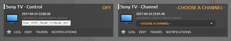

Just released a new version. Available on https://github.com/gerard33/sony-bravia.
* Added Netflix to the Sources device
* When playing the Netflix app, this is also shown on the Status device (there is no app information available from the API, so it will always show Netflix)
* Added a device from which you can start/stop/pause
* Added a device with a channel list
--You can choose channels 1-9. Just rename CH1, CH2 etc. to your channel names in the selector switch (keep --Choose a channel-- in place)

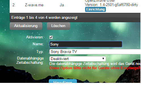

I have added the setPowerStatus command.Monki77 wrote:Nice plugin!
X8509C Android TV here.
My findings are -
Source seems to work fine.
EPG data works fine - Reports what is on TV
Volume doesn't work (as mentioned by others) but muting and reporting of volume does work.
The TV Remote button doesn't do anything (Not sure what it's supposed to do).
The TV does turn off, but will not turn on (I use WIFI, and a quick look at your script shows you use WOL, so i'm out of luck)
What i use to turn the TV on via wifi is an adapted version of another script made by StefanPuntNL (pasted it at the end of my post)
i just added this part -
jsonbodypoweron = '{\\"id\\":2,\\"method\\":\\"setPowerStatus\\",\\"version\\":\\"1.0\\",\\"params\\":[{ \\"status\\" : true}]}'
and then i edited the rest of the script accordingly.
I don't know if this only works for android TVs or not though...
Here's the full On/Off script (it does pull info from another script which pings my TV)
Please remove your TV from the Hardware tab, update to the latest version on Github and add the Hardware again (after a restart of Domoticz).
Then replace the MAC address with "Android" (case sensitive).
That should use the setPowerStatus = True command.
Let me know if it works.

Hey, i got some problems, to get the plugin working...
Python is installed and I'm on the last beta of Domoticz. In the log I see no Problem with Python, too.
Under Hardware I see the Sony Bravia, if i select it and click on add, it does nothing, if I don't use a name, i get the message, that i have to put a name in, so i think domoticz is not the problem. Every other device will work, too.
I try "localtest.py" on ssh - this will don't work - permission denied - but i think there is a problem with the PSK key, mac and ip is ok
Any idea?
Any idea?

in Domoticz i see no Fields for IP adress, PSK and so on - look the attachment
- sony.png (129.03 KiB) Viewed 4737 times
