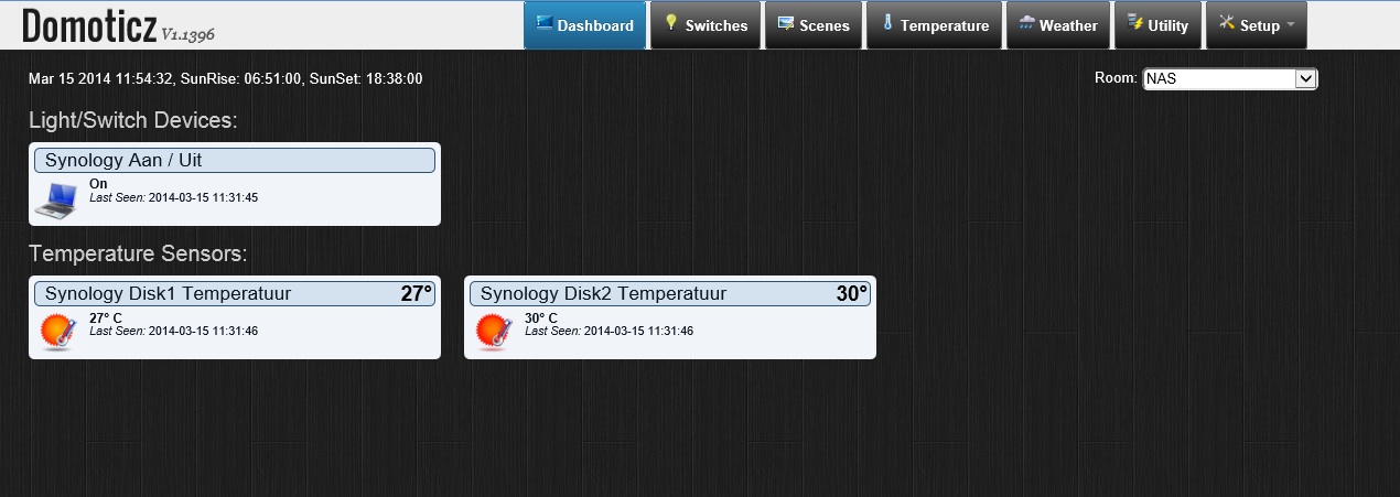

hmz...ok, i added a dummy device just like i added my rfxcom
but from there on i am lost.
i presume the ID's in the script are the IDX="15" etc.
what do i have to add more?
sorry for all the questions, started with my RBpi and domoticz two days agoo, still a lot to learn

The dummy switch devices must be added at the dummy hardware
Make temprate dummys and a switch on the switch page and add a switch witch protocol that isnt used thats the indicator for the nas is on or not and the temprature is for the free space and temp of the hd.s

Finally!
Thanks bigdog...
Now I know where I went wrong.
I had to adjust the nas.sh so the IDX in the device tab, will match the one in nas.sh
Temperature and power are working now.
Next step is free space and the cronjob to work!!

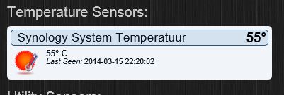

well ok, still have some strange issues.
free space is not giving the right counters so still have to adjust that:shock:
so still try to get that ok.
for those who also want the system temp in domoticz
ofcourse you need to put de IDX code on top where the other codes are
if someone can help me with the code for power consumption (in Watt)
# Temperature SYSTEM .1.3.6.1.4.1.6574.1.2.0
SYStemp=`snmpget -v 2c -c $PASSWORD -O qv $NASIP .1.3.6.1.4.1.6574.1.2.0`
# Send data
curl -s -i -H "Accept: application/json" "http://$DOMO_IP:$DOMO_PORT/json.htm?type=command¶m=udevice&idx=$NAS_SYS_TEMP_IDX&nvalue=0&svalue=$SYStemp"
NAS_SYS_TEMP_IDX="44" #NAS SYSTEM Temp IDX
