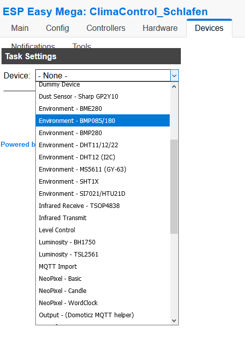

In the devices tab I cannot configure whats shon on your screenshot. there are some environmental sensortypes, but no one for gas ...
Perhabs wrong image ... do I need to compile with testing modules ...
=> You need to compile "TESTING" // I was using wrong files to compile the bin .... //

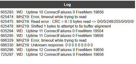

OK. Sorry. I followed your link but on the website I switched to "releases" and then indeed downloaded the "original" firmware.
I know did flash your version .... fianlly .. but still getting the error "ConnectFailures 0 FreeMem 21704"
Also under devices there are no values shown ...
By the way .. I often read that the MH-Z19b should be connected to 5Volt .. manual shows 3.3V and 5V is possible. Actually I have connected to 3.3V.

Looking at the log there indeed seems to be an issue with getting the information from the mhz19.
I have no experience with that as it simply worked for me as I have detailed in my post.
Had a quick look in the manual for the MH-Z19b regarding your comment about 5v and it states:
... this of course is valid for the b version only!
Jos

OK. Tried with 5V but do not get any results either.
And you are still sure with the pin connection, since I have read also different pins to use with MH-Z19B.
"Assembling
Connect the following:
MH-Z19 Tx → Wemos pin D8
MH-Z19 Rx → Wemos pin D7
MH-Z19 gnd → Wemos gnd pin
MH-Z19 vcc → Wemos 3.3V pin // 5.0V pin
And also GPIOs are GPIO14 and GPIO12 ...?
===> After changing GPIO Device Settings to 1st GPIO:15 (D8) and 2nd GPIO:13 (D7) it is working ... I get values for PPM and Temp!
Can`t figure out the problem. Anything else I have to adjust within the WEMOS D1?
