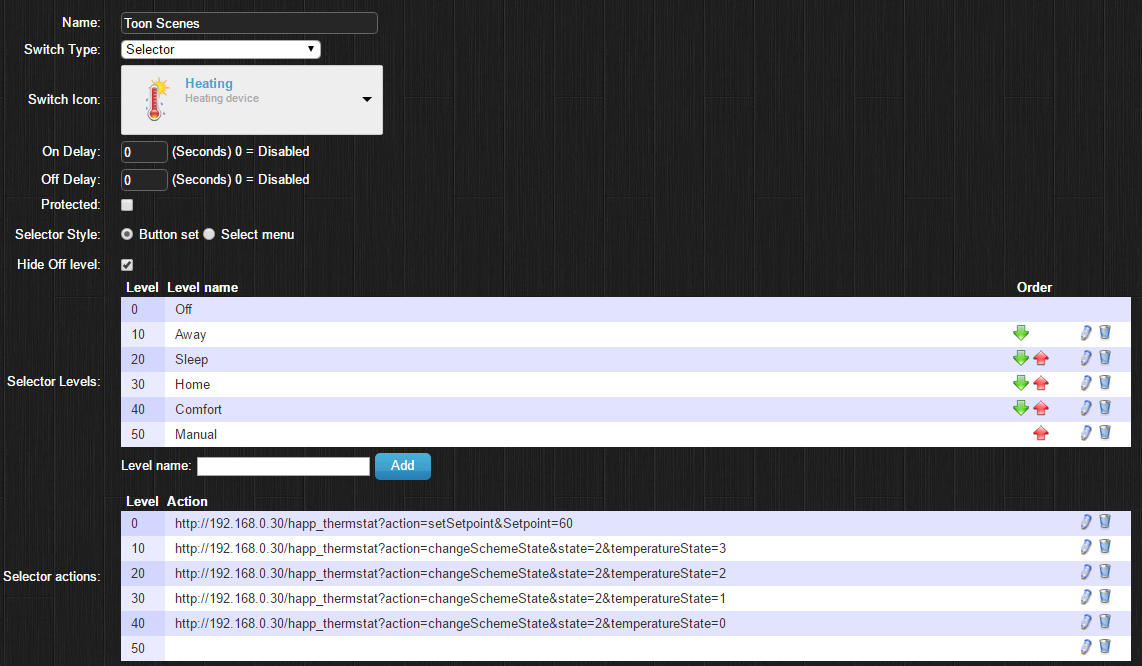

Nope, i have started to read from 1st message from Maes, start with creating variables (7 rows) start to create the first device Toon Thermostaat > dummy Sensor type selector switch Toon scenes, switch type selector fill in levels and the switch on the screen works, but of course nothing happened.
Read the other 47 messages but none gives names of the scripts and where to put them (? more options events but there is already a lua script of 51 rows).

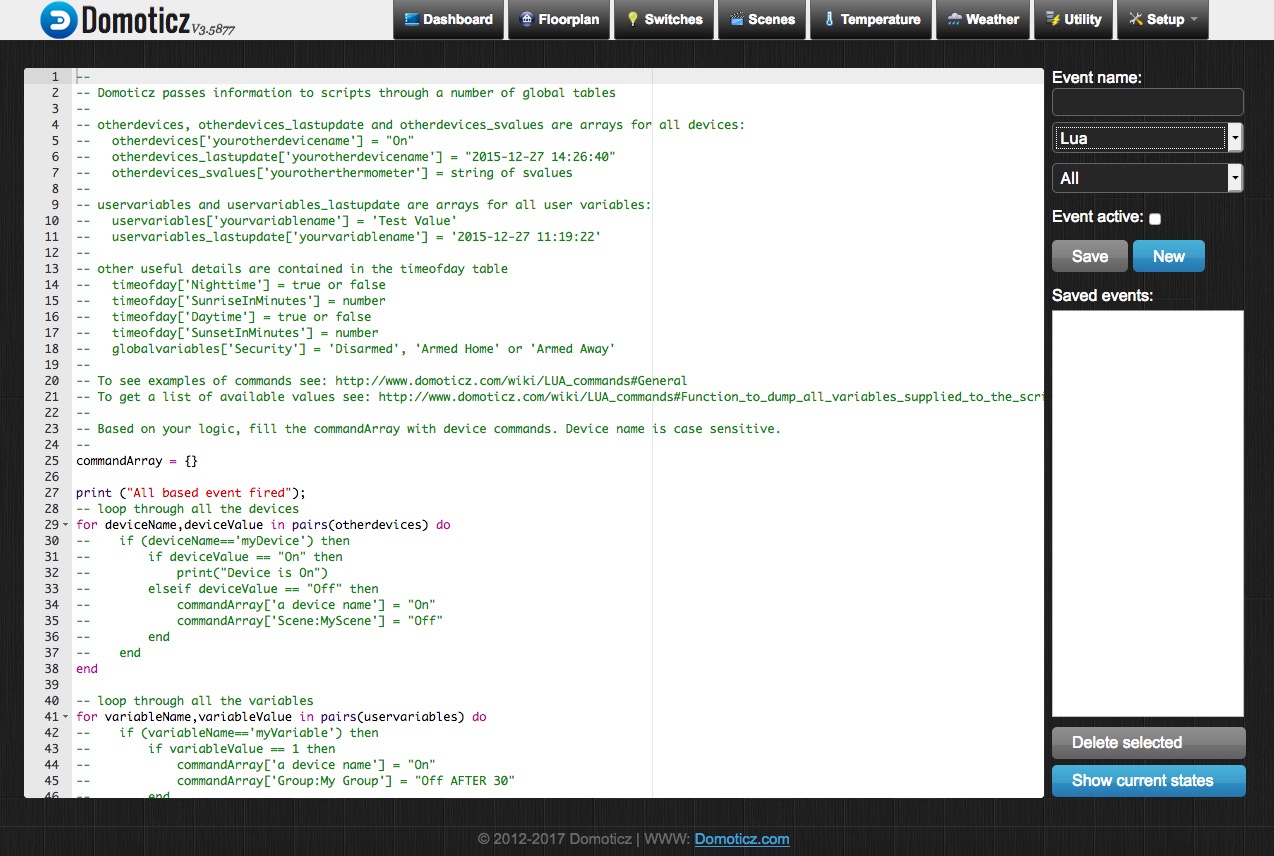

Yes but even this wiki don't tell me where to put the script (and the script is different from the scripts from Maes)
There is already a script on Setup > More Options > Events see picture. So how to put the new scripts in it?
existing script in Domoticz
Schermafbeelding 2017-09-19 om 16.27.43.jpg (262.82 KiB) Viewed 3731 times
Re: Controlling Toon [HACKED] from Domoticz
Posted: Tuesday 19 September 2017 17:01
by EdwinK
That is just an example. Remove it and paste the script from the wiki in it.

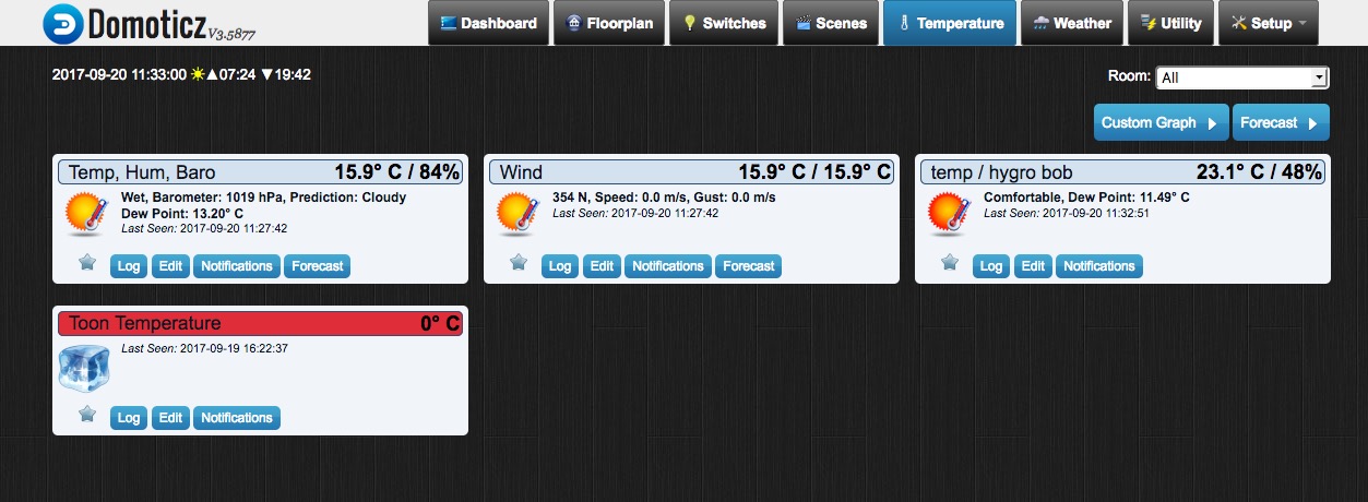

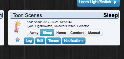

Now i got a temperature on Toon temperature also no error But when i go to Toon Scenes and change the setting from home (thats the setting on de day normal so now) to by example away or sleep, it change after a few seconds to home.
Also on the ToonThermostaat script
Error: EventSystem: in ToonThermostaat: [string "-- Script used for Toon Thermostaat utility d..."]:8: bad argument #1 to 'pairs' (table expected, got nil)
And when i push on the flame at dummy Toon Thermostat, i got 2 arrows but after a few seconds after changing setpoint the setpoint is back on the original temperature.
So finally only the temperature sensor is really working the event switches and the thermostat ar reset after a few seconds.

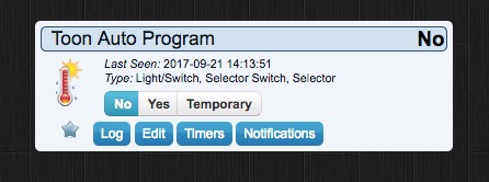

Posted: Thursday 21 September 2017 14:22
by walberg
walberg wrote: Wednesday 20 September 2017 16:05 Now i got a temperature on Toon temperature also no error But when i go to Toon Scenes and change the setting from home (thats the setting on de day normal so now) to by example away or sleep, it change after a few seconds to home.

I have installed this too, but when i change the temperature on Toon Thermostaat the temperature stays the same. Also when i change one of the events, after a few seconds the setting is reset the the original state Only Toon Temperature is working but of course it is a one way from Toon to Domoticz.
All the other reads Toon but from Domoticz you can not change anything.
