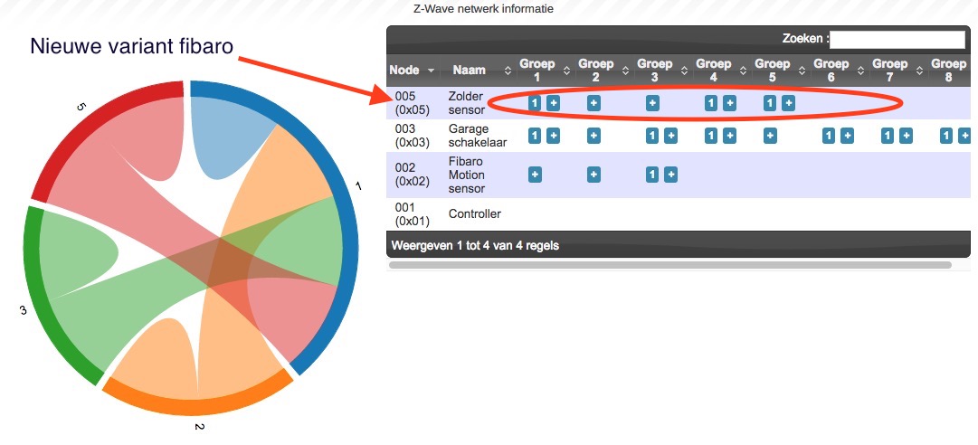

I got it working. (finally).
I had to assign the groups correctly because i did not use security i had to do this:
If you don't care security you can assign only the group 1,4 and 5 with the controller and now the sensor behaves like the old version sensor.
For group changes you have to take in mind that this can take several hours. So be patient.
Ofcourse you also need to add the new .xml file as discussed before this reply.
I now have lux, temp, and motion sensor working in domoticz.
- the new and the old fibario motion sensor in group overview
- Schermafbeelding 2017-01-24 om 09.46.09.jpg (93.31 KiB) Viewed 863 times
