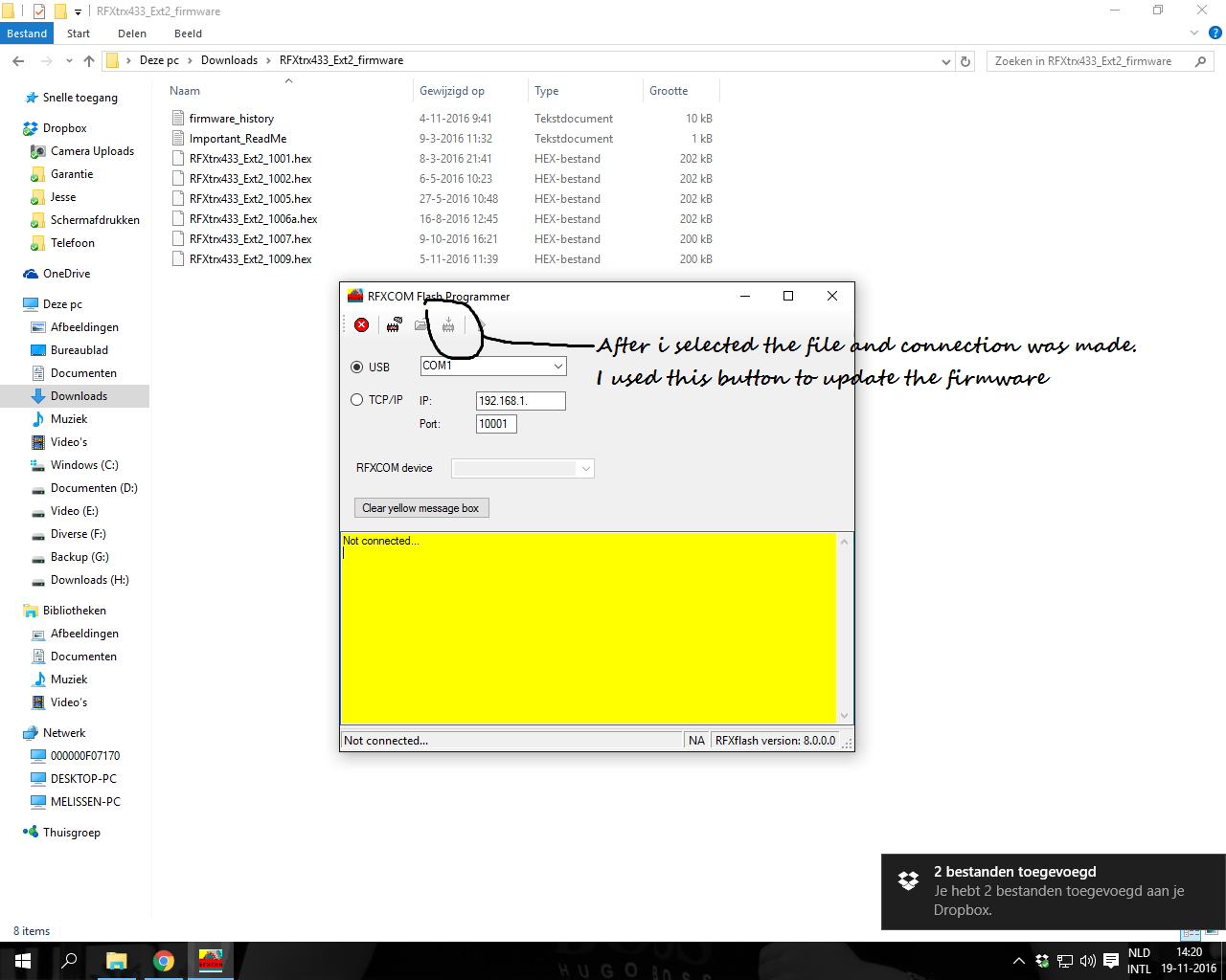

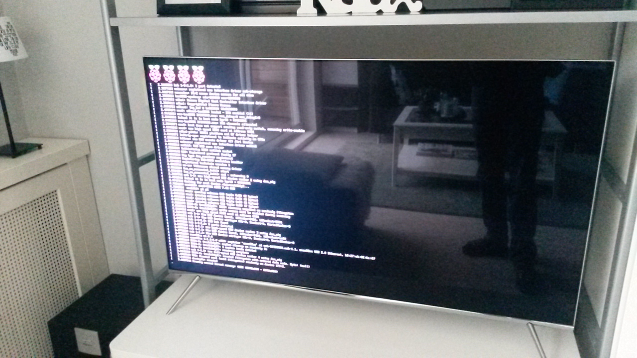

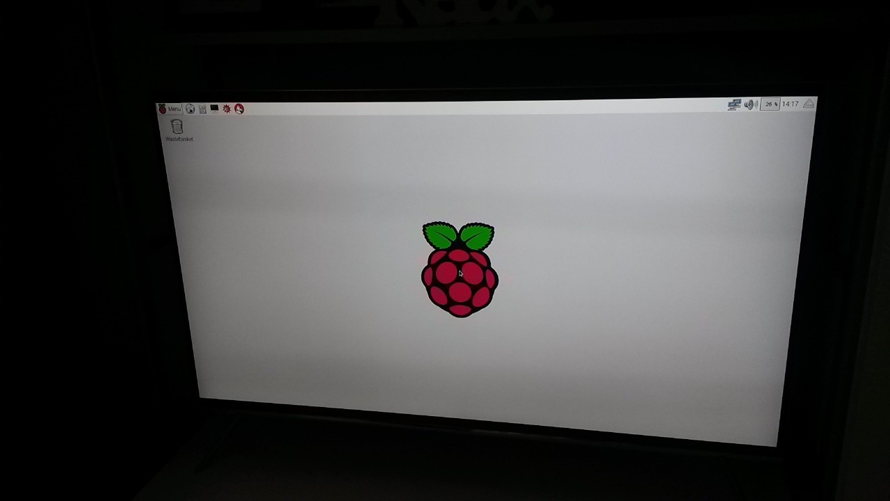

- 20161119_142024.jpg (116.49 KiB) Viewed 2392 times
- 20161119_142007.jpg (323.04 KiB) Viewed 2392 times
- Schermafdruk 2016-11-19 14.20.47.png (133.24 KiB) Viewed 2392 times

Yeah... after updating the firmware to 1009.hex, it does work.
Now I have to figure out how to update the domoticz from v3.4834 to 5877
