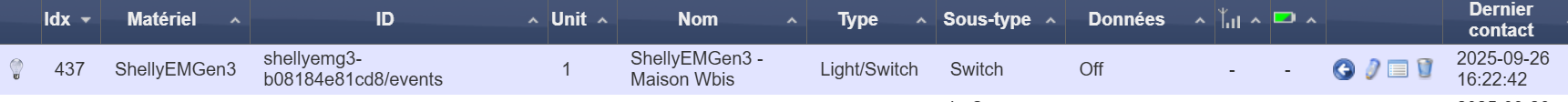

but it creates only one device that is not a power meter device:
I tried to put more verbose debug messages, but it's cryptic to me:

Type 244, subtype 73, switchtype 0 is an on/off switch.
To get a kWh device, use 243/29/0

I think I need to use the following topic : "shellyemg3-b08184e81cd8/events/rpc" (was missing "rpc") but then I have error in the log (at least it receives something):
2025-09-26 20:52:55.011 ShellyEMGen3: onMQTTPublish found shellyemg3-b08184e81cd8/events/rpc, Device 'ShellyEMGen3 - Maison Wbis', message '{'src': 'shellyemg3-b08184e81cd8', 'dst': 'shellyemg3-b08184e81cd8/events', 'method': 'NotifyStatus', 'params': {'ts': 1758912779.39, 'em1:0': {'act_power': 397.7, 'aprt_power': 619.5, 'current': 2.583, 'freq': 50.0, 'pf': 0.74, 'voltage': 243.1}}}'
2025-09-26 20:52:55.012 Error: ShellyEMGen3: Can't find >0'< in >'{'src': 'shellyemg3-b08184e81cd8', 'dst': 'shellyemg3-b08184e81cd8/events', 'method': 'NotifyStatus', 'params': {'ts': 1758912779.39, 'em1:0': {'act_power': 397.7, 'aprt_power': 619.5, 'current': 2.583, 'freq': 50.0, 'pf': 0.74, 'voltage': 243.1}}}<, message ignored
2025-09-26 20:52:55.064 ShellyEMGen3: onMQTTPublish found shellyemg3-b08184e81cd8/events/rpc, Device 'ShellyEMGen3 - Maison Wbis', message '{'src': 'shellyemg3-b08184e81cd8', 'dst': 'shellyemg3-b08184e81cd8/events', 'method': 'NotifyStatus', 'params': {'ts': 1758912778.39, 'em1:1': {'act_power': 0.0, 'aprt_power': 4.9, 'current': 0.02, 'freq': 50.0, 'pf': 0.0, 'voltage': 243.0}}}'
2025-09-26 20:52:55.065 Error: ShellyEMGen3: Can't find >params/em1:0/act_power'< in >'{'src': 'shellyemg3-b08184e81cd8', 'dst': 'shellyemg3-b08184e81cd8/events', 'method': 'NotifyStatus', 'params': {'ts': 1758912778.39, 'em1:1': {'act_power': 0.0, 'aprt_power': 4.9, 'current': 0.02, 'freq': 50.0, 'pf': 0.0, 'voltage': 243.0}}}<, message ignored
2025-09-26 20:
So I guess it is a mapping error, but it is not trial to find the right mapping
darrepac
Posts: 142
Joined: Tuesday 04 February 2014 21:31
Location: Isère, France
Re: Python Plugin: MqttMapper
Post by darrepac »
Found the mistake: need a "~" before the 0
    "Maison Wbis": {
        "topic": "shellyemg3-b08184e81cd8/events/rpc",
        "type": "243", "subtype": "29", "switchtype": "0",
        "mapping": {"item": "params/em1:0/act_power;~0"},
        "options": {"EnergyMeterMode": "1"}
So now the log sounds good but I don't still have any value in the device itself (but the update_timestamp change!):
2025-09-26 21:21:03.147 ShellyEMGen3: onMQTTPublish found shellyemg3-b08184e81cd8/events/rpc, Device 'ShellyEMGen3 - Maison Wbis', message '{'src': 'shellyemg3-b08184e81cd8', 'dst': 'shellyemg3-b08184e81cd8/events', 'method': 'NotifyStatus', 'params': {'ts': 1758914471.57, 'em1:0': {'act_power': 399.7, 'aprt_power': 635.7, 'current': 2.641, 'freq': 50.0, 'pf': 0.73, 'voltage': 243.9}}}'
2025-09-26 21:21:03.148 ShellyEMGen3: Setting ShellyEMGen3 - Maison Wbis to >399.7;0<
2025-09-26 21:21:03.148 (ShellyEMGen3 - Maison Wbis) Updating device from 404:'' to have values 0:'399.7;0'.
