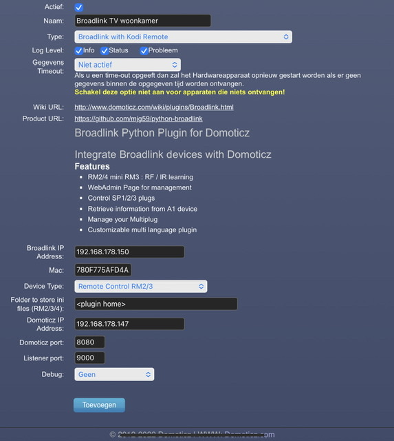

NB !!
I have created two Broadlink hardware components, one for the Slaapkamer tv and one for the Woonkamer tv.
I noticed that the error at startup only happens randomly for one tv. In the above only for the Woonkamer tv.
The startup for the Slaapkamer tv does not give any problem. However at a next reboot the error could come for the Slaapkamer tv.

I have two Broadlink devices, one in front of the Woonkamer tv and one in front of the Slaapkamer tv.
Both do work fine. Only have after reboot to deactivate and then to activate the hardware of the Broadlink which gave the error.

A suggestion: could the problem be caused by the fact that two hardwares, one for the Slaapkamer broadlink device and one for the Woonkamer
Broadlink device are use the same plugins/broadlink directory and maybe a simultaneous start by Domotics of the two hardwares does cause the error ?

Is there anybody who has two or more Broadlink devices connected succesfully to Domoticz on a Raspberry pi using the plugin created by Zak45?
My feeling is that having two Broadlink hardware devices defined in Domoticz, using the same plugins/Broadlink directory is causing problems.
