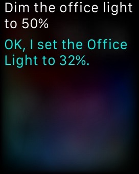

Yes I have a similar problem to the above, which I have tested just now, by asking Siri to set my office light to 50%. It replied with "Ok, I set the Office Light to 32%", and Domoticz reports the light as being set to 29%, so something is amiss here.
Another thing I am wanting to find out, is how I can differentiate blinds from lights. At the moment I have to ask it to set blinds to "on" and "off" rather than "open" and "close", as I would prefer. I believe I would need to set these devices as "shades" rather than "lights" within Eve, but as the devices are all discovered automatically, due to me using a roomplan, I'm not sure how to go about this - any ideas?

Further to the above, if I try and set a light to anything above 32%, Siri reports it as 32% and the logs show the level as 10:
EventedHTTPServer [192.168.1.173] HTTP Repsonse is finished +6ms
[Domoticz] Office Light sent command setLevel (value: 10)

Ok I'm with you now, so the problem is not setting the level but that the level is not being reported correctly in the other direction? It's possible there's a similar bug, I will take a look.Bikey wrote:Thanks for checking this:
As reported earlier, for my KaKu RFXCom dimmers, Domoticz returns: "MaxDimLevel" : 15
See the complete API-resultThis lamp can be dimmed properly via the Domoticz API with json.htm?type=command¶m=switchlight&idx=8&switchcmd=Set%20Level&level=x
- Spoiler: show
With x = levels between 1 and 16
So Domoticz is reporting the MaxDimlevel = 15 and can be controlled by values between 1 and 16.
If however I look at the Elgate Eve App it only reports a max percentage of 15%! So for some reason the server does not do the conversion from 15 to 100%
EDIT:
I'm not a coder but to me it looks like the MaxDimValue as reported to Siri is not converted to a percentage, it is only converted the other way around: from Siri percentage to a level-value for Domoticz. Could that be the bug?
EDIT2:
If MaxDimlevel=15 the range of values that has to be send to Domoticz must be between 1 and 16!
I still think it's a bug on the Domoticz side that it accepts levels between 1-16 if it's max dim level is 15 though.
