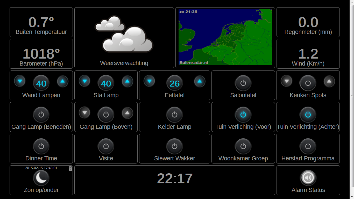

Found it. Going to try to get the button the way I want it

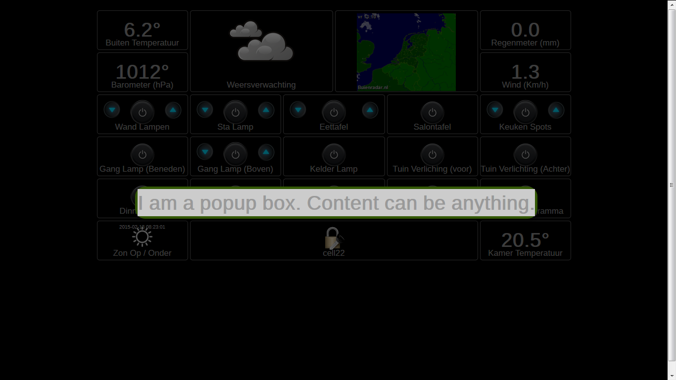

Great...mvveelen wrote:Found it. Going to try to get the button the way I want it
Just started working on the popup.
This how i got it now.
Click the lock and the popup appears on screen.
Now let e see if i can include the secpanel as i want it to...

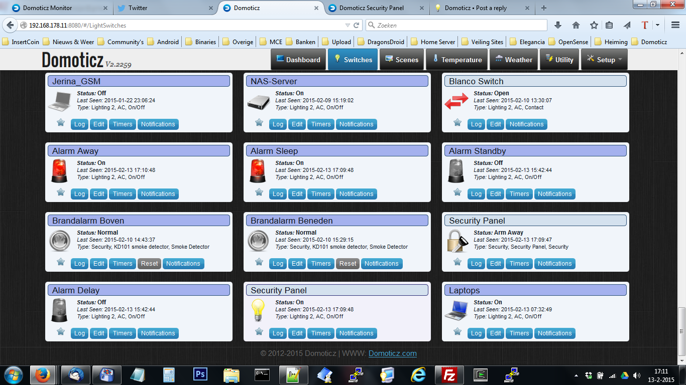

Hmmm...problem with the 'Status' of the alarm-switch is that it isn't a real switch that changes the status to On or Set or Armed or anything else. It only gives me the status 'Normal'. Setting the alarm doesn't change anything.

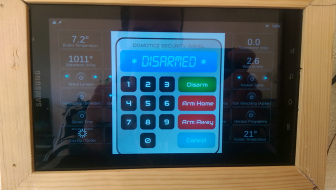

Implanted your stuff to see if it worked on my 7" tablet.
It does popup up and seems like it does work.
Could be my tablet but loading takes a few seconds.

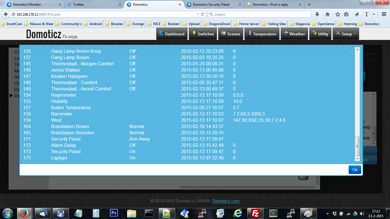

it does..mvveelen wrote:That has to do with the general code that is used when you click on a switch. That might be something to solve, but I first tried what you did....I've tried your setup with using a virtual switch, but it never turns ON. It only shows the OFF in the log file and not the ON status. Does it show the ON in your setup?
2015-02-13 17:09:47.782 Event: triggered: Inbraak Secpanel Sleep_1
2015-02-13 17:09:47.787 Event: triggered: Inbraak Secpanel Away_1
2015-02-13 17:09:47.795 Event: triggered: test_3
Fri Feb 13 17:09:47 2015 (System) Domoticz Security Status
2015-02-13 17:09:48.121 (Alarm Home_Sleep) Lighting 2 (Alarm Sleep)
2015-02-13 17:09:48.166 (Security Panel) Lighting 2 (Security Panel)- Attachments

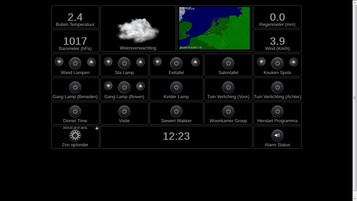

I've managed to get a cell with a button for the security panel. When you click on it, a pop-up appears where you can enter the code to arm or disarm the alarm. The status of the alarm will be shown in the cell by changing the image (I will make another, nicer image when I find the time for it). When you click near the pop-up, the pop-up will disappear again
There is only one thing I can't find: the border of the cell is a bit brighter than all other borders. I want this to be the same color of course. If someone can find the solution for this
A temporary download link for this can be found here: LINK

Thx...mvveelen wrote:I've managed to get a cell with a button for the security panel. When you click on it, a pop-up appears where you can enter the code to arm or disarm the alarm. The status of the alarm will be shown in the cell by changing the image (I will make another, nicer image when I find the time for it). When you click near the pop-up, the pop-up will disappear again
There is only one thing I can't find: the border of the cell is a bit brighter than all other borders. I want this to be the same color of course. If someone can find the solution for this?
Didn't think of that, i mean href-ing the cell.
For this does the trick.
As for you cell border, maybe it's me or my display.
But i can't see any color change.
- Naamloos.png (220.12 KiB) Viewed 4178 times

Are you using exact the same .css files? Because, as you can see, I do have a slightly brighter 'Alarm-cell'

That could be the issues.mvveelen wrote:I've checked in another browser and it seems fine. So: in Safari it has a slightly brighter border, but in Firefox it is OK
Not all browsers are inserting values the same.
I use firefox on laptop and tablet.
But just in case i will attach my frontpage here for you to look at.
For those who are interested.
Be aware the layout is adjusted to fir my 7" tablet.
I made some slight changes.
1. Added auto refresh of 4min in frontpage.html te reflect the buienradar screenshot to the current condition
2. Adjusted the weather icon layout to reflect your dusk sensor, it will now show the sun and moon according to the light condition
3. As per mvveelen his frontpage the Outside temperature text is colored blue when temp is below 0 degrees
4. Outside temperature text will color red when temp is 25 degrees or above
5. Changed Lock and unlock switch icon
6. Changed Alarm Status button which reflects the current alarm status
7. Changed Weather icons to HTC Sense 4 Weather Icons
Download: (temporally)
https://dl.dropboxusercontent.com/u/232 ... moticz.zip

I see you actually use the same kind of code to use the day or night icons as I uploaded
, but if you ask me, the way I use it with the Sunrise or Sunset is better because my dusk sensor will turn on the lights when there is a thunderstorm for example, and in your code it will then show the night-icons. That doesn't seem right does it
The alarm button is nearly the same as I had, but it doesn't really look smooth enough. I'm going to try to get a similar icon as the others.
Here I go again: wouldn't it be great if someone actually could get the Skycons to work with this frontpage.....

I understand but my Sunrise/Sunset is triggered by a virtual switch and my dusksensor is set to very dark.mvveelen wrote:I see you actually use the same kind of code to use the day or night icons as I uploaded, but if you ask me, the way I use it with the Sunrise or Sunset is better because my dusk sensor will turn on the lights when there is a thunderstorm for example, and in your code it will then show the night-icons. That doesn't seem right does it
Here I go again: wouldn't it be great if someone actually could get the Skycons to work with this frontpage.....?
My setup doesn't trigger that fast.
I tried your code but then my frontpage didn't load anything and i would end up with a blank page.
Will make adjustment in the future to change it according realtime sunrise/sunset time.
The Alarm icon doesn't look smooth indeed.
Tomorrow i will play with those icons to make them smoother
