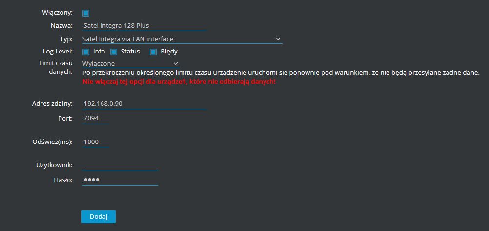

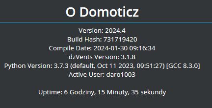

Hello
I have the following problem: constant errors in the logs.
Since I have Domoticz and integration with Satel Integra, and for 2 years now, I have had errors in the Domoticz logs.
What could be the reason for this?
I also noticed that sometimes Domoticz does not work well because it probably does not receive the appropriate information from Satel Integra and does not turn off the light, but this happens very rarely.

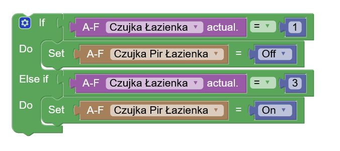

Integration based on
Satel sends commands from sensors 1 / 3 I use the block to change from 1 to OFF from 3 to ON

}Integration based on

2024-06-13 08:29:33.117 Error: Alarm Integra: Receive info about zone 31 failed (probably zone is not used)
2024-06-13 08:29:33.319 Error: Alarm Integra: bad data length received (totalRet 7)
2024-06-13 08:29:33.319 Error: Alarm Integra: Receive info about zone 32 failed (probably zone is not used)
2024-06-13 08:29:33.521 Error: Alarm Integra: bad data length received (totalRet 7)
2024-06-13 08:29:33.521 Error: Alarm Integra: Receive info about zone 33 failed (probably zone is not used)
2024-06-13 08:29:33.723 Error: Alarm Integra: bad data length received (totalRet 7)
2024-06-13 08:29:33.723 Error: Alarm Integra: Receive info about zone 34 failed (probably zone is not used)
2024-06-13 08:29:33.925 Error: Alarm Integra: bad data length received (totalRet 7)
2024-06-13 08:29:33.925 Error: Alarm Integra: Receive info about zone 35 failed (probably zone is not used)
2024-06-13 08:29:34.147 Error: Alarm Integra: bad data length received (totalRet 7)
2024-06-13 08:29:34.147 Error: Alarm Integra: Receive info about zone 36 failed (probably zone is not used)
2024-06-13 08:29:34.349 Error: Alarm Integra: bad data length received (totalRet 7)
2024-06-13 08:29:34.349 Error: Alarm Integra: Receive info about zone 37 failed (probably zone is not used)
2024-06-13 08:29:35.154 Error: Alarm Integra: bad data length received (totalRet 7)
2024-06-13 08:29:35.154 Error: Alarm Integra: Receive info about zone 40 failed (probably zone is not used)
2024-06-13 08:29:35.356 Error: Alarm Integra: bad data length received (totalRet 7)
2024-06-13 08:29:35.356 Error: Alarm Integra: Receive info about zone 41 failed (probably zone is not used)
2024-06-13 08:29:35.738 Error: Alarm Integra: bad data length received (totalRet 7)
2024-06-13 08:29:35.738 Error: Alarm Integra: Receive info about zone 42 failed (probably zone is not used)
2024-06-13 08:29:35.742 Error: Alarm Integra: bad data length received (totalRet 16)
2024-06-13 08:29:35.743 Error: Alarm Integra: Receive info about zone 43 failed (probably zone is not used)
2024-06-13 08:29:35.964 Error: Alarm Integra: bad data length received (totalRet 7)
2024-06-13 08:29:35.964 Error: Alarm Integra: Receive info about zone 44 failed (probably zone is not used)
2024-06-13 08:29:36.186 Error: Alarm Integra: bad data length received (totalRet 7)
2024-06-13 08:29:36.186 Error: Alarm Integra: Receive info about zone 45 failed (probably zone is not used)
2024-06-13 08:29:36.408 Error: Alarm Integra: bad data length received (totalRet 7)
2024-06-13 08:29:36.408 Error: Alarm Integra: Receive info about zone 46 failed (probably zone is not used)
2024-06-13 08:29:36.790 Error: Alarm Integra: bad data length received (totalRet 7)
2024-06-13 08:29:36.790 Error: Alarm Integra: Receive info about zone 47 failed (probably zone is not used)
2024-06-13 08:29:36.972 Error: Alarm Integra: bad data length received (totalRet 7)
2024-06-13 08:29:36.972 Error: Alarm Integra: Receive info about zone 48 failed (probably zone is not used)
2024-06-13 08:29:36.973 Error: Alarm Integra: bad data length received (totalRet 15)
2024-06-13 08:29:36.973 Error: Alarm Integra: Receive info about zone 49 failed (probably zone is not used)
2024-06-13 08:29:38.078 Error: Alarm Integra: bad data length received (totalRet 7)
2024-06-13 08:29:38.078 Error: Alarm Integra: Receive info about zone 53 failed (probably zone is not used)
2024-06-13 08:29:38.260 Error: Alarm Integra: bad data length received (totalRet 7)
2024-06-13 08:29:38.260 Error: Alarm Integra: Receive info about zone 54 failed (probably zone is not used)
2024-06-13 08:29:38.261 Error: Alarm Integra: bad data length received (totalRet 15)
2024-06-13 08:29:38.261 Error: Alarm Integra: Receive info about zone 55 failed (probably zone is not used)
2024-06-13 08:29:38.543 Error: Alarm Integra: bad data length received (totalRet 7)
2024-06-13 08:29:38.544 Error: Alarm Integra: Receive info about zone 56 failed (probably zone is not used)
2024-06-13 08:29:38.545 Error: Alarm Integra: bad data length received (totalRet 15)
2024-06-13 08:29:38.545 Error: Alarm Integra: Receive info about zone 57 failed (probably zone is not used)
2024-06-13 08:29:38.767 Error: Alarm Integra: bad data length received (totalRet 7)
2024-06-13 08:29:38.768 Error: Alarm Integra: Receive info about zone 58 failed (probably zone is not used)
2024-06-13 08:29:38.990 Error: Alarm Integra: bad data length received (totalRet 7)
2024-06-13 08:29:38.990 Error: Alarm Integra: Receive info about zone 59 failed (probably zone is not used)
2024-06-13 08:29:38.991 Error: Alarm Integra: bad data length received (totalRet 15)
2024-06-13 08:29:38.991 Error: Alarm Integra: Receive info about zone 60 failed (probably zone is not used)
2024-06-13 08:29:39.193 Error: Alarm Integra: bad data length received (totalRet 7)
2024-06-13 08:29:39.193 Error: Alarm Integra: Receive info about zone 61 failed (probably zone is not used)
2024-06-13 08:29:39.395 Error: Alarm Integra: bad data length received (totalRet 7)
2024-06-13 08:29:39.395 Error: Alarm Integra: Receive info about zone 62 failed (probably zone is not used)
2024-06-13 08:29:29.990 Error: Alarm Integra: bad data length received (totalRet 7)
2024-06-13 08:29:29.990 Error: Alarm Integra: Receive info about zone 17 failed (probably zone is not used)
2024-06-13 08:29:30.212 Error: Alarm Integra: bad data length received (totalRet 7)
2024-06-13 08:29:30.212 Error: Alarm Integra: Receive info about zone 18 failed (probably zone is not used)
2024-06-13 08:29:30.394 Error: Alarm Integra: bad data length received (totalRet 7)
2024-06-13 08:29:30.394 Error: Alarm Integra: Receive info about zone 19 failed (probably zone is not used)
2024-06-13 08:29:30.736 Error: Alarm Integra: bad data length received (totalRet 7)
2024-06-13 08:29:30.736 Error: Alarm Integra: Receive info about zone 20 failed (probably zone is not used)
2024-06-13 08:29:30.938 Error: Alarm Integra: bad data length received (totalRet 7)
2024-06-13 08:29:30.938 Error: Alarm Integra: Receive info about zone 21 failed (probably zone is not used)
2024-06-13 08:29:31.220 Error: Alarm Integra: bad data length received (totalRet 7)
2024-06-13 08:29:31.220 Error: Alarm Integra: Receive info about zone 22 failed (probably zone is not used)
2024-06-13 08:29:31.522 Error: Alarm Integra: bad data length received (totalRet 7)
2024-06-13 08:29:31.522 Error: Alarm Integra: Receive info about zone 23 failed (probably zone is not used)
2024-06-13 08:29:31.724 Error: Alarm Integra: bad data length received (totalRet 7)
2024-06-13 08:29:31.724 Error: Alarm Integra: Receive info about zone 24 failed (probably zone is not used)
2024-06-13 08:29:31.946 Error: Alarm Integra: bad data length received (totalRet 7)
2024-06-13 08:29:31.946 Error: Alarm Integra: Receive info about zone 25 failed (probably zone is not used)
2024-06-13 08:29:32.128 Error: Alarm Integra: bad data length received (totalRet 7)
2024-06-13 08:29:32.128 Error: Alarm Integra: Receive info about zone 26 failed (probably zone is not used)
2024-06-13 08:29:32.430 Error: Alarm Integra: bad data length received (totalRet 7)
2024-06-13 08:29:32.430 Error: Alarm Integra: Receive info about zone 27 failed (probably zone is not used)
2024-06-13 08:29:32.431 Error: Alarm Integra: bad data length received (totalRet 15)
2024-06-13 08:29:32.431 Error: Alarm Integra: Receive info about zone 28 failed (probably zone is not used)
2024-06-13 08:29:32.713 Error: Alarm Integra: bad data length received (totalRet 7)
2024-06-13 08:29:32.714 Error: Alarm Integra: Receive info about zone 29 failed (probably zone is not used)
2024-06-13 08:29:32.915 Error: Alarm Integra: bad data length received (totalRet 7)
2024-06-13 08:29:32.916 Error: Alarm Integra: Receive info about zone 30 failed (probably zone is not used)
2024-06-13 08:29:33.117 Error: Alarm Integra: bad data length received (totalRet 7)
