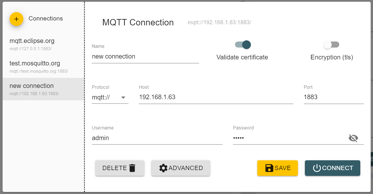

I tried installing mqtt explorer on my laptop. In the connection settings I entered the address of the rpi on which the mosquitto broker is installed. Hope that is the correct way to set it up. And I get the error "Connection refused, identifier rejected".
- Posts: 47
- Joined: Tuesday 24 November 2020 17:57
Re: Python Plugin: Shelly MQTT
Never mind, I uninstalled mqtt broker completely from raspbian. I have a concurrent Home Assistant install on the pi. Installed MQTT on that, which is almost a 1-click install, and that is broking the domoticz messages too.
