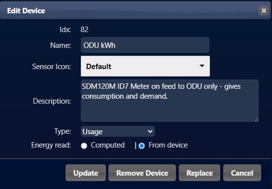

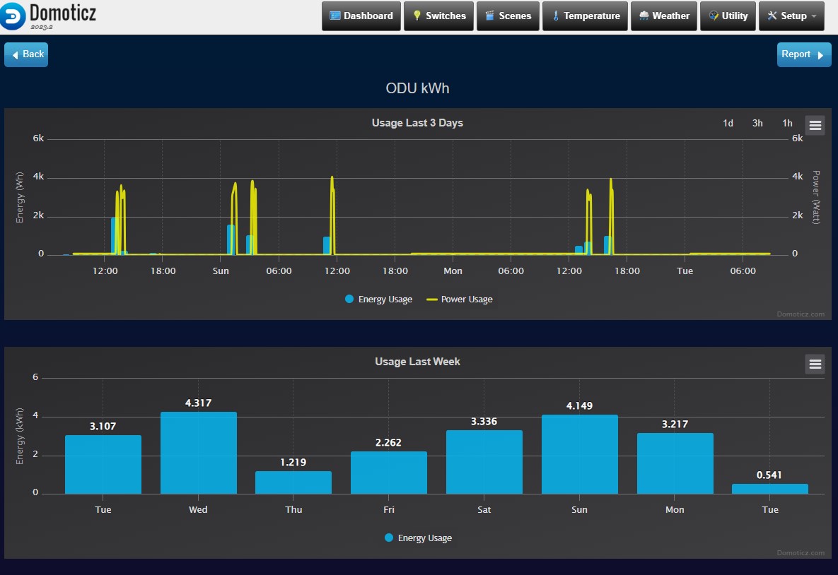

Like this ?
Its type 243 - Domoticz.Device(Name="Import Wh", Unit=2,Type=243,Subtype=29,Used=0).Create()
- Screenshot 2023-08-15 084930.jpg (110.11 KiB) Viewed 8972 times
- Screenshot 2023-08-15 084829.jpg (33.65 KiB) Viewed 8973 times
Raspberry Pi4, Sunny Boy 4000TL, Victron Multiplus II 10kw ESS, 44kWh LiFEPO4, Batrium BMS, NodeRED on Cerbo GX
