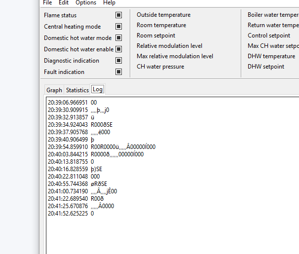

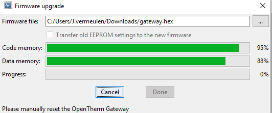

I have bought the otgw from
Nodo-shop.nl
And its working perfectly till now.
After addind the ch_pressure i starting to get trouble.
My otgw is reporting some weird characters so i would reflash the otgw.
Using otgw and windows 10 laptop (uses before for flassing so drivers etc are fine)
Now the otmonitor is reporting that the flashing is failing and i have to manually reset the opentherm gateway.
If anyone of you know how to reset this please let me know!

I don't know for sure what is meant, but there is a possibility to reset the OTGW by temporarily shorting two specific terminals, see picture (terminals are marked with "RST"). I soldered a button on them, sometimes my OTGW (with ESP8266) is reporting weird codes in Domoticz and a reset always solves this.
pretendor
Posts: 9
Joined: Thursday 21 March 2019 21:22
Re: [120] opentherm gateway
Post by pretendor »
How long did you bridged them?
30 seconds or just a small push for a sec?
Did you shutdown the otgw before bridging those 2 or in runningstate?
Sorry for my screwed english im a dutch man haha
mvzut
Posts: 443
Post by mvzut »
Just short them for a second or so in on state
(Gewoon een seconde of zo kortsluiten terwijl hij aan staat ;-))

Did you connect it to the laptop before resetting or just only on psu?
Cuz when i short then all lights are flashing and i stop shorting them but seems like he wont reset at all.
I have connected it to the otmonitor and powersupply but doesn’t seems to do the trick
see attachments for the problem i have
