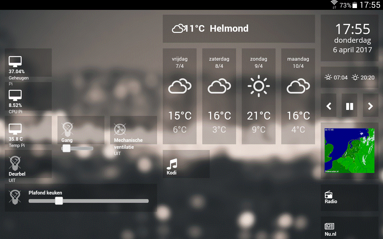

SwordFish
Posts: 278
Domoticz version: V4.11375
Re: New Dashboard Design v2, with custom positioning
Post by SwordFish »
robgeerts wrote:No, I set my port to 8080 in Kodi, so used that port in Domoticz too.
My port in domoticz is 9090 not 8080.
Is it correct that the s for scene isn't working right now? I dont get any scene to display.
This is the view on my tablet, the text is not right :mrgreen:
