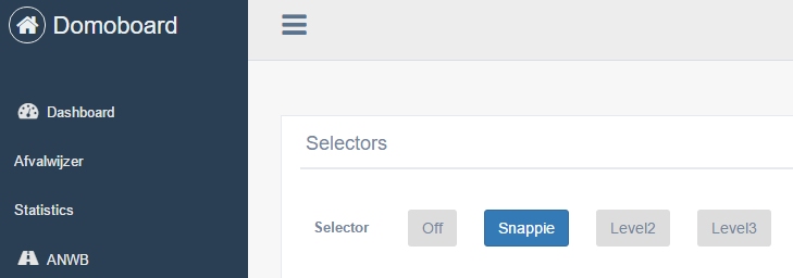

Haha yep these are the new results of this weekend. i will post some images later today with the new features.
The new features in the master are:
- The selector switch has been added.
- The setpoint-slider has been added.
- RTSP camera support, if you have an rtsp:// url in the camera section it will use the vlc plugin in the browser
- The plugin-manager has been updated.
- Now there can be plugins which only has templates in it.
Issues which are fixed:
- The top-tiles cropped issue has been fixed.
- HumbarTemp value was going outside the frame, this has been fixed to.
- The readme of plugins has been fixed.
- The code has been splitted up so that the api is more easy to use/extend for us
I hope that everything works on you're configs and i hope you guys like it :)
