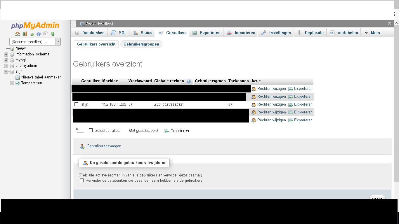

i have also added a new user in my phpmyadmin configuration as you caan see in picture attached
and it has my raspberry pi as machine configured
don't know why it's not working to access my mysql database on my nas from a 'remote' computer inside my own network
- Naamloos.jpg (151.38 KiB) Viewed 3859 times

Look at your NAS ( I have a QNAP) if "activate TCP/IP networking" is enabled with port 3306 by your SQL server settings.

Leave the machine empty/open for testing, first get it working, then secure it.

Somewhere in NAS setting like PHP Server.
MyPhpAdmin is only a tool for databases and has nothing to do with setup and accessing databases, because phpmyadmin uses localhost.

needed to find the 'configuration' file where i can comment the bind 127.0.0.1
but didn't know where to begin searching this 'configuration file' on my nas as Zyxell nas540 is sooo documented (not!)
for other people wo are also interested, it's located here:
/i-data/0e4bb2e1/.PKG/PHP-MySQL-phpMyAdmin/etc/init.d/PHP-MySQL-phpMyAdmin
and when you open this file, you will find somewhere this:
#nice -n ${NICE_VALUE} ./bin/mysqld_safe --user=mysql --bind-address=127.0.0.1 &
nice -n ${NICE_VALUE} ./bin/mysqld_safe --user=mysql &
just comment the first one and add it again and delete the --bind-address=127.0.0.1
then reboot your nas540 and all is working
