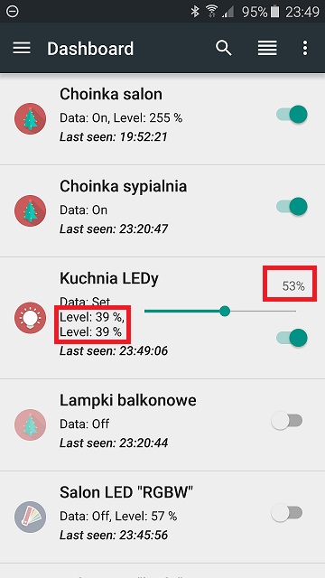

I found next bug. On my Fibaro RGBW FGRGBWM-441 when i set level i have other level above slider and other in text. It show ok after refresh app or close and opern again. And in text "level" is double see.
Next...

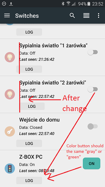

The button Log, Timer and other should be center in the same line as text. Color button should be change in the same bright GRAY or Button Green(should be more dark Green as other green slider on/off) as other...to sync.

Design should be look as:
Screenshot (31 grudnia 2015 10-21).png (151.39 KiB) Viewed 2715 times

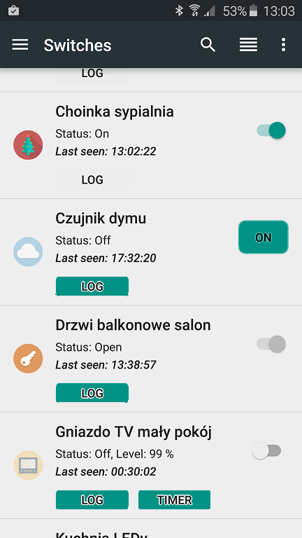

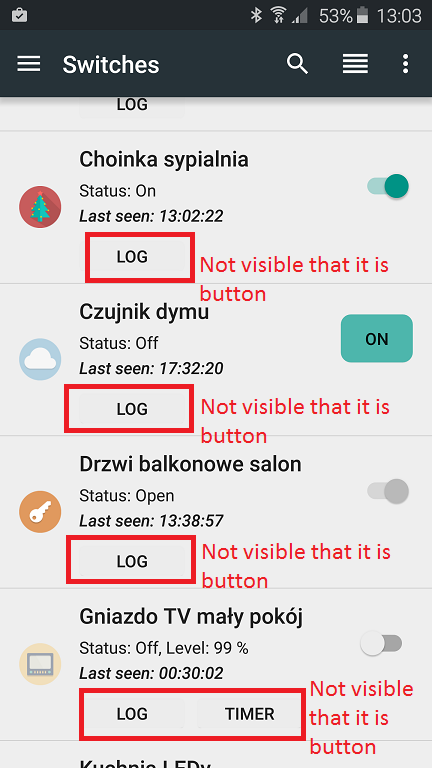

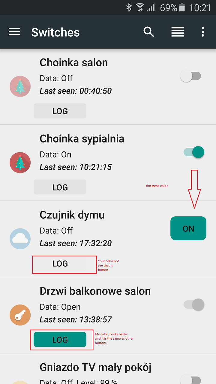

I update app to version 0.1.205 and i am sad. Color button no looks good. I saw that looks very bad. It is not visible on white background and begginer user maybe dont know that this is button.
I send to you PR on github to syncronising colors for all buttons but my PR was rejected. With my changes looks very good and better (it is only visualisation done in PAINT, with mered my PR look better):

pepeEL wrote:I update app to version 0.1.205 and i am sad. Color button no looks good. I saw that looks very bad. It is not visible on white background and begginer user maybe dont know that this is button.
Dude, not to be rude or anything, but you're spamming me whole morning with 6 pull requests, 2 github issue requests and this week 5 posts with the same button color request.
I think it's a matter of taste and I like the buttons to be lightly in the background, because they are 'extra'-features..
Not as important as flipping a switch of clicking a push-on request.
Also is this *issue* holding you back?
Is it really that important that we should drop all other cases where we're working on?

In my opinion button prevoius was better because was more dark. Now is too bright.
But button push on is also in other color than button/slider on/off. Should be in the same color.
