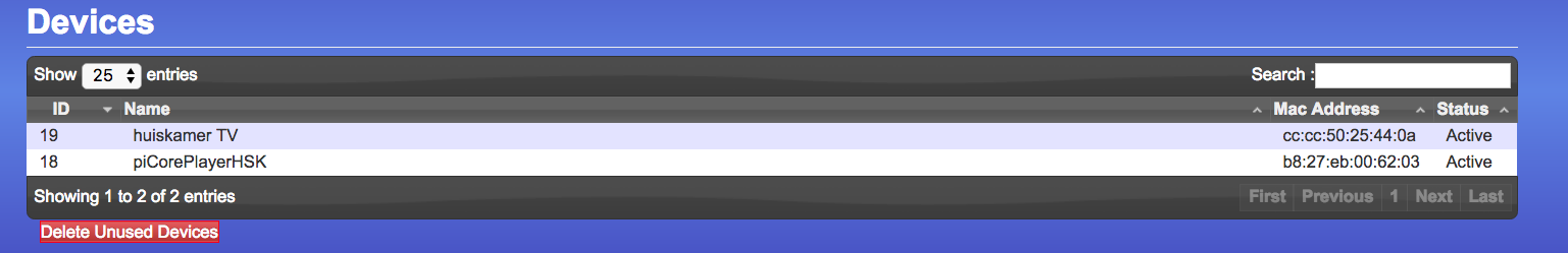

But on the hardware tab:
Screen Shot 2018-10-01 at 11.01.48.png (61.41 KiB) Viewed 3974 times
This is all.
