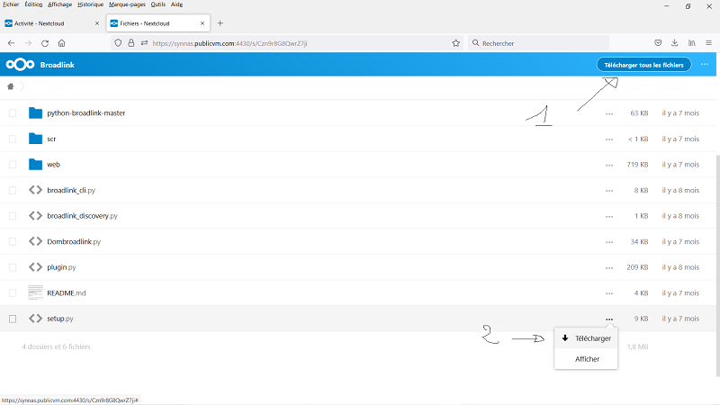

https://synnas.publicvm.com:4430/s/Czn9r8G8QwrZ7ji to download setup.py. I cannot open it, some users here neither.
Edit: Perhaps put it as a ZIP as attachment to the first post?
Re: Python Plugin : Broadlink
Posted: Thursday 02 September 2021 20:33
by zak45
waltervl wrote: Thursday 02 September 2021 15:51 https://synnas.publicvm.com:4430/s/Czn9r8G8QwrZ7ji to download setup.py. I cannot open it, some users here neither.
Thanks for the information.
Please, try this two links and provide any error: usually nextcloud manage that very well, except when my server is down for x reasons ... :)
the 1 should give you a possibility to download all files in zip format
the 2 should give you a choice depend of your os settings for py files.
