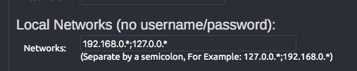

I'm still getting this error in the log file, once every session if I restart the App:
2016-01-13 12:22:50.277 Error: Failed login attempt from 127.0.0.1 for 'Bikey' !
I am using NGINX:
https SSL -> NGINX (with username/password) -> https to Domoticz with 127.0.0.1 placed in local network.

Bikey wrote:I'm still getting this error in the log file, once every session if I restart the App:
I am using NGINX:
You're setting 127.0.0.1 as your local network IP? Not sure that can work. Try setting something like 192.168.X.X instead?

Well actually I have set these ranges: 192.168.0.*;127.0.0.* in the settings in Domoticz.

Bikey wrote:Well actually I have set these ranges: 192.168.0.*;127.0.0.* in the settings in Domoticz.
127.0.0.1 is your server local address.
What you need is the local network address, which should look like 192.168.X.X :)
That's the one you should add in the local settings in Domoticz.
Maybe the labels used in Pilot are confusing at the moment, I will update them for the next version.

I mean in the network settings of Domoticz, not Pilot, so that you only need to provide a username/password to login to NGINX and not again for Domoticz if I login the Domoticz webinterface from outside my LAN:
Within Pilot I'm using the external URL of Domoticz. If I also use the local server fields, and use my internal IP-address there, I get an error in my log file for every action within Pilot. I think because Pilot tries to login but it does not need to because on the local network - even with the HTTPS connection - you don't need a username password if you excluded the internal IP-ranges as in the picture above.

Bikey wrote:I mean in the network settings of Domoticz, not Pilot, so that you only need to provide a username/password to login to NGINX and not again for Domoticz if I login the Domoticz webinterface from outside my LAN:
To add to this: In the NGINX access log I see that the first time Pilot connects, it sends this command: json.htm?type=command&param=logincheck&username=xxx&password=yyy
I think that Domoticz does not like that if the username/password is not needed. Is there a way to prevent this, still using the authentication of NGINX?
Yeah, I understand what's going on. It's pretty surprising that the request doesn't go through though. I always thought you would be able to connect if you don't authentication, even if you give it login credentials. At least that works on my server... I guess NGINX doesn't. :P
That means I need to check if the iPhone is in the local network and use the correct settings according to this.
I will try to have it fixed for the next beta version.
