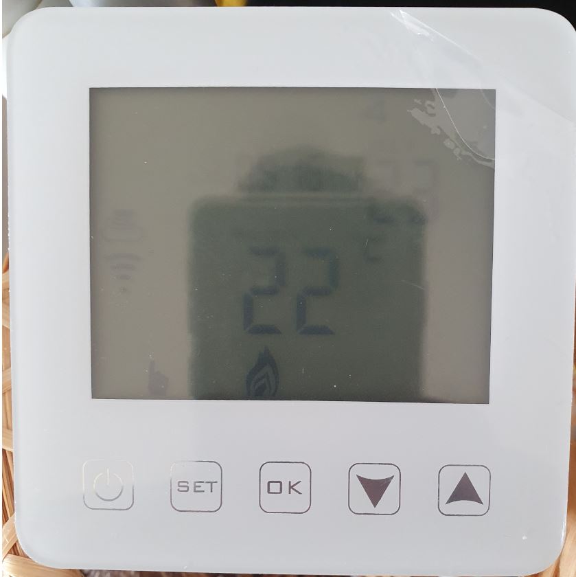

Hello, I had same issue and resolve with a new command line
pi@raspberrypi:~ $ tuya-cli link --api-key XXXXXXXXX --api-secret XXXXXXXXX --schema XXXXXXXXX --ssid XXXXXXXXX --password XXXXXXXXX --region eu
I got it a new localKey to set in Domoticz (Tuya Thermostat Hardware values) with Protocol version:3.3.
Now I can change the setpoint value with domoticz and shut on/off the thermostat but, the value of the sensors showed in Domoticz dashboard are wrong (5 times greater):
Thermo.___Domoticz
T(ºC)______ values
16---------------80
17---------------85
18---------------90
19---------------95
20--------------100
21--------------105
21.5-----------107.5
22--------------110
Thermostat (Floureon HY08WE) value:
Domoticz value:
At least I can modify temp values :)

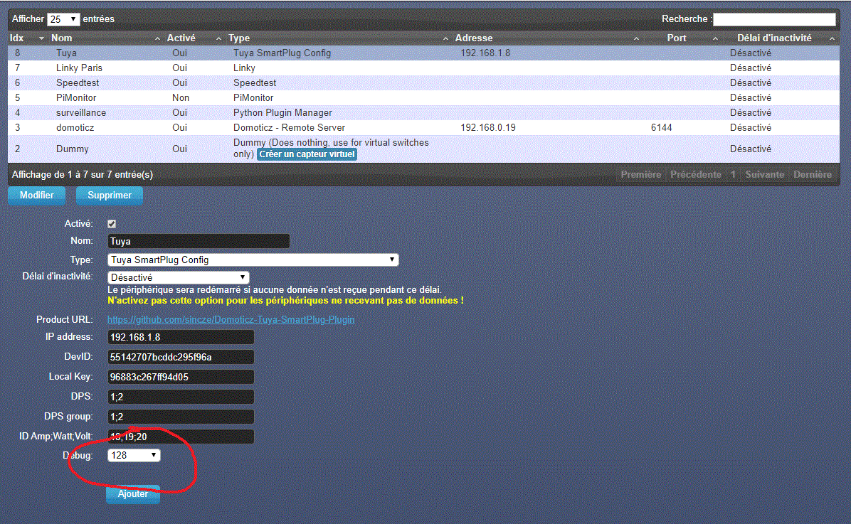

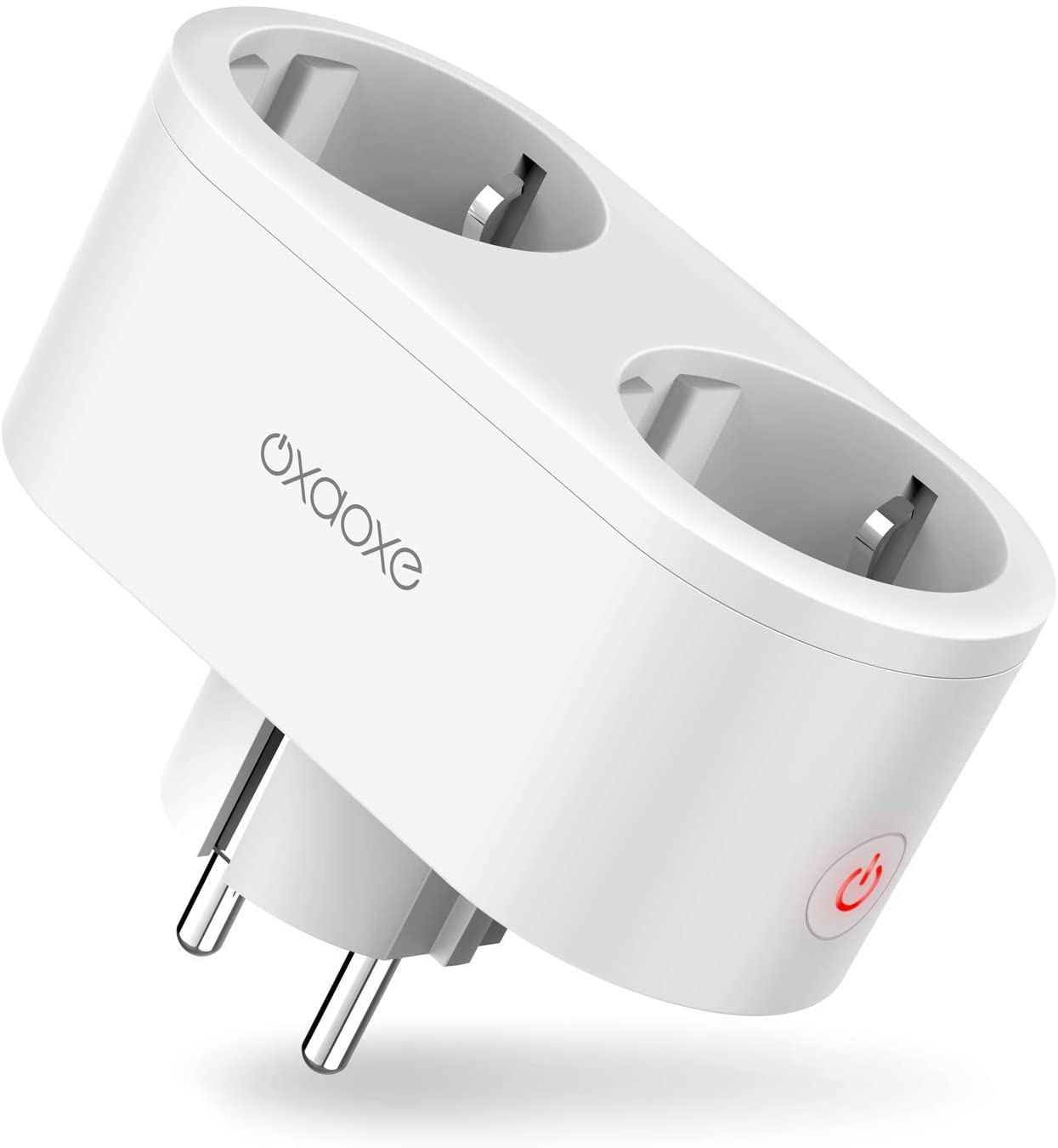

Hello
I'm using an oxaone plug which works perfectly with the plugin.
This device has 2 plugs. Every 20 seconds I receive new informations about Volt, Amp, WH.
And I receive also an updated about the status of one plug (only one).
The log is huge with this update. I'd like to know if you have the same issue.
Here is some logs
Thanks a lot
2020-03-11 18:53:18.683 (Tuya) Pushing 'onMessageCallback' on to queue
2020-03-11 18:53:18.683 (Tuya) Processing 'onMessageCallback' message
2020-03-11 18:53:18.683 (Tuya) Calling message handler 'onMessage'.
2020-03-11 18:53:18.683 (Tuya) onMessage called: 192.168.1.8:6668 b'\x00\x00U\xaa\x00\x00\x00\x00\x00\x00\x00\n\x00\x00\x00\x9d\x00\x00\x00\x00{"devId":"55142707bcddc295f96a","dps":{"1":false,"2":false,"9":0,"10":0,"18":0,"19":0,"20":2278,"21":1,"22":609,"23":27297,"24":15519,"25":1340}}\xc5_\xed\xaa\x00\x00\xaaU'
2020-03-11 18:53:18.684 (Tuya - Gauche) Updating device from 0:'Off' to have values 0:'0.0'.
2020-03-11 18:53:18.688 (Tuya - Tuya SmartPlug (A)) Updating device from 0:'0.0' to have values 0:'0.0;0'.
2020-03-11 18:53:18.691 (Tuya - Tuya SmartPlug (kWh)) Updating device from 0:'0.0;74851.7' to have values 0:'227.8'.
2020-03-11 18:53:18.694 (Tuya - Tuya SmartPlug (V)) Updating device from 0:'227.8' to have values 0:'0.0'.
2020-03-11 18:53:18.696 (Tuya) Updated: 0.0 Ampere Key is:2
2020-03-11 18:53:18.696 (Tuya) Updated: 0.0 Watt Key is:13
2020-03-11 18:53:18.697 (Tuya) Updated: 227.8 Voltage Key is:14
2020-03-11 18:53:18.697 (Tuya - Gauche) Updating device from 0:'0.0' to have values 0:'Off'.
2020-03-11 18:53:18.702 (Tuya) Update Tuya - Gauche: 0 - 'Off'
2020-03-11 18:53:18.702 (Tuya - Tuya SmartPlug (A)) Updating device from 0:'0.0;0' to have values 0:'0.0'.
2020-03-11 18:53:18.704 (Tuya - Tuya SmartPlug (kWh)) Updating device from 0:'227.8;74851.7' to have values 0:'0.0;0'.
2020-03-11 18:53:18.707 (Tuya - Tuya SmartPlug (V)) Updating device from 0:'0.0' to have values 0:'227.8'.
2020-03-11 18:53:18.709 (Tuya - Tuya SmartPlug (W)) Updating device from 0:'0.0' to have values 0:'0.0'.
2020-03-11 18:53:18.712 (Tuya) Updated: 0.0 Ampere Key is:3
2020-03-11 18:53:18.712 (Tuya) Updated: 0.0 Watt Key is:14
2020-03-11 18:53:18.712 (Tuya) Updated: 227.8 Voltage Key is:15
2020-03-11 18:53:28.440 (Tuya) Pushing 'onHeartbeatCallback' on to queue
2020-03-11 18:53:28.478 (Tuya) Processing 'onHeartbeatCallback' message
2020-03-11 18:53:28.478 (Tuya) Calling message handler 'onHeartbeat'.
2020-03-11 18:53:38.443 (Tuya) Pushing 'onHeartbeatCallback' on to queue
2020-03-11 18:53:38.444 (Tuya) Processing 'onHeartbeatCallback' message
2020-03-11 18:53:38.444 (Tuya) Calling message handler 'onHeartbeat'.
2020-03-11 18:53:38.446 (Tuya) Pushing 'WriteDirective' on to queue
2020-03-11 18:53:38.446 (Tuya) Processing 'WriteDirective' message
2020-03-11 18:53:38.446 (Tuya) Sending 86 bytes of data
2020-03-11 18:53:38.446 (Tuya) 00 00 55 aa 00 00 00 00 00 00 00 0a 00 00 00 46 7b 22 64 65 ..U�...........F{"de
2020-03-11 18:53:38.446 (Tuya) 76 49 64 22 3a 22 35 35 31 34 32 37 30 37 62 63 64 64 63 32 vId":"55142707bcddc2
2020-03-11 18:53:38.447 (Tuya) 39 35 66 39 36 61 22 2c 22 67 77 49 64 22 3a 22 35 35 31 34 95f96a","gwId":"5514
2020-03-11 18:53:38.447 (Tuya) 32 37 30 37 62 63 64 64 63 32 39 35 66 39 36 61 22 7d 49 51 2707bcddc295f96a"}IQ
2020-03-11 18:53:38.447 (Tuya) d9 16 00 00 aa 55 .. .. .. .. .. .. .. .. .. .. .. .. .. .. �...�U
2020-03-11 18:53:38.524 (Tuya) Pushing 'ReadEvent' on to queue
2020-03-11 18:53:38.547 (Tuya) Processing 'ReadEvent' message
2020-03-11 18:53:38.547 (Tuya) Received 173 bytes of data
2020-03-11 18:53:38.547 (Tuya) 00 00 55 aa 00 00 00 00 00 00 00 0a 00 00 00 9d 00 00 00 00 ..U�...........�....
2020-03-11 18:53:38.547 (Tuya) 7b 22 64 65 76 49 64 22 3a 22 35 35 31 34 32 37 30 37 62 63 {"devId":"55142707bc
2020-03-11 18:53:38.547 (Tuya) 64 64 63 32 39 35 66 39 36 61 22 2c 22 64 70 73 22 3a 7b 22 ddc295f96a","dps":{"
2020-03-11 18:53:38.547 (Tuya) 31 22 3a 66 61 6c 73 65 2c 22 32 22 3a 66 61 6c 73 65 2c 22 1":false,"2":false,"
2020-03-11 18:53:38.547 (Tuya) 39 22 3a 30 2c 22 31 30 22 3a 30 2c 22 31 38 22 3a 30 2c 22 9":0,"10":0,"18":0,"
2020-03-11 18:53:38.548 (Tuya) 31 39 22 3a 30 2c 22 32 30 22 3a 32 32 37 38 2c 22 32 31 22 19":0,"20":2278,"21"
2020-03-11 18:53:38.548 (Tuya) 3a 31 2c 22 32 32 22 3a 36 30 39 2c 22 32 33 22 3a 32 37 32 :1,"22":609,"23":272
2020-03-11 18:53:38.548 (Tuya) 39 37 2c 22 32 34 22 3a 31 35 35 31 39 2c 22 32 35 22 3a 31 97,"24":15519,"25":1
2020-03-11 18:53:38.548 (Tuya) 33 34 30 7d 7d c5 5f ed aa 00 00 aa 55 .. .. .. .. .. .. .. 340}}�_��..�U
2020-03-11 18:53:38.548 (Tuya) Pushing 'onMessageCallback' on to queue
2020-03-11 18:53:38.548 (Tuya) Processing 'onMessageCallback' message
2020-03-11 18:53:38.548 (Tuya) Calling message handler 'onMessage'.
2020-03-11 18:53:38.548 (Tuya) onMessage called: 192.168.1.8:6668 b'\x00\x00U\xaa\x00\x00\x00\x00\x00\x00\x00\n\x00\x00\x00\x9d\x00\x00\x00\x00{"devId":"55142707bcddc295f96a","dps":{"1":false,"2":false,"9":0,"10":0,"18":0,"19":0,"20":2278,"21":1,"22":609,"23":27297,"24":15519,"25":1340}}\xc5_\xed\xaa\x00\x00\xaaU'
2020-03-11 18:53:38.549 (Tuya - Gauche) Updating device from 0:'Off' to have values 0:'0.0'.
2020-03-11 18:53:38.553 (Tuya - Tuya SmartPlug (A)) Updating device from 0:'0.0' to have values 0:'0.0;0'.
2020-03-11 18:53:38.555 (Tuya - Tuya SmartPlug (kWh)) Updating device from 0:'0.0;74851.7' to have values 0:'227.8'.
2020-03-11 18:53:38.558 (Tuya - Tuya SmartPlug (V)) Updating device from 0:'227.8' to have values 0:'0.0'.
2020-03-11 18:53:38.560 (Tuya) Updated: 0.0 Ampere Key is:2
2020-03-11 18:53:38.561 (Tuya) Updated: 0.0 Watt Key is:13
2020-03-11 18:53:38.561 (Tuya) Updated: 227.8 Voltage Key is:14
2020-03-11 18:53:38.561 (Tuya - Gauche) Updating device from 0:'0.0' to have values 0:'Off'.
2020-03-11 18:53:38.565 (Tuya) Update Tuya - Gauche: 0 - 'Off'
2020-03-11 18:53:38.565 (Tuya - Tuya SmartPlug (A)) Updating device from 0:'0.0;0' to have values 0:'0.0'.
2020-03-11 18:53:38.568 (Tuya - Tuya SmartPlug (kWh)) Updating device from 0:'227.8;74851.7' to have values 0:'0.0;0'.
2020-03-11 18:53:38.570 (Tuya - Tuya SmartPlug (V)) Updating device from 0:'0.0' to have values 0:'227.8'.
2020-03-11 18:53:38.572 (Tuya - Tuya SmartPlug (W)) Updating device from 0:'0.0' to have values 0:'0.0'.
2020-03-11 18:53:38.575 (Tuya) Updated: 0.0 Ampere Key is:3
2020-03-11 18:53:38.575 (Tuya) Updated: 0.0 Watt Key is:14
2020-03-11 18:53:38.575 (Tuya) Updated: 227.8 Voltage Key is:15
2020-03-11 18:53:48.448 (Tuya) Pushing 'onHeartbeatCallback' on to queue
2020-03-11 18:53:48.490 (Tuya) Processing 'onHeartbeatCallback' message

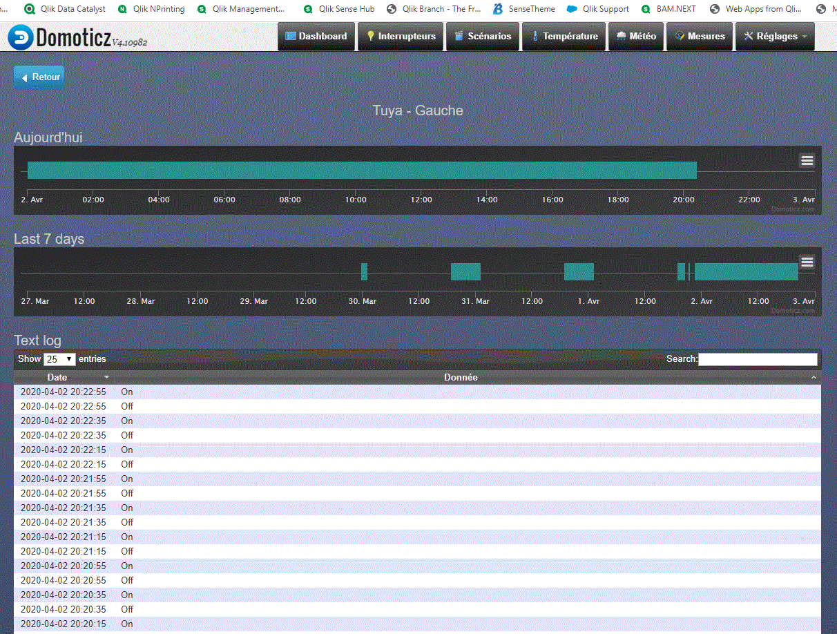

Here is some logs
Do you have DEBUG enabled on the plugin?
RasPi, Raspbian , Domoticz v2021.1, Z-Wave Stick, RFLink, RFXtrx433e, Hue, Tuya (Tasmota/Mosquitto with Discovery), ESP(easy), MySensors.org, OTGW

Nope, your previous message did not mention DEBUG at all... But when you enable debug, you get huge logs...

I am very sorry but I don't know how to set DEBUG mode.
What I did is to setup debug in the pluggin

That means DEBUG is enabled... If you do not want all the detailed logging, turn it back down to 0.

Thanks for you time and sorry again I try to explain again my issue.
As you can see in the log the device is updated every 20 seconds. And the log also
Here is some logs

That's a repeat of the original question.
Let's try to get some more details clarified...
Is this new, or did this work before?
Can you control both switches correctly through Domoticz?
If so, does anything change in the output for 1/2?
Do you intend to use both sockets as a single combined switch, or do you want to control them separately? In the latter case, you will need to remove the "DPS group" entry. In the former case, you should actually only see one switch update, because 1 & 2 are combined in to a group, and thus a single logical switch in Domoticz.
The frequency of updating seems to be determined by the plug sending updates every 20 seconds, and I do not know whether there is anything you can do about that...
If someone wants to go in to modify the code so it doesn't update it when it hasn't changed, that would definitely clean up the logs, but otherwise I do not think there is much we can do...
