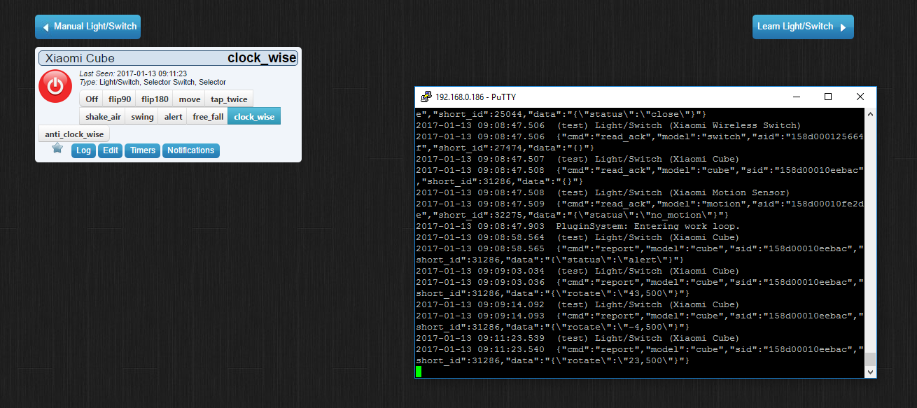

Solve, made change on your Githubdeennoo wrote:Just test "rotate", fonction are created on cube selector switch but they aren't linked to the gateway message. other fonction are okcorbin wrote:Try https://github.com/corbinmunce/domoticz for the rotate command handling - I haven't changed the on/off status part, you can easily adjust the source though.deennoo wrote: Maybe disable auto off for cube and round switch, a switch never turn off it just state change (clik, long clik etc) same for cube each mouvement is a new one

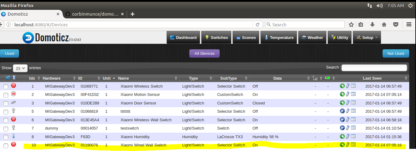

got the Aqara Electirc switch now connected, im using the 2 buttons version.
here full logs from its functionality:
for some reason the commands sends twice, from anywhere this is triggerws (buttons or from the miHome APP)
@corbin, @deennoo,
how do you think this can be added? Selector doesnt seems to fit in here, these are 2 on/off buttons for the same device.
2017-01-14 00:56:29.530 XiaomiGateway: unhandled model: ctrl_neutral2
2017-01-14 00:56:29.530 {"cmd":"report","model":"ctrl_neutral2","sid":"158d0001190076","short_id":27074,"data":"{\"channel_0\":\"on\"}"}
2017-01-14 00:56:29.553 XiaomiGateway: unhandled model: ctrl_neutral2
2017-01-14 00:56:29.553 {"cmd":"report","model":"ctrl_neutral2","sid":"158d0001190076","short_id":27074,"data":"{\"channel_0\":\"on\"}"}
2017-01-14 00:56:38.371 XiaomiGateway: unhandled model: ctrl_neutral2
2017-01-14 00:56:38.371 {"cmd":"report","model":"ctrl_neutral2","sid":"158d0001190076","short_id":27074,"data":"{\"channel_0\":\"off\"}"}
2017-01-14 00:56:38.395 XiaomiGateway: unhandled model: ctrl_neutral2
2017-01-14 00:56:38.395 {"cmd":"report","model":"ctrl_neutral2","sid":"158d0001190076","short_id":27074,"data":"{\"channel_0\":\"off\"}"}
2017-01-14 00:56:46.325 XiaomiGateway: unhandled model: ctrl_neutral2
2017-01-14 00:56:46.325 {"cmd":"report","model":"ctrl_neutral2","sid":"158d0001190076","short_id":27074,"data":"{\"channel_1\":\"on\"}"}
2017-01-14 00:56:46.347 XiaomiGateway: unhandled model: ctrl_neutral2
2017-01-14 00:56:46.347 {"cmd":"report","model":"ctrl_neutral2","sid":"158d0001190076","short_id":27074,"data":"{\"channel_1\":\"on\"}"}
2017-01-14 00:56:51.736 XiaomiGateway: unhandled model: ctrl_neutral2
2017-01-14 00:56:51.736 {"cmd":"report","model":"ctrl_neutral2","sid":"158d0001190076","short_id":27074,"data":"{\"channel_1\":\"off\"}"}
2017-01-14 00:56:51.758 XiaomiGateway: unhandled model: ctrl_neutral2
2017-01-14 00:56:51.758 {"cmd":"report","model":"ctrl_neutral2","sid":"158d0001190076","short_id":27074,"data":"{\"channel_1\":\"off\"}"}

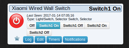

levynger
- Posts: 87
- Joined: Wednesday 21 December 2016 19:03
- Location: Israel
thanks @deenno,deennoo wrote:Following the api :
https://github.com/louisZL/lumi-gateway ... eutral2.md
This have to be our bible.
A simple on/off for each channel
i was able to add it into domoticz, using selector switch, however i think its better to have 2 on/off,
i just not sure how to create from the same device for 2 distinct switches.
i assume it has something to do with the "Unit" index in devices, as domoticz wont allow to add the same device to different switches, isnt it?
- selector.PNG (32.14 KiB) Viewed 3124 times
- devices.PNG (142.19 KiB) Viewed 3124 times

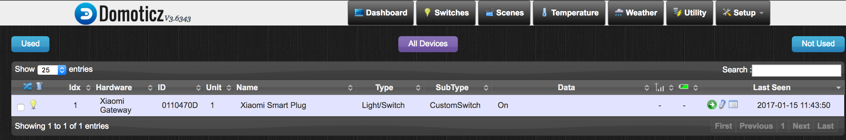

I am using Version: 3.6363
UPDATE:
My Mi Smart Plug is only showing "On" and i don't see an option to turn it off or to see how much power it is consuming. Is this supported in current beta release?
