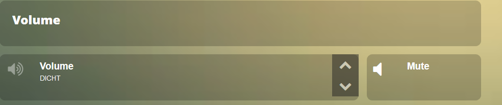

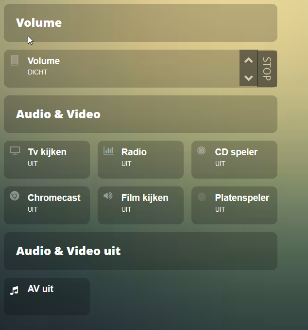

I recently added IR volume control of my Amplifier to Domoticz (Logitech Harmony -> HaBridge -> Domoticz) and as a switch I use a Blindswitch to control the volume.
My amplifier is has an analog volume control and I can only set the volume up and down, not to a specific volume percentage.
In Dashticz I like to have a block with just two buttons and an icon: up and down.
Because I use the Blinds in Domoticz this is also used in Dashticz.
Can somebody help me with finding a general way to create a "Volume" block? so I can keep using the standard Dashticz library when therre are updates?
This is how it looks now:
2018-02-05 15_57_14-Woonkamer.png (128.12 KiB) Viewed 4402 times
Posted: Monday 05 February 2018 21:47
by htilburgs
Add this:
blocks[x]['hide_stop'] = true;
blocks[x]['hide_data'] = true;
Only the Icon cannot be changed anymore. I see it's hard coded. This wasnt' so in the previous version.

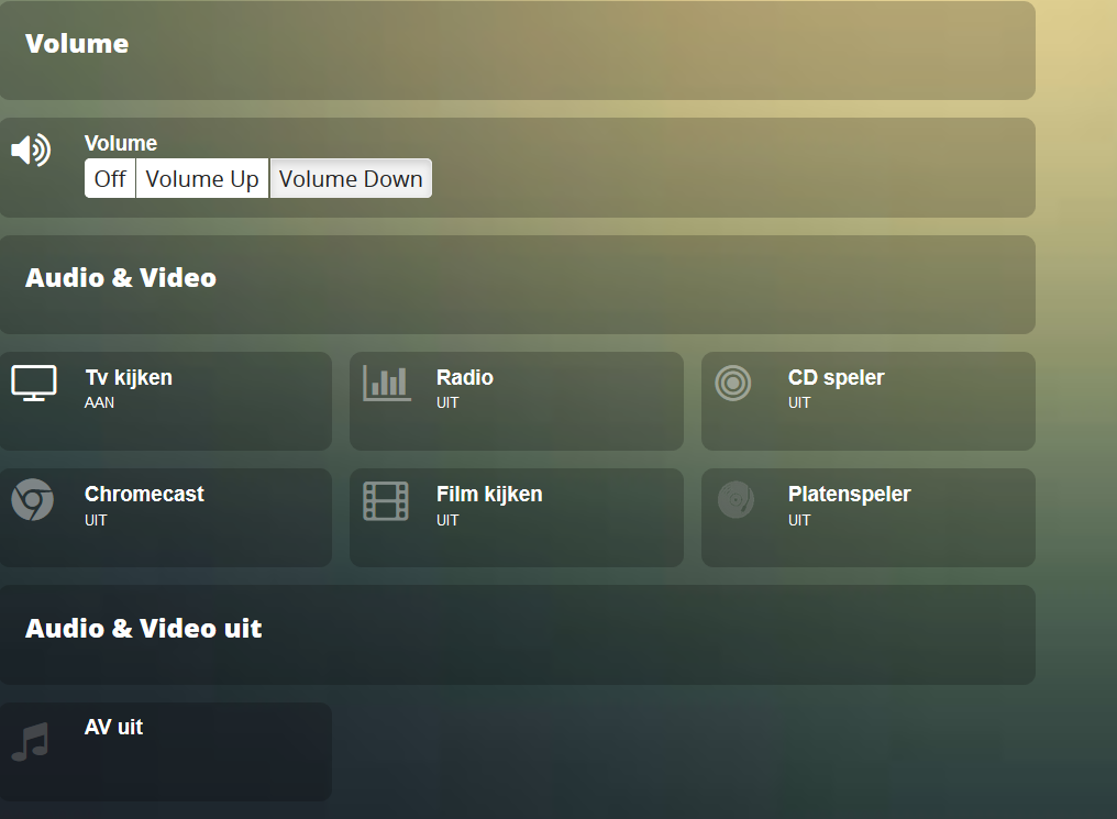

Posted: Monday 05 February 2018 22:22
by Stephan83
Thanks for the replies!
I also found out that the blinds icon is hard coded in the main.js.
The solution I figured out now is to create a virtual device in Domoticz that is a selector switch.
This gives me an other "unwanted" button: Off.
2018-02-05 22_21_04-Woonkamer.png (197.66 KiB) Viewed 4362 times
The off button is now mute.
