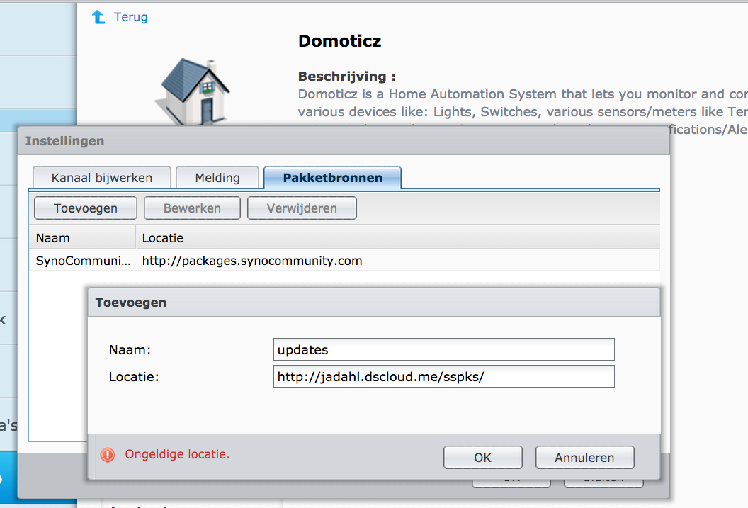

Hi, I've got a Synology DS212+ NAS.
I am working to get Domoticz installed on my NAS.
When trying to add a source like "Domoticz Updates" as mentioned before into SETTINGS, as mentioned by Post "by peerv » Sunday 28 June 2015 14:30" I get a reply like: "Invalid location".
Schermafbeelding 2015-07-12 om 11.00.07.png (134.97 KiB) Viewed 9642 times
How can I proceed with the proper installation of Domotocz at my NAS?
I was however able to add the sourse: "http://packages.synocommunity.com/", so that worked well.
Also the 212+ NAS model nr seems to be missing from the DSM6.2 stable list of JADAHL at "http://www.jadahl.com/domoticz_stable_6.2/".
Does this mean I have to use the DSM5.2 version or is there another way around this?
Thx a lot for any assistance I can get.
Antoine
jumbotroll
Posts: 793
Joined: Tuesday 13 January 2015 14:36
Location: Oslo,Norway
Re: How to install Domoticz on a Synology NAS
Post by jumbotroll »
Tonio1968 wrote: Monday 27 August 2018 1:18 Also the 212+ NAS model nr seems to be missing from the DSM6.2 stable list of JADAHL at "http://www.jadahl.com/domoticz_stable_6.2/".
Antoine
DS212+ use Marvell Kirkwood 88F6282 and use very old gcc version and old toolchain from synology.
I have stopped building new domoticz version for Marvell Kirkwood 88F6282.
The latest build for DS212+ (DSM6.2) is domoticz_88f6282-6.2_3.0.9483-7.spk
Download here: http://www.jadahl.com/domoticz_beta_6.2 ... 9483-7.spk
If you like the work I do for synology and domoticz, I appreciate a donation.
https://paypal.me/Jumbotroll
Jumbotroll
Tonio1968
Joined: Monday 27 August 2018 1:01
Location: Haarlemmermeer
Post by Tonio1968 »
Many thanks Jumbotroll,
I installed the file and the program runs perfectly on the DS212~NAS.
Tomorrow hopefully the interface cable will arrive and I will restart the same.
Cheers :D

jumbotroll wrote: Friday 03 August 2018 23:59
jumbotroll wrote: Friday 03 August 2018 23:04
MechWarrior wrote: Friday 03 August 2018 22:30 Hi Jadahl,
I used your package on my DS1815+ and it served me well.
Upgraded to a DS1618+ now and can't seem to find a suitable package to download/install.
Can you point me in the right direction?
Thx in advance! ;)
I have not build domoticz package for DSM6.2 (DS1618+) arch-denverton yet, but I can build a test package for you.
domoticz_denverton-6.2_4.0.9796-7.spk
Try this and give me feedback: http://www.jadahl.com/domoticz_beta_6.2 ... 9796-7.spk
This link is broken for domoticz_denverton-6.2_4.0.9796-7.spk. Jumbotroll could you please make that available again? I'd like to try this on my DS1618+.
Many thanks!
