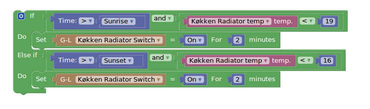

Bacinatorz,
You can solve this by adding a variable that changes state when the script runs. This way the script only triggers your Ledstrip once.
Here's an example:
https://postimg.org/image/k0dead18r/
Re: Blockly examples
Posted: Thursday 20 October 2016 18:14
by bacinatorz
BartdaMan wrote:Bacinatorz,
Here's an example:
Thnx for your clear screenshot, I have done this and now it works!

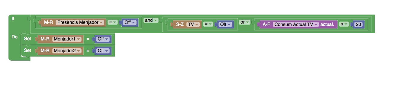

by delfisastre
:oops: I need your help!
I don't know why is not working.
I have a motion sensor in the room, and I want to swicht off the light if the sensor detects no mottion. But the problem is, If I'm wathcing the TV, sometimes, the lights turn off, because the sensor don't detects motion. And put in a blockly. If detects no motion, but the TV is ON. Don't turn off the lights. But! the TV only is OFF is it's completly stops. (no with stantd by) and I put in the blockly if the electrical consumption to the TV is less than 20w ant no detects motion. Turn off the lights... But is not working. :-(
Presencia Menjador = Motion Sensor
Tv = TV
Consum Actual TV = actual electrical consumption TV
Mnejador1 = Light 1
Menjador 2= Light 2
Posted: Monday 07 November 2016 0:41
by Derik
looks the actual i not working?
Strange perhaps some that make the blockley can fix this..[ gizmocuz not i believe ]
Posted: Monday 07 November 2016 21:09
by delfisastre
I don't know why.... but now it's working!!! maybe is the cache of the browser... I don't know. But works perfectly. Thanks for your help!

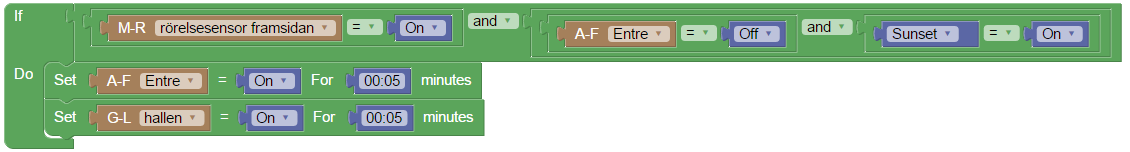

by ztocken
I could use some help with my blockly event.
my devices:
rörelsesensor framsidan = motion sensor outside front of house
Entre = porch lamp
hallen = lamp hallway inside of house.
what i want to do:
if its dark outside i want the porch lamp (Entre) and the hallway lamp (hallen) to turn on for 5 minutes if there is movement outside.
But only if the porch lamp is not already on.
what happends is i get this error:
2016-11-07 21:51:29.319 Error: EventSystem: Lua script error (Blockly), Name: auto lampa framsida_1 => [string "result = 0; weekday = os.date('*t')['wday']; ..."]:1: ')' expected near 'comparevariable'
Anyone have a suggestion? :)

by geezerrr
ztocken wrote:I could use some help with my blockly event.
my devices:
Entre = porch lamp
what i want to do:
[Sunset = on] isn't a correct statement.
Maybe you can change it in [time >= sunset]
Posted: Tuesday 08 November 2016 7:20
by StanHD
Also that's the wrong block for minutes. Try using the number block not a time block.
Posted: Wednesday 09 November 2016 21:30
by bjacobse
Ztocken,
This blockly is working with sunset and minutes, use as guide/inspiration

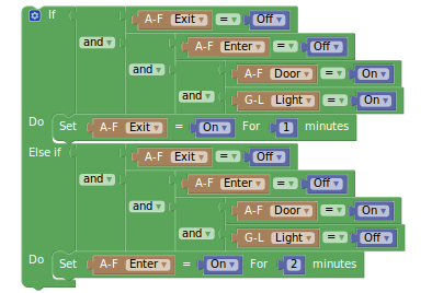

Posted: Monday 14 November 2016 17:06
by sailmich
@bonterra I tried with success what you want to do. See attachment.
Problem with that is if you changed your mind, for example you have forgotten something inside and you are open the door inside the 120 seconds, you will start the 5 minutes. At least in my opinion you need a PIR sensor inside your room to make the system running perfect.
Posted: Tuesday 15 November 2016 22:13
by sailmich
@four2six, virtual switches are fantastic. I tried as you wrote in one block but it doesn't work. With three it works. :D
Bildschirmfoto vom 2016-11-15 21-50-44.png (13.24 KiB) Viewed 3838 times
Bildschirmfoto vom 2016-11-15 21-51-01.png (12.97 KiB) Viewed 3838 times
I should more often create virtual switches 8-)
regards
