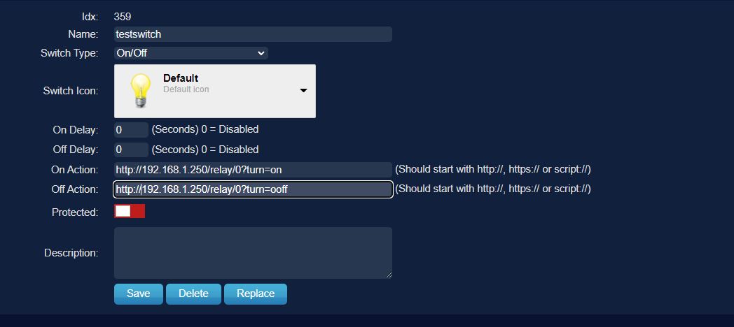

Hello
Ho do i to send messages MQTT with sensor ON/OFF by Domoticz?
I Try with this script "script://python/mqttpub.py shellies/Shelly25_Bureau/relay/0 on"
with this script here
https://blogwifi.fr/brouillon-auto/
On log I read feedback of sensor, so I understand that MQTT is OK.
With MQTT Explorer, I read my Shelly sensor and when I test with Publish it's OK, relay 0 swith ON to OFF and OFF to ON but my sensor made nothink
By 192.168.0.xxx of my sensor, ON/OFF is OK, I here my Shelly to change
CL.
CL.

Re: Python Plugin: Shelly MQTT
i think you are trying to do something which is not logical.
if you install the shelly MQTT plugin it will recognize the shelly 2.5 and will create switches in domoticz for it.
to control it just flip the switch in domoticz and it will send out the appropriate MQTT conmmands.
if you do not have/want the shelly plugin but you want to control the shelly with dummy switches in domoticz it is easier to use HTTP
just use the correct ip addres from the shelly 2.5 and you are good to go

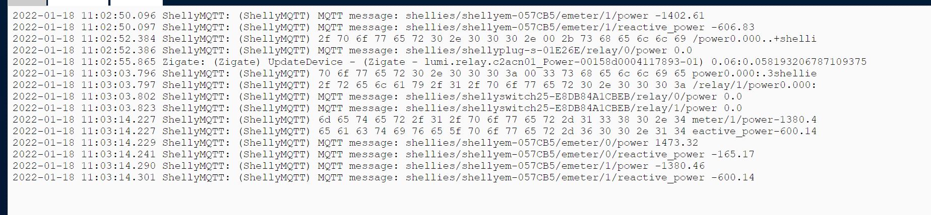

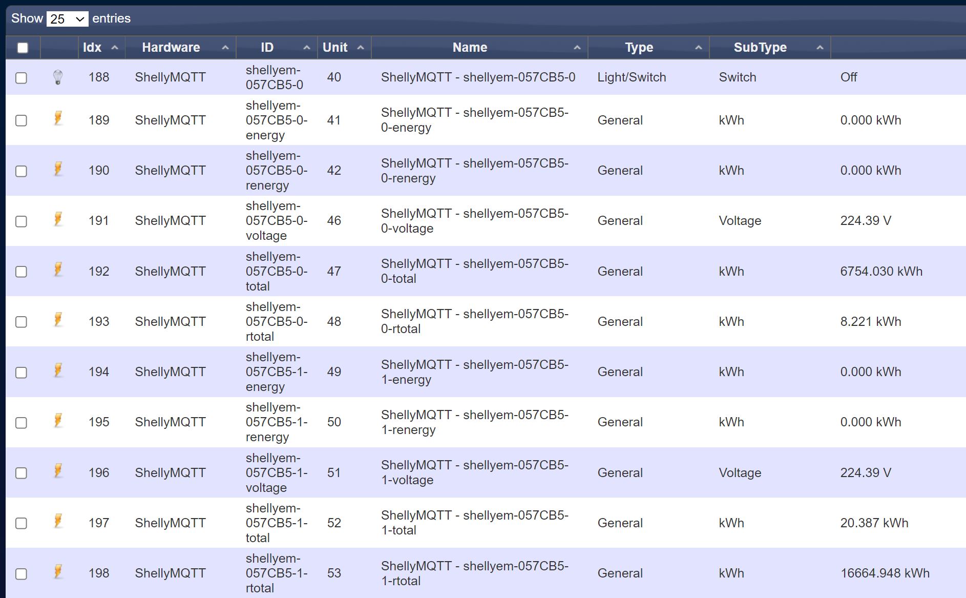

Hello, i have a Shelly EM - Shelly MQTT working for all my other shellies and also reading energies and voltages auto creating the devices on Domoticz.
But the power messages are not creating any devices .
as per Faq i did :
-enable "Accept new hardware devices" in Domoticz settings
-DISABLE "Use custom MQTT prefix" at the Shelly device options
-enable "I am accepting that Power reading may be inaccurate and is totally unsupported, just enable it!" setting at Shelly_MQTT settings page
also erased al the Shelly EM devices but the autodiscover keeps on ignoring the power reading
why are your reading negative?
maybe this is causing the problem
mine shows this
MQTT message: shellies/shelly1pm-98CDAC2FDC0E/relay/0/power 6.59
mine shows this
Clamps inverted, now values are positive but the plugin keeps on ignoring the two messagesGravityz wrote: Tuesday 18 January 2022 11:27 whay are your reading negative?
shellies/shellyem-057CB5/emeter/1/power
shellies/shellyem-057CB5/emeter/0/power
and no device created for instant power in watts
Pizigate Plugin version: 5.1.017

with my shelly 1pm it only created an energy device, no power device so maybe it is a flaw of the plugin
no big deal for me because the instant power is visible on the kWh meter
indeed if you need power graphics you need the device
